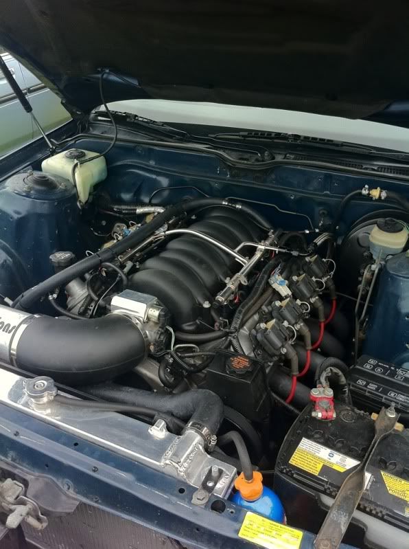

I see a lot of people using cans and waterbottles and such for overflow and and catch cans.
ls3 cressida with nos energy overflow.
