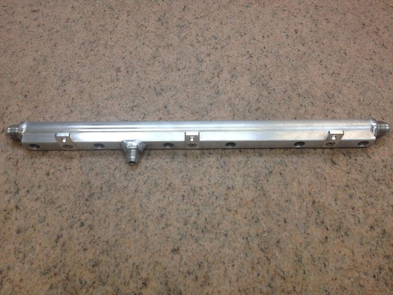

Hey guys I made this rail for Stevens 7m last weekend and posted on FB with some interest. So ill post it here to see who all would be interested in one. Price would be along the same as being able to get a JZ one.
As you can see this is a -10 feed extrusion. I milled the -8return between number 4 and 5 cylinders.
I can make the same with -6 rails or -8 rails
The feed and return on this rail isn't tapped because he plans on running weld on fittings.
Normally a -6 return would be milled and tapped for a -6 fitting.

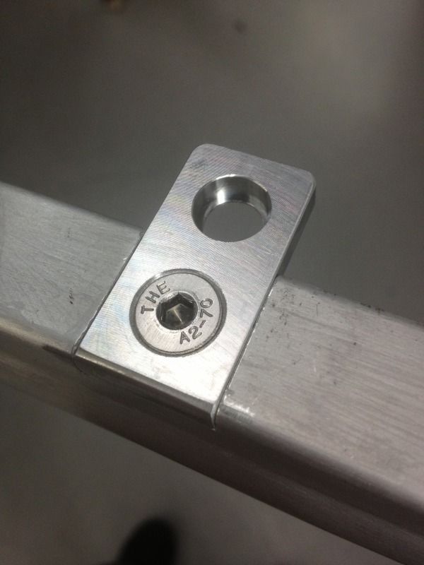

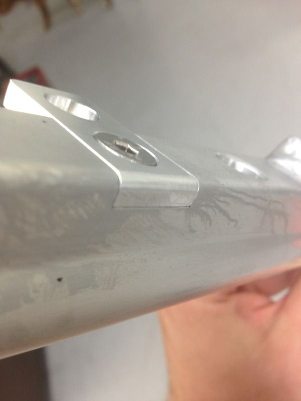

The rail is slotted exactly where the stock rail has the mounting tabs protruding from the rail. Mine rail will consist of tabs that will clip in so the rail will bolt on like oem.

The feeds are located on both ends of the rails just like a JZ
The return is between number 4 and 5 underneath the rail.
If you're on stock alternator location, all you would have tondo is plug the front. Run the feed in the back and run the return like normal.
This rail just will have the ability to run dual feeds.

Mounting tabs done:

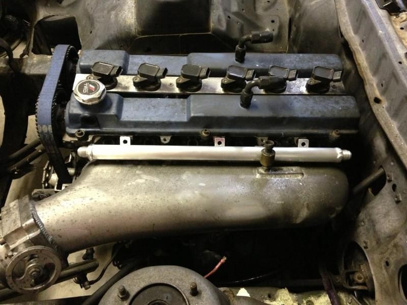

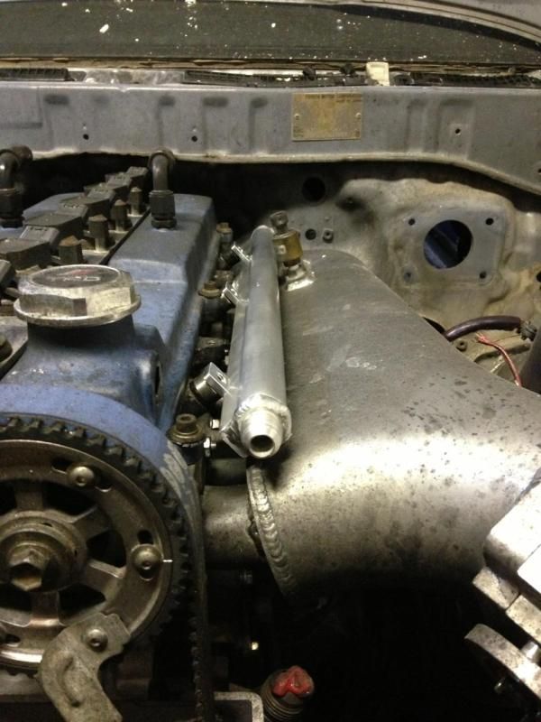

Installed on the 7m:
