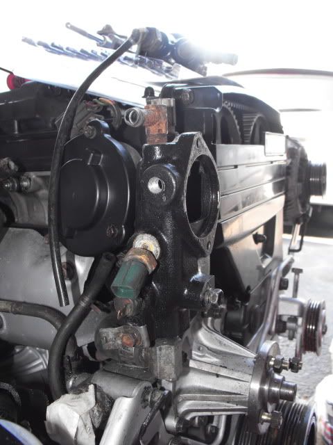

I will be installing my gauges this week and was wondering where you guys put your sensors.
Where to put the Oil pressure sensor? I would like to use the stock location on my 1JZ if I can use it and if I can get to it? Anyone use this location when the engine was still in the car?
Water temp sensor, same idea.
Fuel pressure I think I can handle unless someone has any cool tricks.

Not a 1J, but I located mine on the water neck behind the thermostat.
I used this thread as a reference.
Hope that helps.
