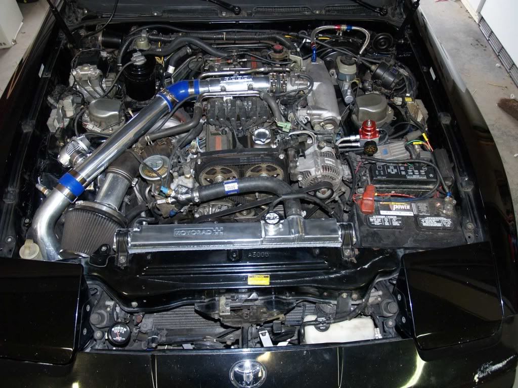

You can run the Maft Pro in AFC Mode. This will allow you to keep everything stock and in a basic sense, still tune the car. I ran it this way for around 4 months while I was waiting on my IC Pipe to get welded up. It really made the car peppy. At 11 psi, I was able to beat a semi-built DSM running 17psi. Not a lot of tuning required for AFC Mode.
Converting to Speed Density (SD) requires the ability to mount an AIT sensor. That's really the only "mod" that you'd have to do. Some folks mount it in the 3k pipe; but, it gets heat soaked there. The farther away from heat the better. Notice in my pic below that it's mounted in the lower left corner by the blue coupler. SD REALLY wakes the car up. A LOT more tunability and overall control of the tune. Almost to an overwhelming level. A lot of tuning required for SD mode.
I'm an electronics technician so install was a breeze. The instructions a pretty well written so even a novice can get it done.
Running in either mode requires a wideband. Wideband first. Then tune.

89supra7mgte;1437428 said:
what mods are necessary on the intake system for this? i can access the map and iat pretty easily, then would need to buy the electronics. how eay are these systems to install? and is there a base setting? would something like that be compatible with stock injectors, turbo and so on until further upgraded?
If your just trying to get rid of the stock AFM because of "how it looks"
1. MAFT basic....still uses a MAF but can be installed anywhere in your piping so it can be out of sight. some tuning range. fairly inexpensive. turn the dial to change injector size.
2. HKS VPC.... older unit but still used today, replaces the AFM with a IAT and a MAP sensor, has a little bit of a tuning range. Change ROM chips to change injector size.
3. MAFT Pro..... the best bang for the buck, speed density, about as far as you can go with a piggyback. There is a lot of info on this...
4. standalone.... more expensive, many capabilities, professional tune is required.

That is very helpful that engine bay is damn clean might i add. I am more knowledgeable of old mechanical engines (carburetor v-8) So all the electronic tuning is out of my realm so i am learning. AFC= air flow controller or converter? I see them alot on the net, hks or apexi, are those other controllers after you have done away with AFM(bold so that we are still on topic. lol) Or can they be run with it?
