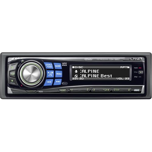

Alpine CDA9857 50W x 4 CD/CD-R/CD-RW/MP3/WMA iPod/Satellite Radio-Ready/HD Radio-Ready In-Dash Receiver
I bought mine on e-bay. The ipod cable is sold seperate and I bought that at tweeter. I ran the wire where the shifteris and brought it out by the e-brake and the put it up into the center console. I was happy with it. If you put the ipod on hsuffle and then plug it in, it keeps it on shuffle through the head unit and tells you what song it is...
