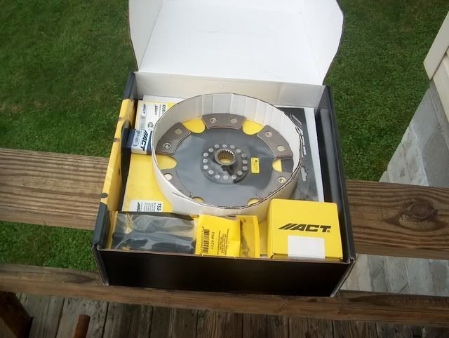

I bought act extreme from speed solution for $551 shipped, Heres a pic.
I sold it and got something else .
