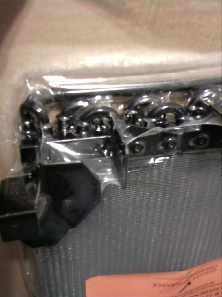

Is that a stocker?
Mine that I had sourced doesn't look like that...
EDIT: Pic, and it's still vacuum packed and will stay that way until it's installed.

Not sure on my car as it's windy and cold and I don't wanna go look :rofl: I bet it's the same and my compressor probably failed so I wasn't going to jack with trying to clean it out. Got the seals to rebuild my spare compressor, both soft lines, and expansion valve (wanted to make sure as the pressures I was seeing were abnormal before it failed).
The flange where the pipe mounts isn't as nice looking on this but hopefully it works as well or better, looks to have a LOT more fins.
