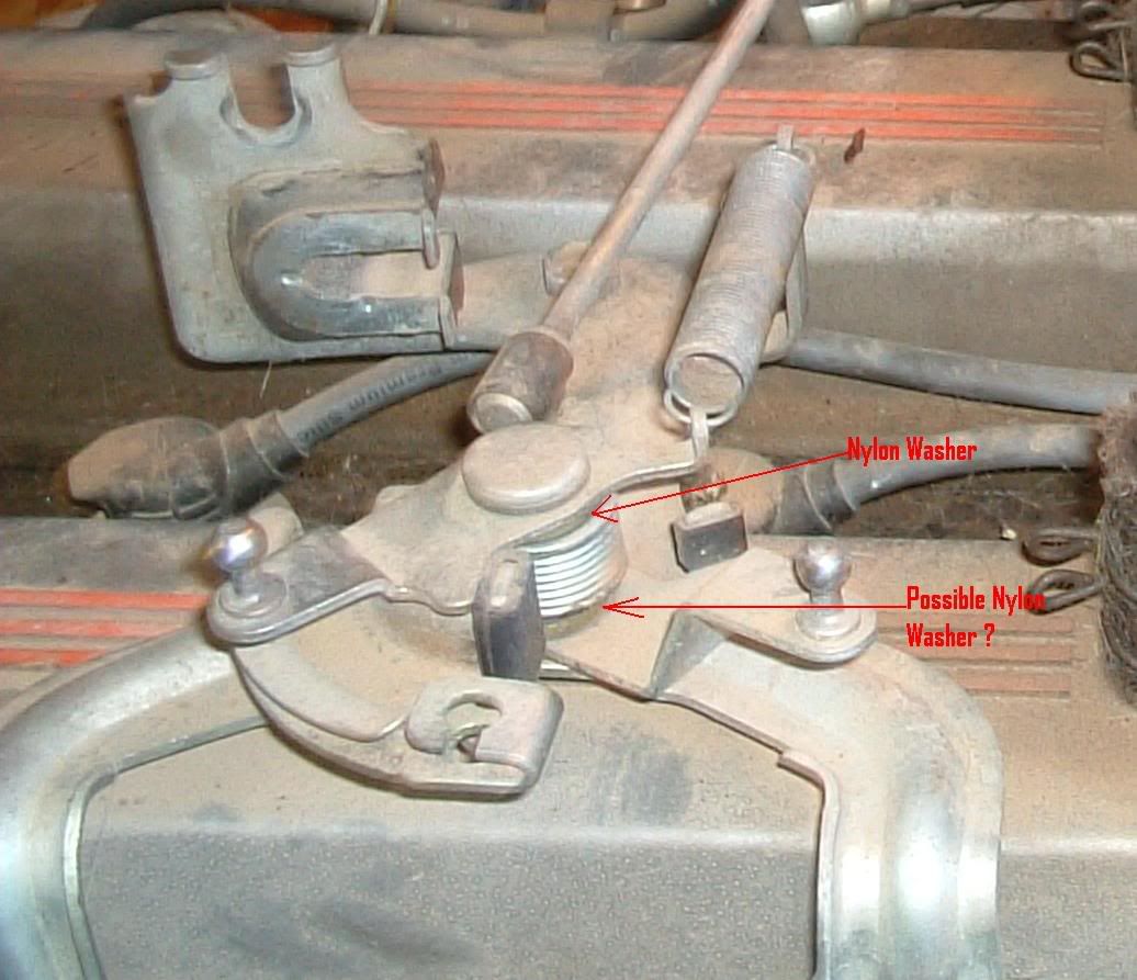

Mine had some slop in it, even after tightening it to maximum. And then after awhile it started sticking. I found by looking at someone else’s linkage that mine had lost a nylon washer. And that was what was causing the play. The washer was located in between the upper and lower arms for the throttle and the cruise control.
same here.... my lower arm (where the end of the throttle link is attached) has MUCH freeplay, in turn causing freeplay in the pedal.

Yeah, they give specs for the transmission kick down cable. But other than that there is nothing. Sad but true. Like stated above. See if your missing a white nylon washer, or if you have one but it is severely worn down.

Currently my supra is a state away in Colorado so if someone can run out to their supra and confirm this, I would appreciate it. If I remember correctly there are two nylon washers in the locations listed in the pic below. While the pic isn't great it's the best I have.
