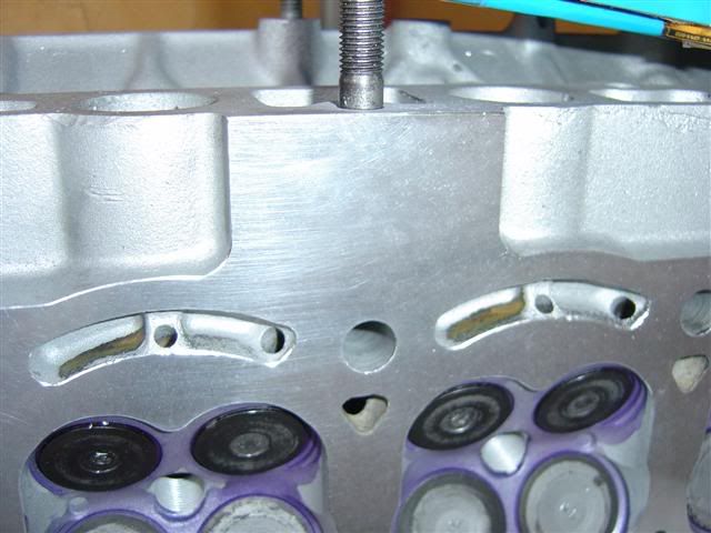

Otherwise as far as the engine is concerned, head is stock with nice rebuild and I got Ross pistons with stock rods. Everything was fully balanced and blueprinted. ARP everything too. The goal is good useable horsepower at medium boost for the street. I am not going to push it to the limit on the dyno. These were my build pics from a while back so you can see what went into the engine. I have about 20k miles on it now.
