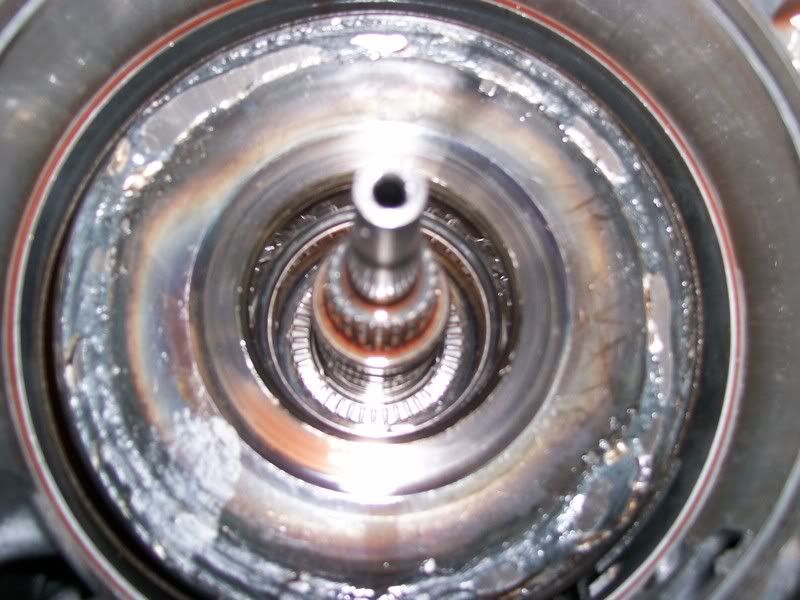

well one of the local guys auto took a dump on him. long story short i pulled the tranny apart for fun and saw an old failure that was "fixed".
not sure how it happend but since you want to see failure parts.
iirc it was the front driving shell that was cracked most of the way around.
his car was near stock when he got it(89t) so dont have a clue how it happend. neutral bombing it:dunno:

Wow, nice "fix." The A340 series transmission is used in a few different Toyota vehicles. Parts shouldn't be to difficult to find for a trans. shop.
