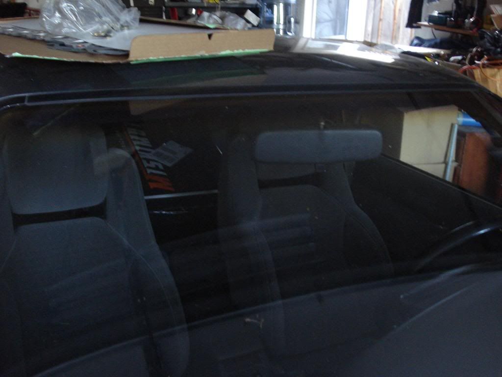

-remove walmart do-it-urself tint off hatch

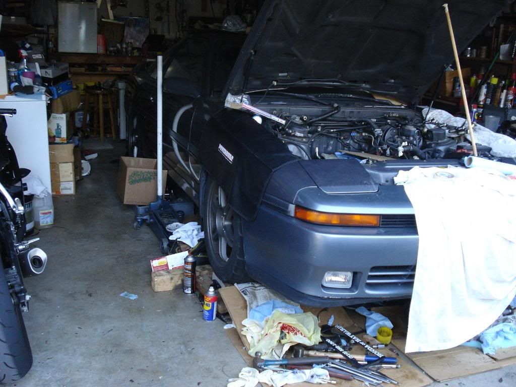

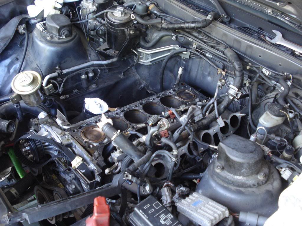

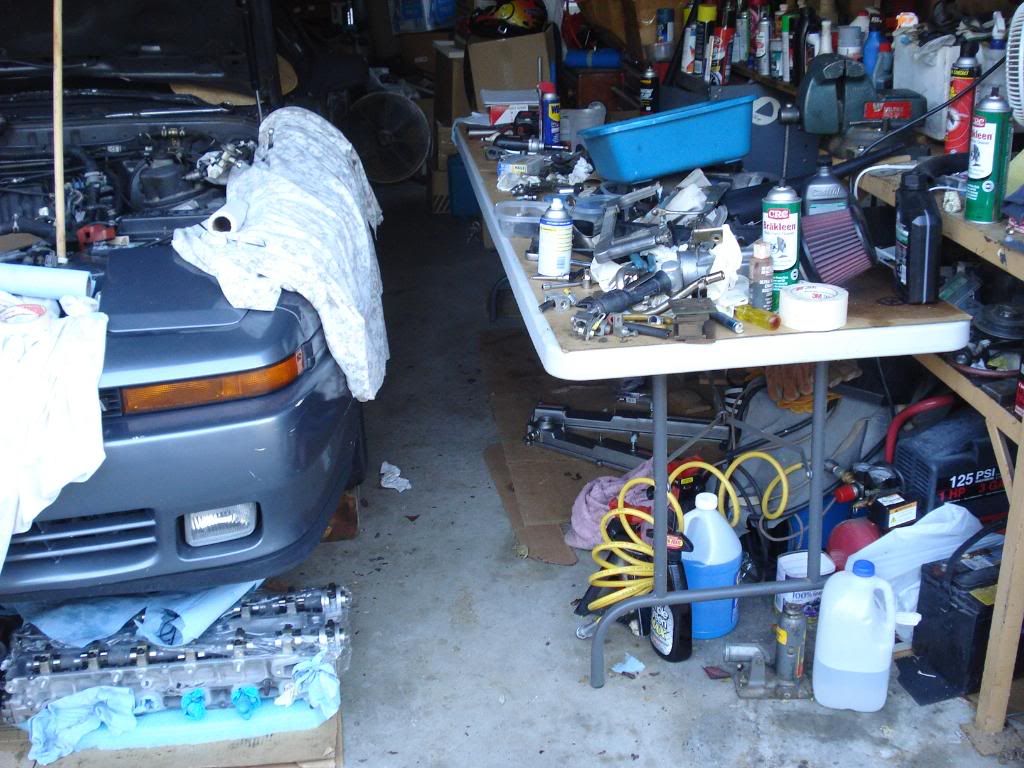

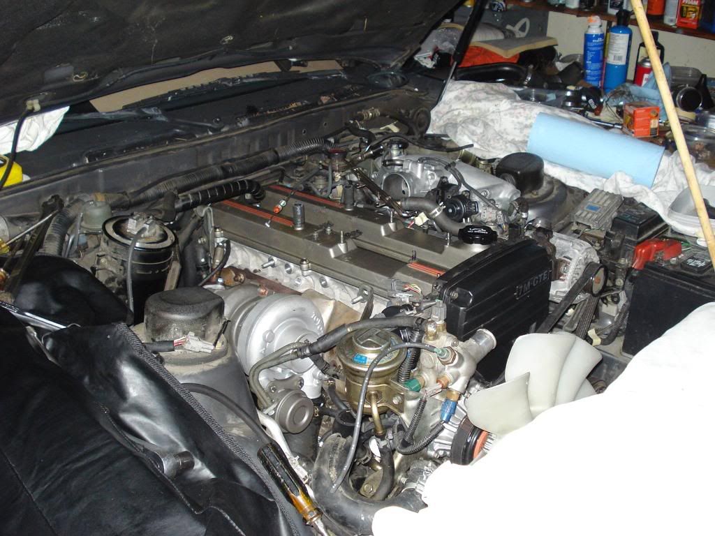

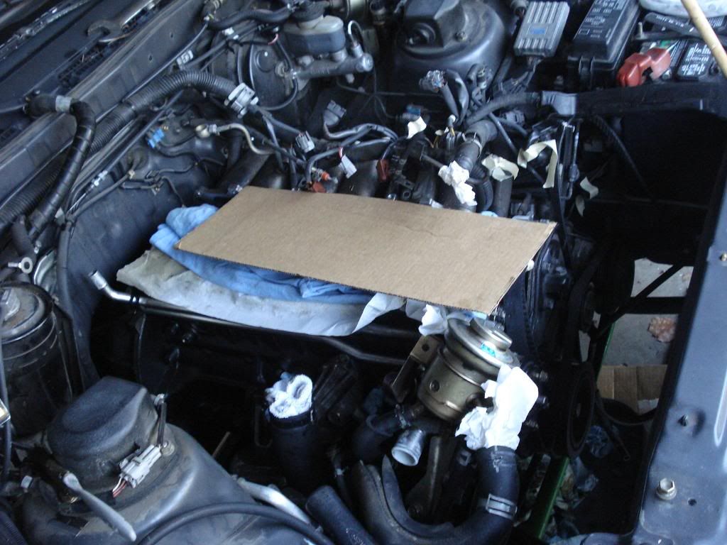

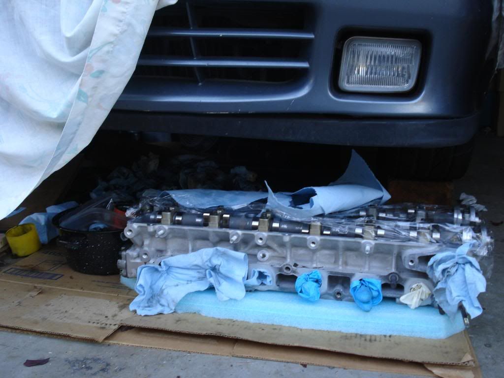

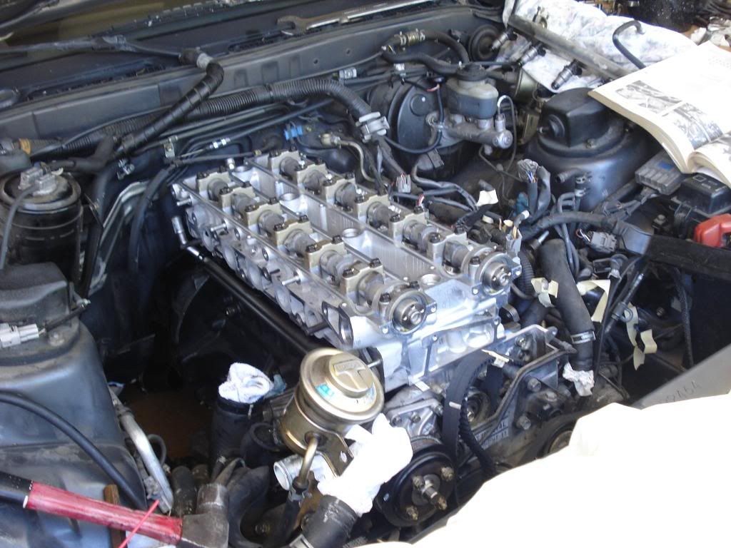

me and my dad got the cylinder head off on saturday:
I've decided that i'm not gonna do the afm/fuel upgrade for now, since i've just realised how expensive it would be to do so. I still wanna get a tuner that can hold two maps, because I think the reason the supra gets such low mpg's is because the a/f ratio is probably always rich incase you wanna boost, and becuase of the breathing restrictions. I hope to get above 28 mpg (hwy). Just to see if its possible, the mpg really isnt a problem, it's just that my dad used to get over 30 mpg in his '96 3.0L v6 camry when he had it, and all he did was put a tube from where the foglight was supposed to be to the air filter box.
Anyways, my dad says that we have to get the head checked to see if it needs to be resurfaced, so I have to take the head apart.
Also, all the white stuff on the engine is salt. Theres also some rust on the engine oil pan and on the side of the block where it looks like some paint chipped. Should I be worried?

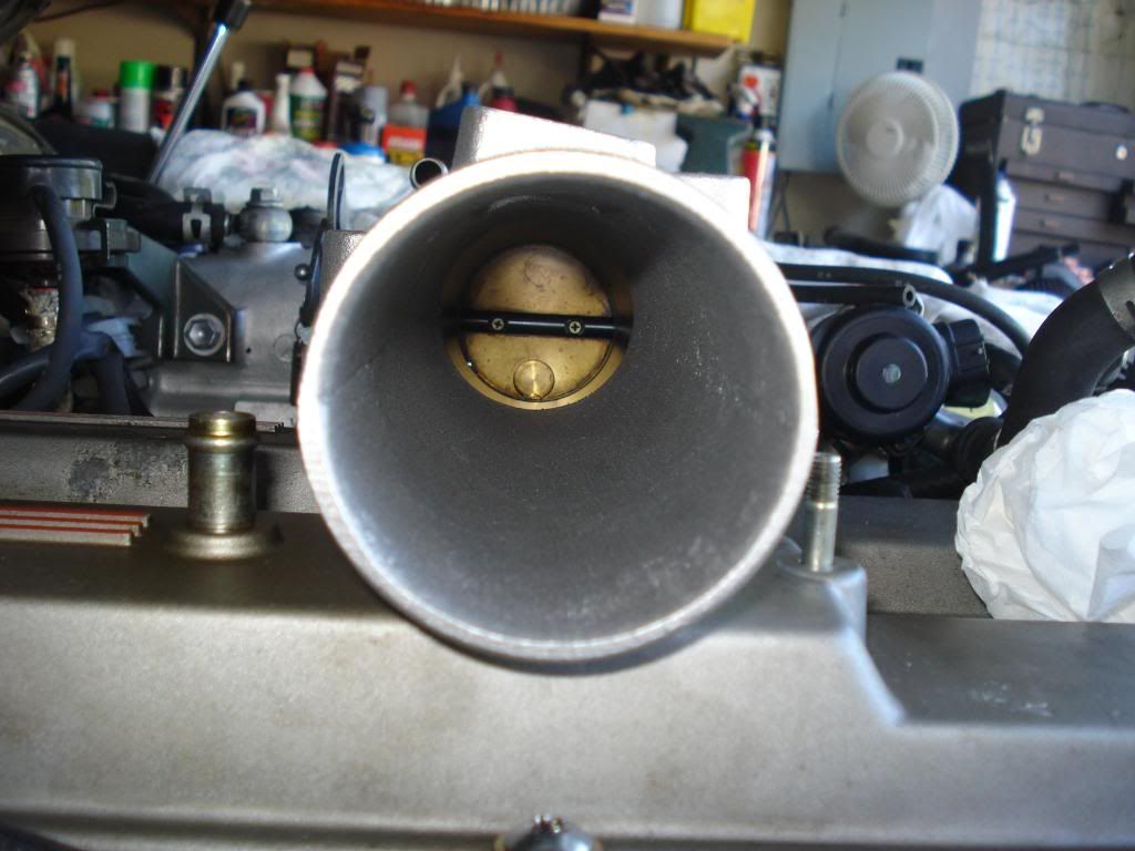

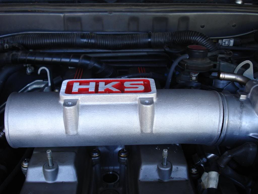

Another thing, the path where the water ic pipng was gonna take isn't gonna happen because there's just enough room for a tube to sqeeze in between the turbo and strut tower, without leaving any room for engine movement, so i'm gonna have to come up with another design, maybe one that involves clocking the compressor housing. I found this pic of a celica alltrac:
That's how direct i'd like my intake to be.

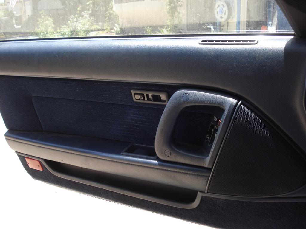

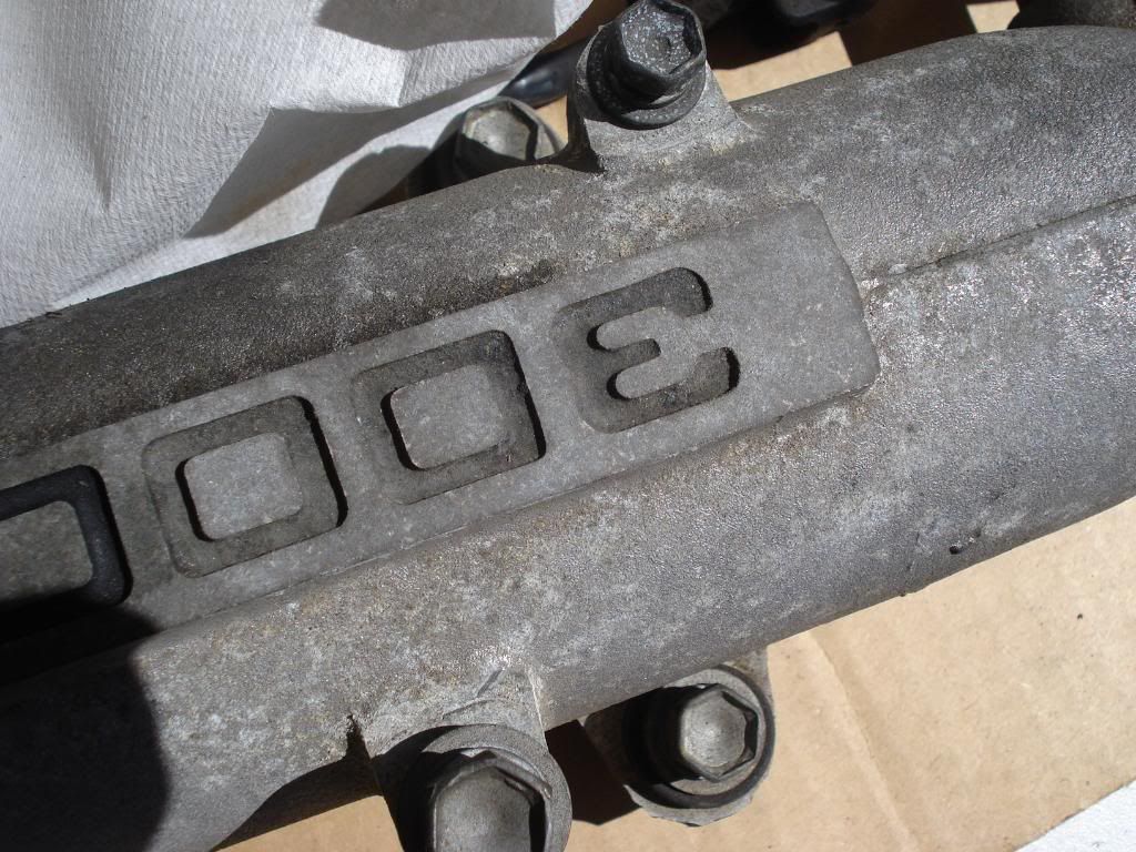

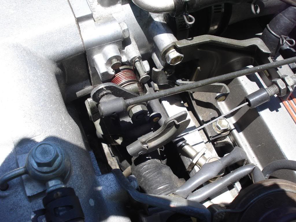

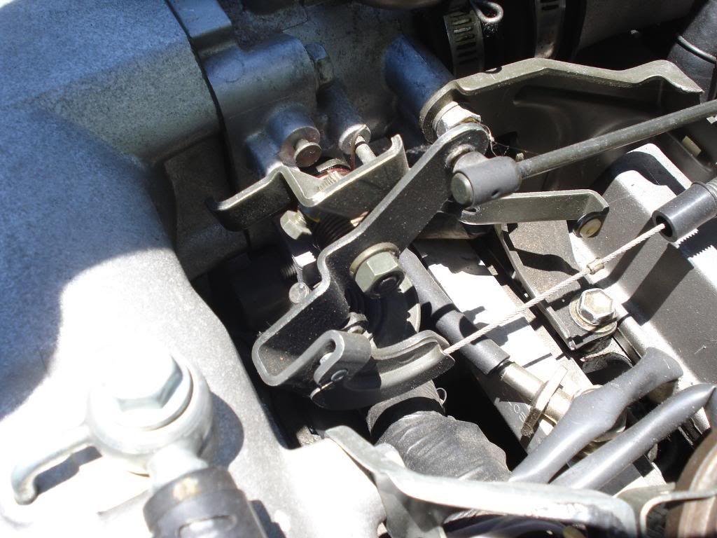

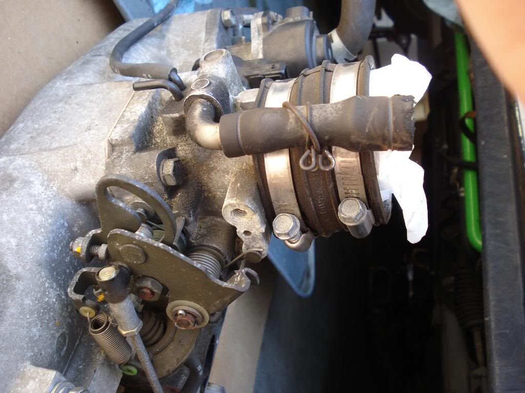

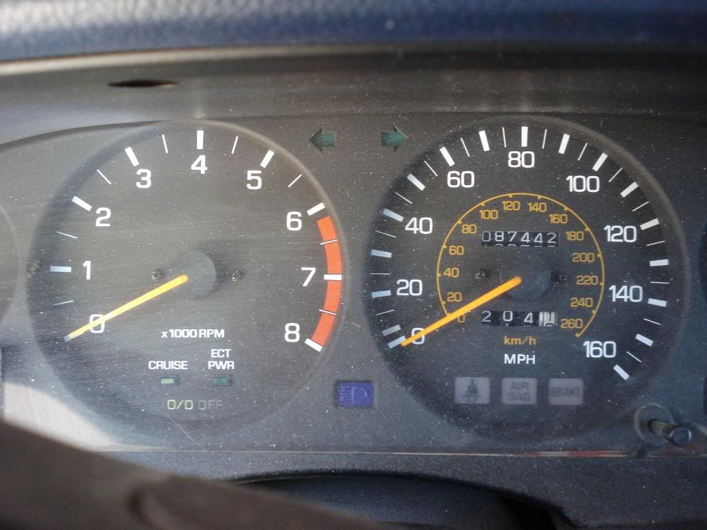

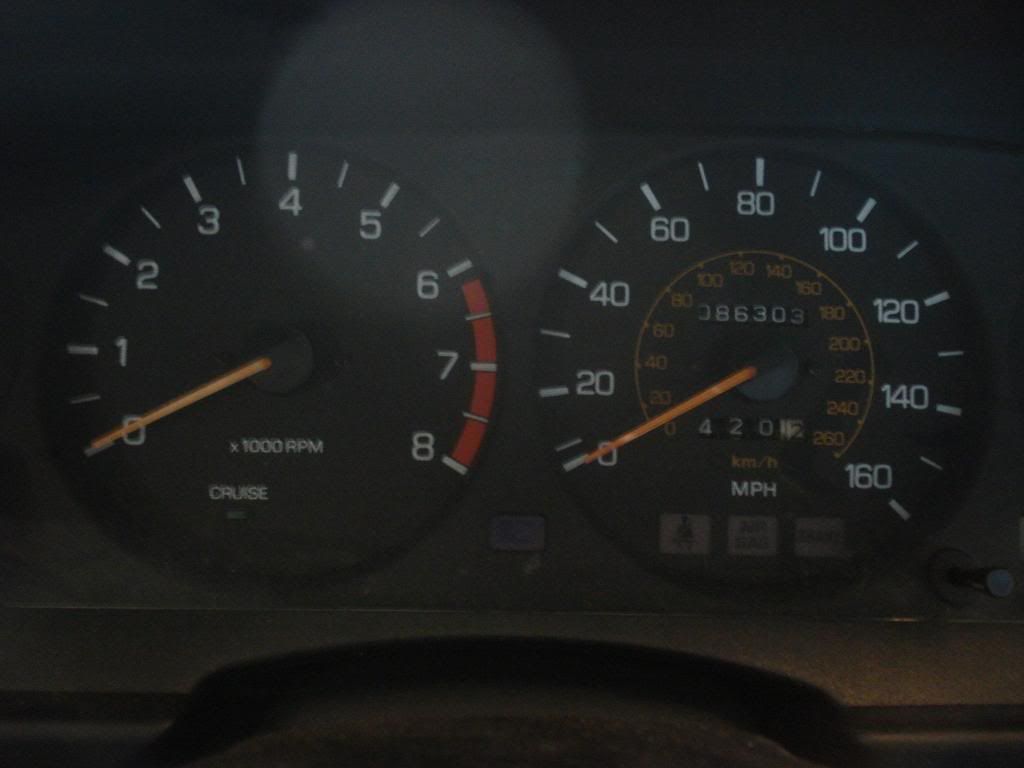

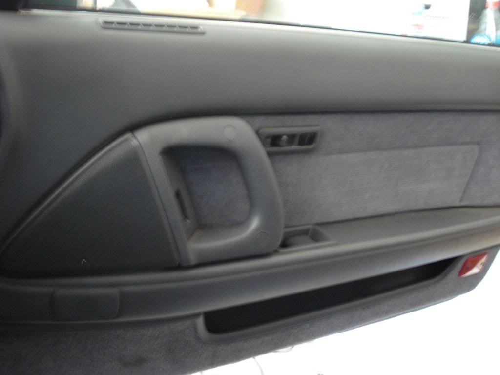

I found a few differences between my 91 supra and my 90 supra:
91 throttle body
90 throttle body
91 speedo
90 speedo
and then the obvious, door panels:
91
90
toyota emblem on the 91 vs supra emblem on the 90, 5 spoke rims on the 91 vs sawblades on the 90, sunroof option on the 91 blah blah blah is there a list of this out there? u know, changes on the mkiii over the years? i've never found one, I had to piece it together myself from lots of searches on google over the past year an a half, and i've forgotten a lot of it. One thing that I remeber reading once was that the hoodstruts where available only in '91, or was it until '91? cus the 90 supra has them.

There's alot more sound deadening in your 91 than the 90...
as for hood struts, all MKIII's got them, despite the year...
I have an 86.5 and a 1992, so I span the entire production, and honestly there are WAAAYYY too many differences to ever convert the 86.5 into a "passable" 1992...
but things worth keeping is definitely your trim (or what's left), rims, door panels, covers, speakers, and (as you already swapped) speedo...

I didn't swap the speedo, but i am going to. As soon as the 90 supra reaches 87442 miles lol.
I thought that because I read this on wikipedia:
"For the 1991 model year, the wheel design was changed to 5-spoke wheels. Both models wore 16x7 aluminum alloy wheels that were fitted with 225/50/16 tires and full-sized spares on steel wheels. It was also the last Supra to come with hood struts and a full-sized spare wheel since they added weight."
but it also says "This article needs additional citations for verification" on the top of the page, so i'm gonna go with what you said. Everyone on this forum knows too much about supras to let a wikipedia page about the car be incorrect. Being a little biased, I'd like to at least see the mkiii section updated :)

some updates and pics:

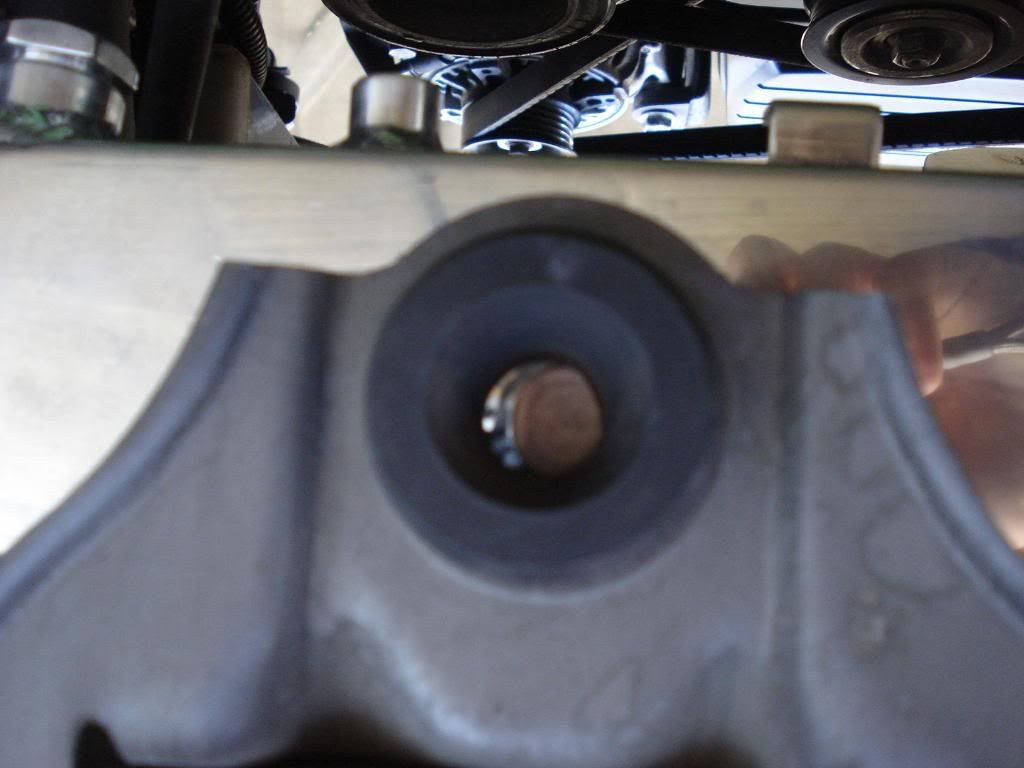

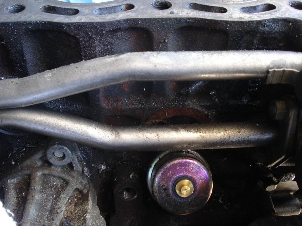

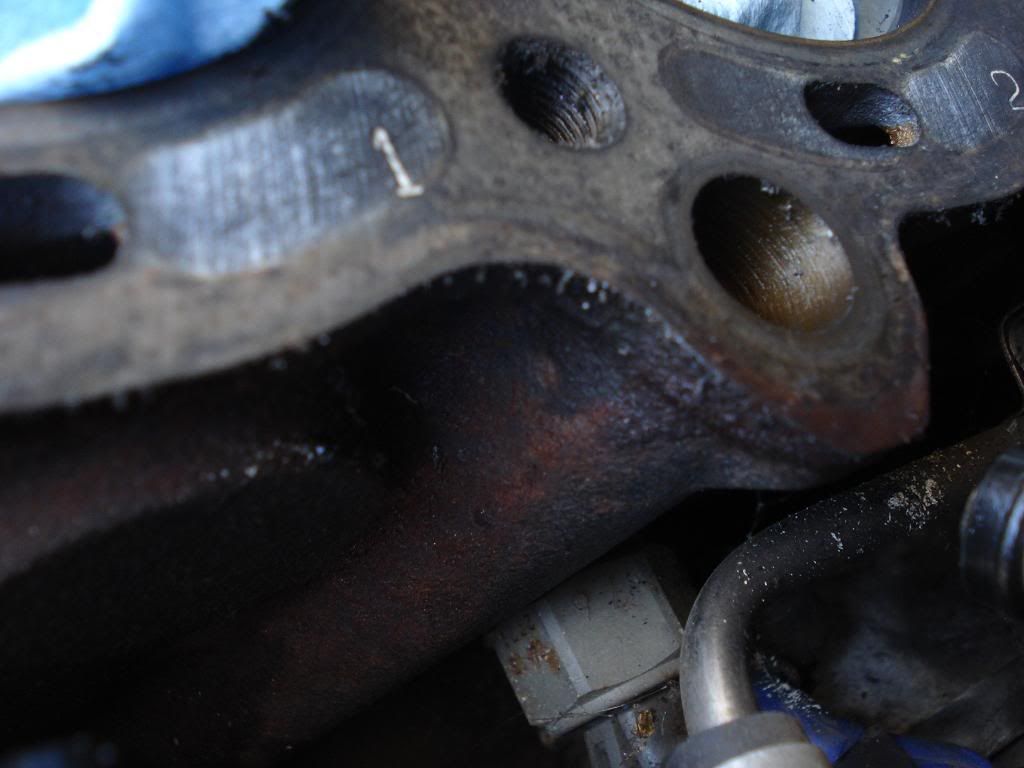

i took pics of the rust on the block:
I'm not gonna do anything about it for now. Should I?
I took a pic of the 3000 pipe to get a close up of the salt:
Any ideas on where this car's been or why some of the engine is covered with salt?

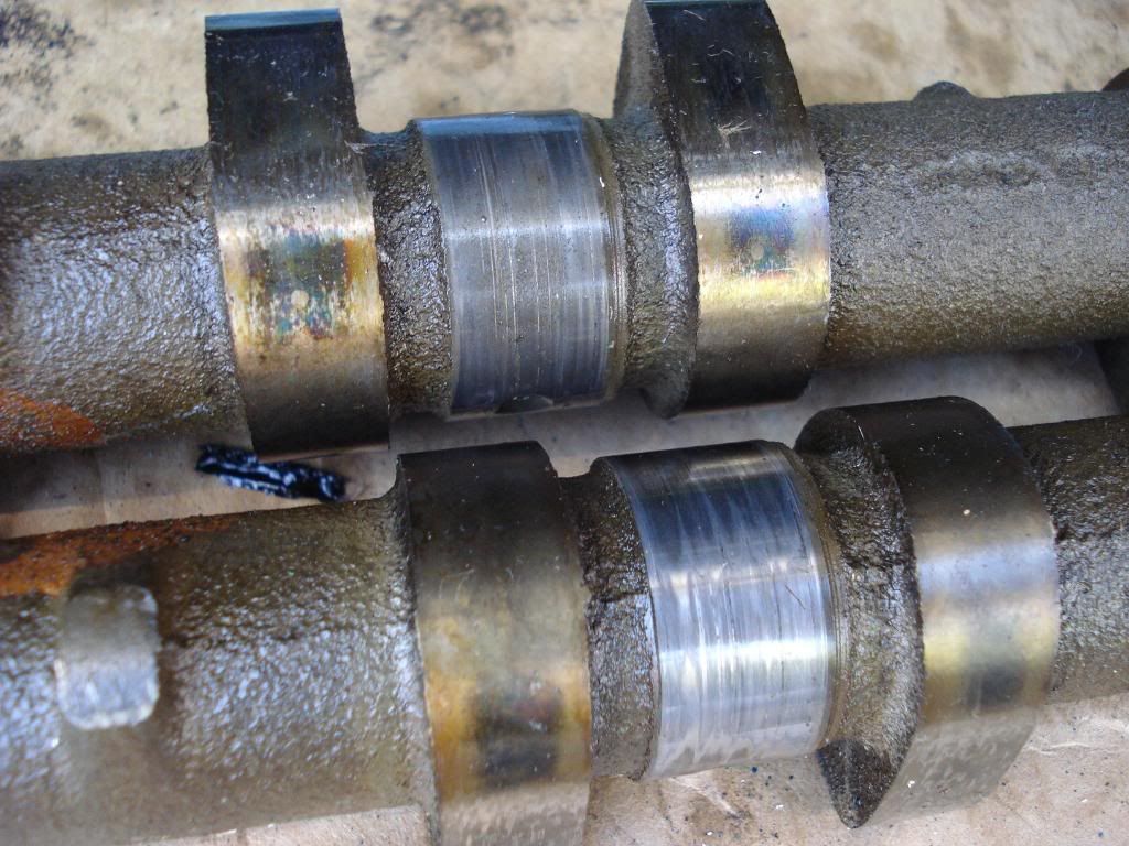

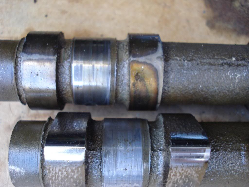

This is what my camshafts look like (the bearings on the head don't look so good either):

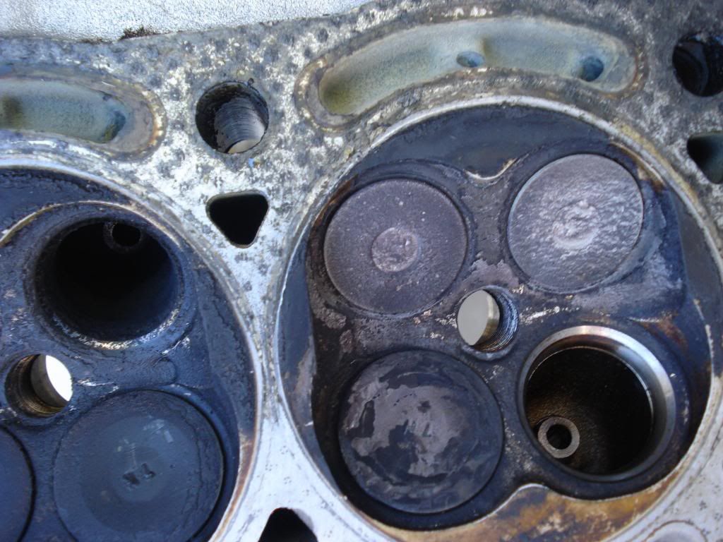

And one of my exhaust valve seats and one of my intake valve seats:
A local machine shop told me I need a head rebuild. This is cutting into my Supra-driving time. I showed them my headgasket while I was there, so that they would know what the head's been through:
They said that al that white crap is some kind a sealer that's used for a radiator leak. Well, it looks like the sealer found the leak.

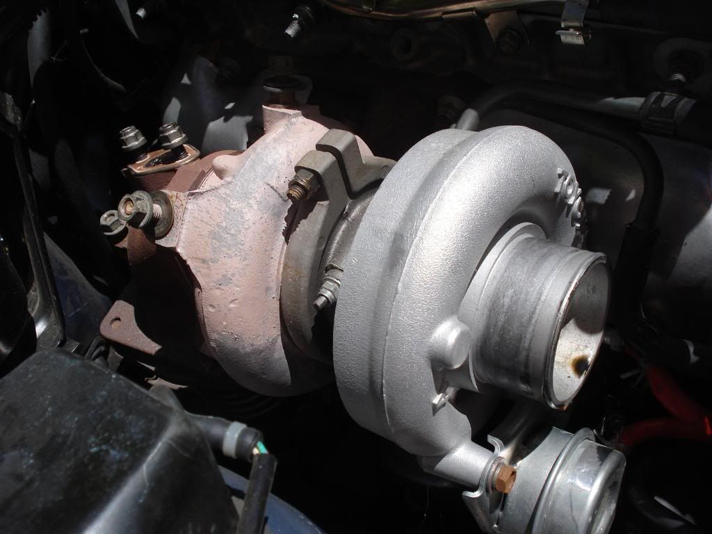

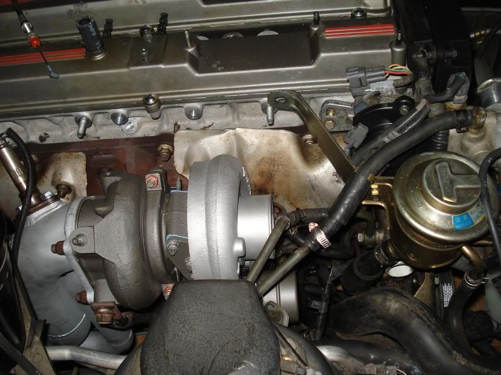

I couldn't get the shop that rebuilt my last turbo (the one on the 91 supra) on the phone for two days so I figured that if they're too busy to answer the phone; they'd take like a month to rebuild the one on the 90 supra. So I decided that I'd use the one on the 91:

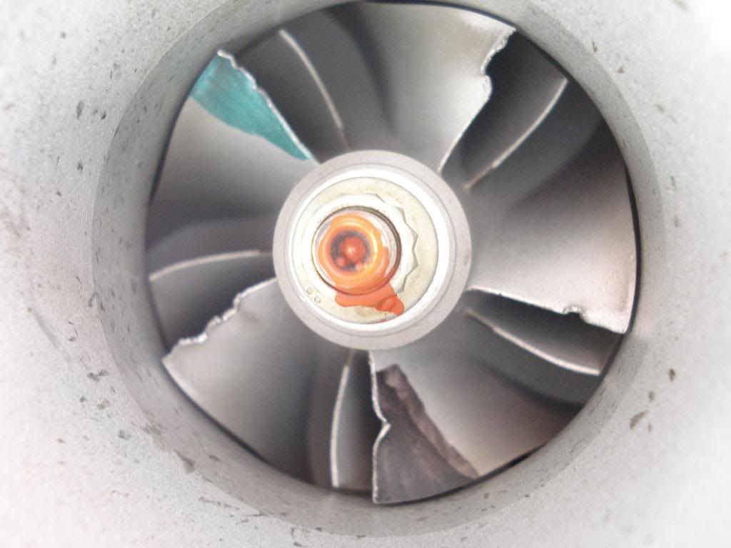

Notice the oil in the inlet?
Also, on a side note, is the turbine housing supposed to look like that? It turned that color the next day after running it for the first time over a year ago and it never changed back. Infact, that stuff comes off. It feels like chalk.

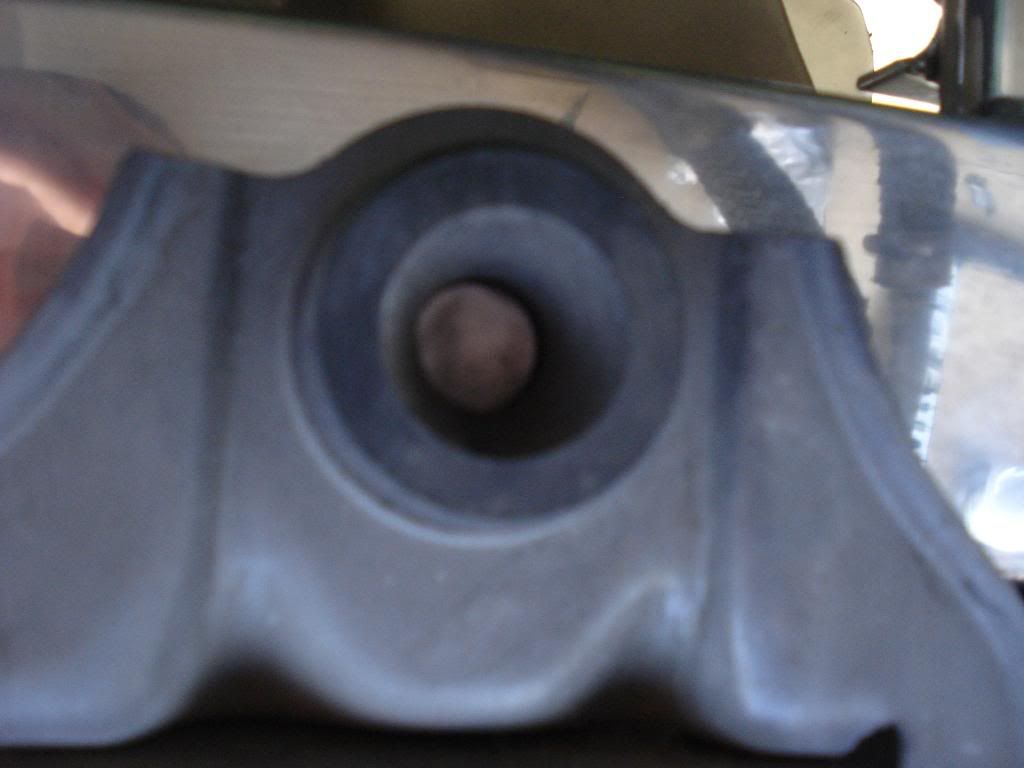

Anyways, about that oil in the inlet, I took a closer look (and a pic):
Fuck! What the hell happened?! I guess a piece of the air box broke off or something like that from the crash. Damn! I tried calling the turbo rebuild shop again right after discovering this and they answered. Said that it would be $95 for another compressor wheel, ontop of another full rebuild because it ran unbalanced, causing the leak. I asked them how long will a standard rebuild take and they said 10-12 days. That didn't sound bad, so I shipped the turbo from the 90 supra (the one with a fully intact compressor wheel) last Thursday.
That's what I have for now, I plan to take apart the head to check the rest of the valve seats (and valve faces). I'm expecting to find the rest of the exhaust valve seats and faces to look the same; same for the intake. I think the exhaust valve looking so bad has something to do with the exhaust cam gear being a tooth off (it needs to be turned counterclockwise) when I first saw it. Then I'll get a valve job, get the head back on the block and assemble everything on the intake side with a fel pro head gasket kit, and start measuring for the water ic piping with help from the turbo from the 91 supra (I have to finish getting it off though). Then I can decide which type of water ic (style of endtanks) to get.
I've been told that I don't have to worry about the exhaust cam gear being off in this thread: http://www.supramania.com/forums/showthread.php?t=101767
And that a Fel Pro will be fine in this thread: http://www.supramania.com/forums/showthread.php?t=101674

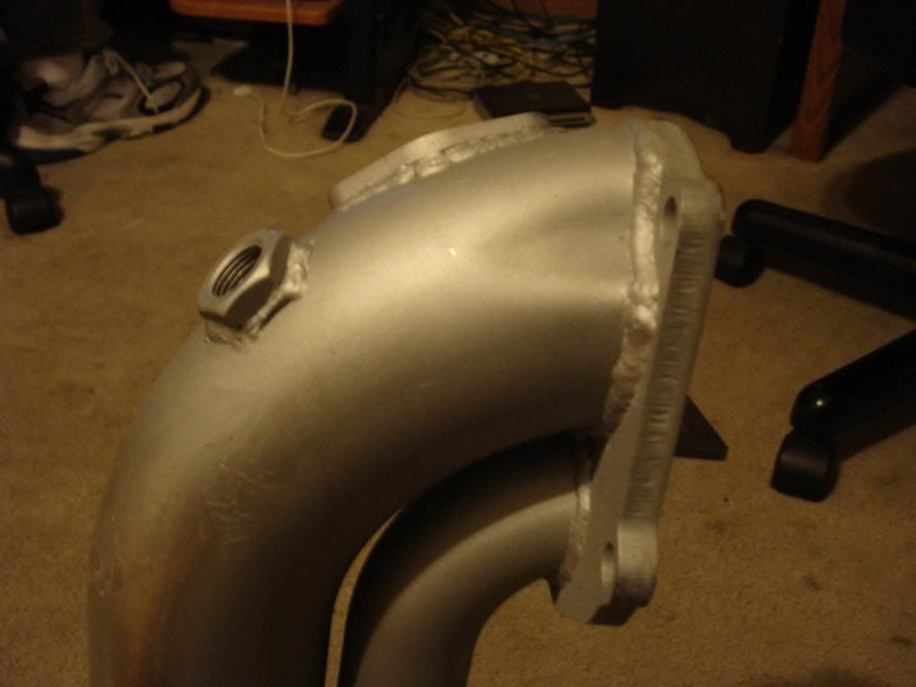

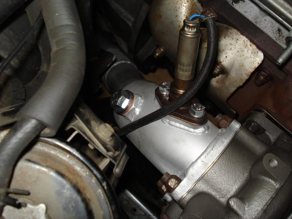

Although I haven't posted, I did keep working on the supra, just kept procrastinating the updates. Short story: I drove it out of the garage on 9/17/09 in the afternoon. Long story:
When I got my BIC downpipe, I was dissapointed by the placement of the second 02 bung becasue I read in a thread that It had to be atleast 18in. from the turbo
So I posted in said thread and it turns out that the wideband can run that close to the turbo with a heatsink:http://www.supramania.com/forums/showthread.php?t=99895&page=3

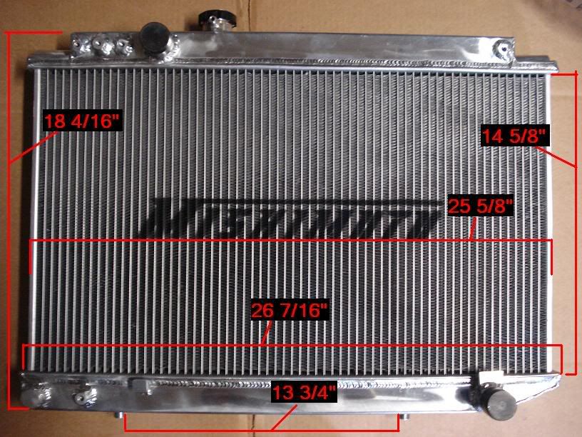

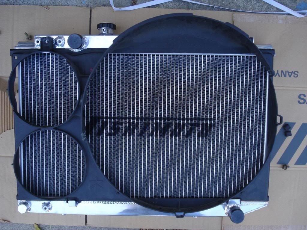

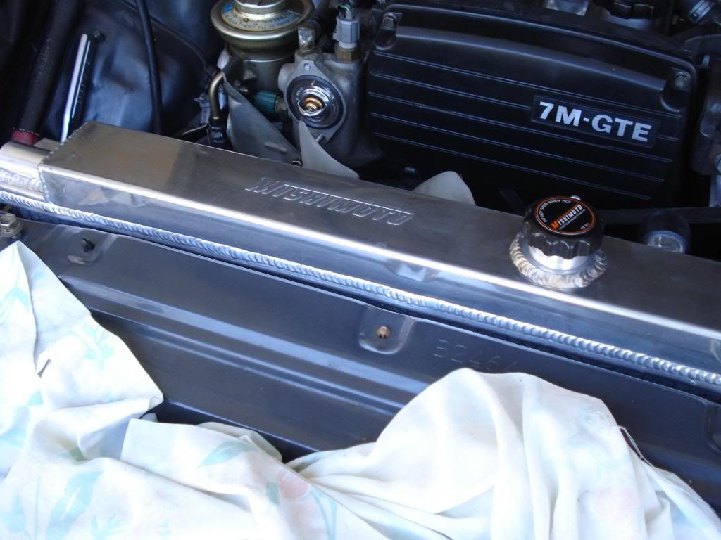

When I got my mishimoto radiator I started this thread: http://www.supramania.com/forums/showthread.php?t=105577

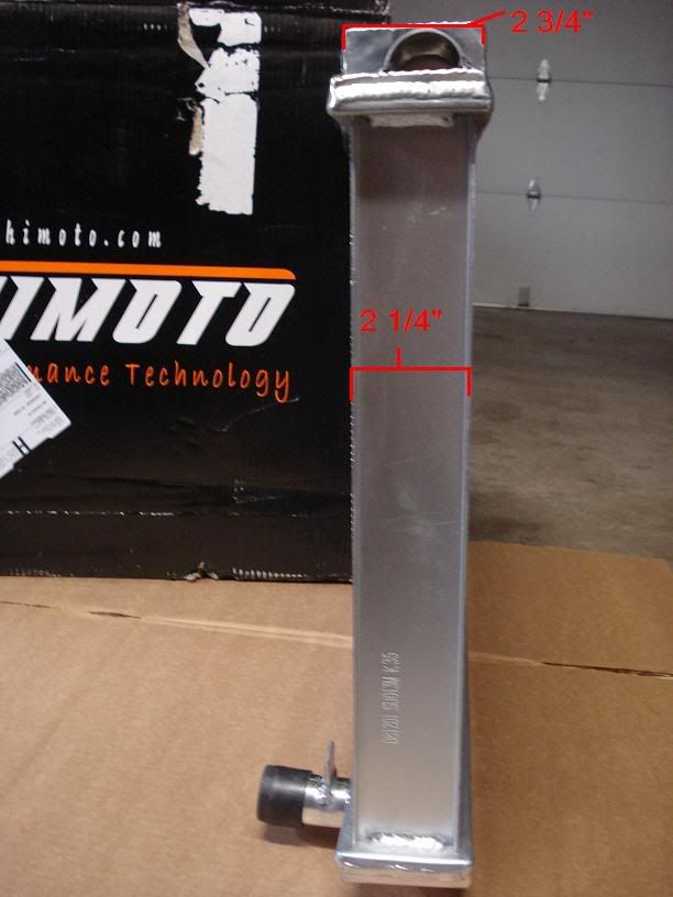

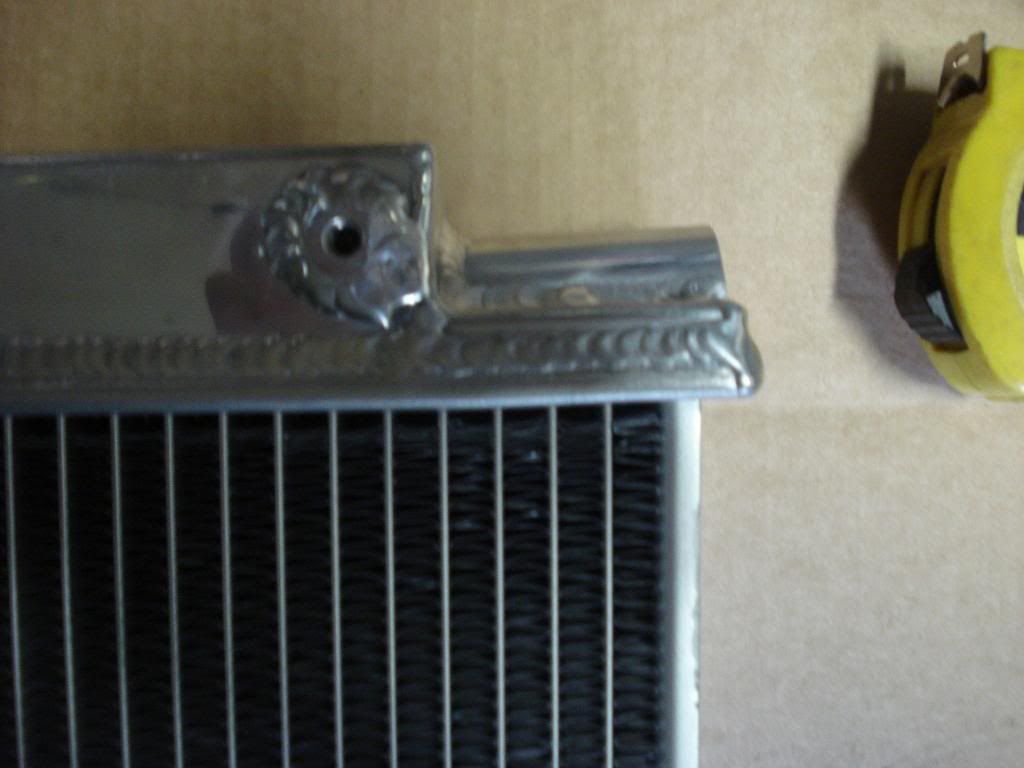

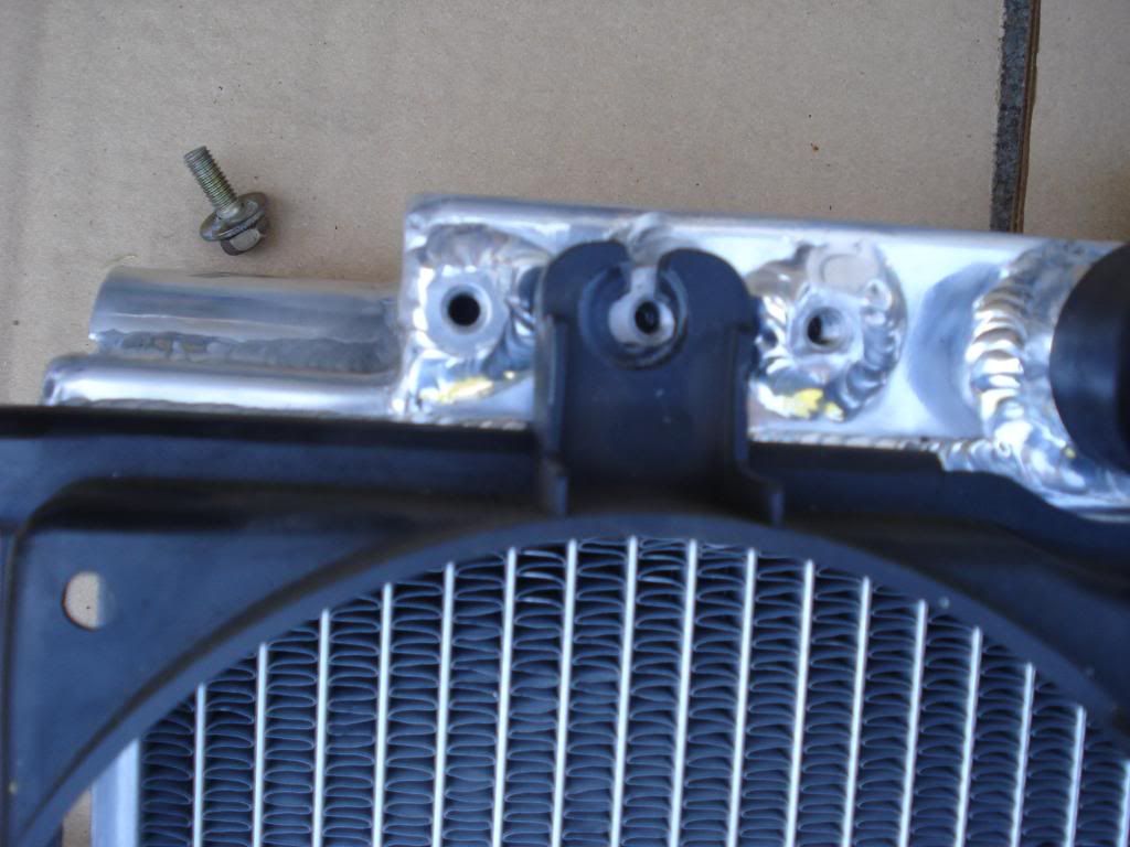

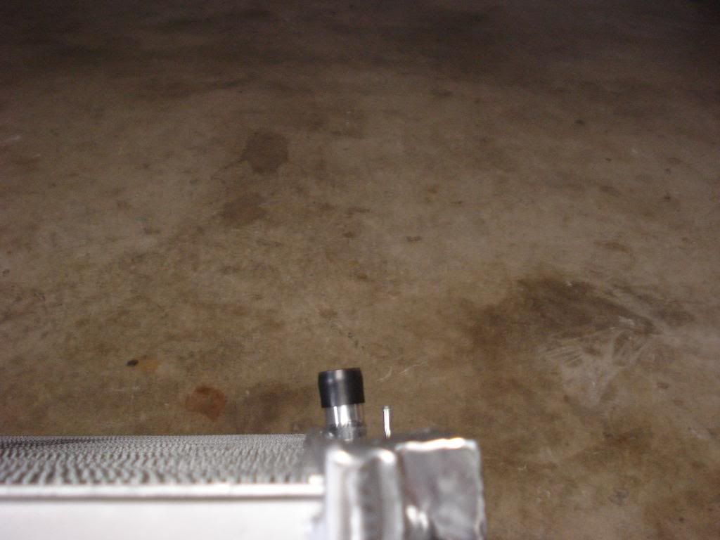

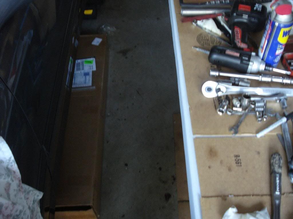

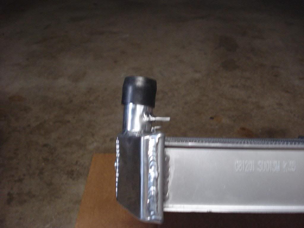

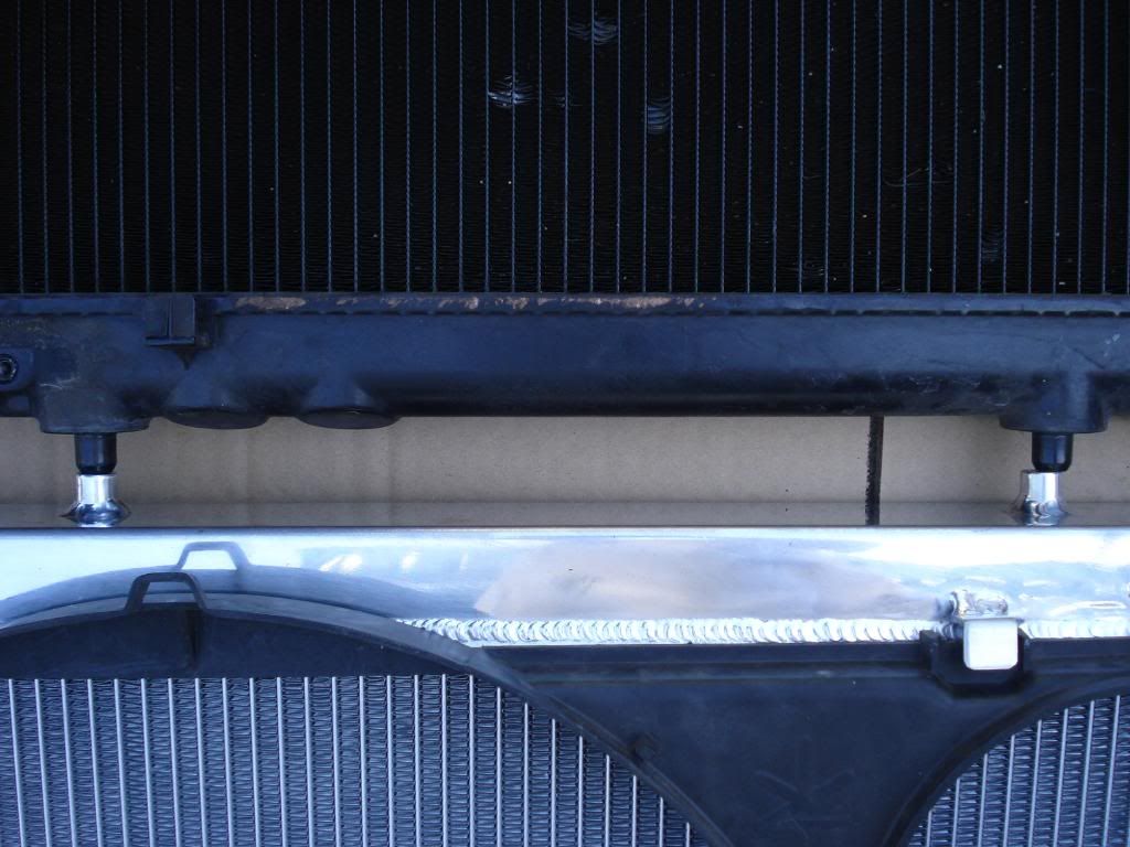

livinasask8er;1403557 said:
I bought a mishimoto radiator (Mishimoto (86-92) Supra MK3 Aluminum Radiators - Manual) from horsepowerfreaks.com on 8/15/09 and didn't try to install it until two days ago and ran into multiple problems:

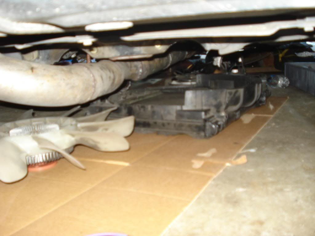

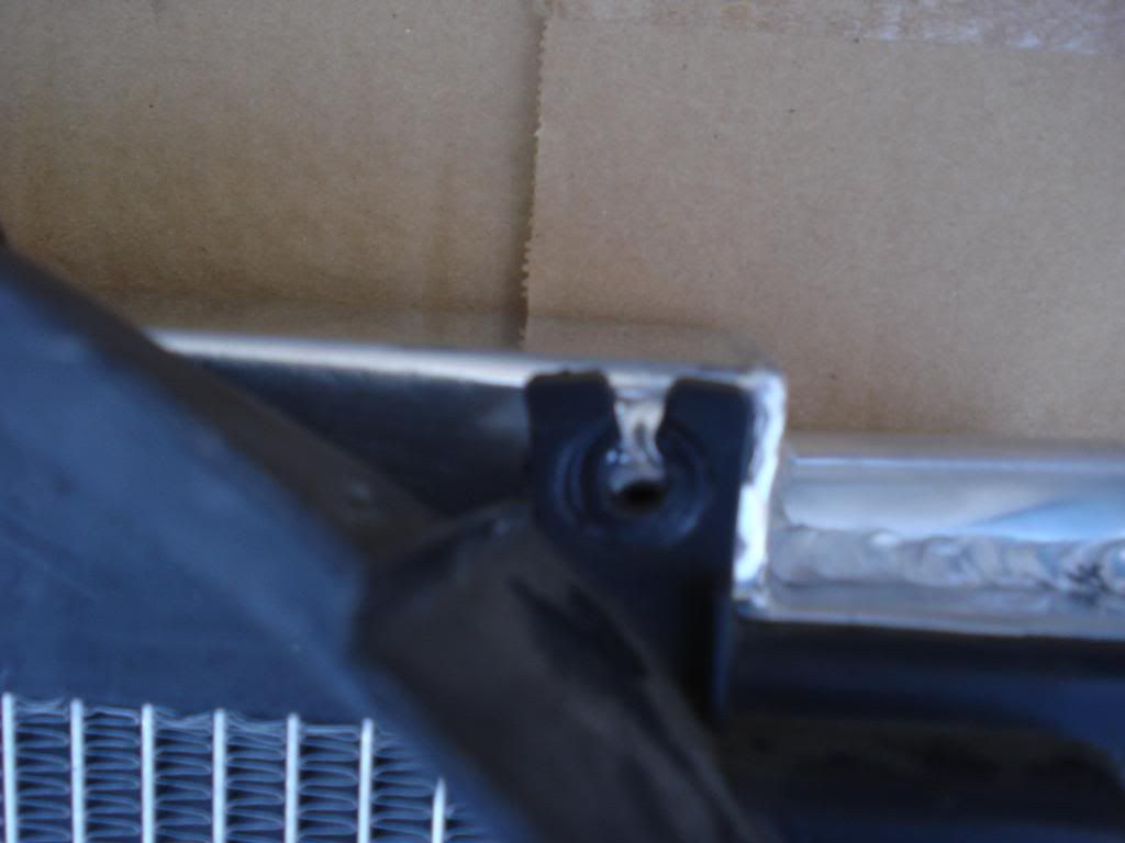

This is as close as I can get the stock shroud to the threads, and that's after taking the two ruber things off the bottom:
Also notice that the shroud is over half an inch longer than the radiator (on the left in the first pic).

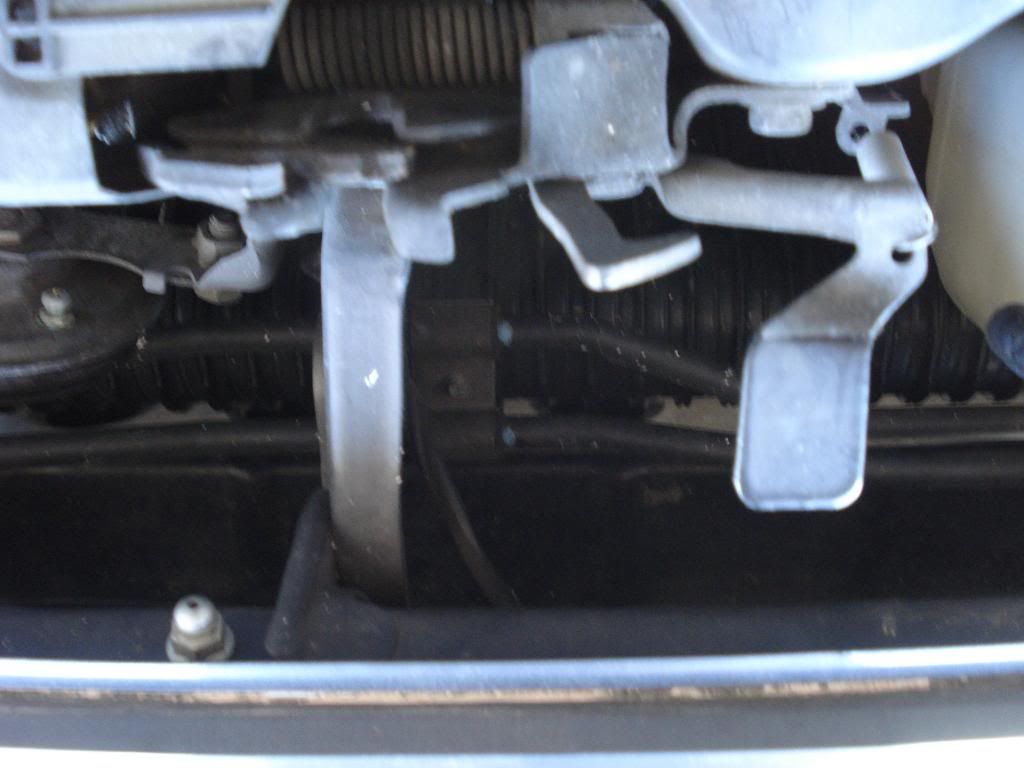

I tried to see how the rad would fit in the engine bay, just to see if maybe it's worth modding:
It doesn't go all the way down...
... because when you get one side to match the rad support...
... the other side doesn't line up. I compared it to the stock rad:
Another thing, the shroud sits like 1/4" off the rad in some places when placed on top of the rad like in the first pic, I don't have a pic of this though.
From Mishimoto's site; the mkiii supra page (http://www.mishimoto.com/toyota-supra-performance-aluminum-radiator-86-92.html): "(...)Every Mishimoto aluminum radiator is a direct OEM fit, making installation effortless with no cutting or modification required(...)"
So when I make my warranty claim, should I ask for a replacement because this is a 1:1000 manufacturing defect, or should I ask for my money back because mishimoto rads suck? I'm leaning towards the latter since it says made in china on the box, and because I'm thinking that maybe I don't need an upgrade since it's going to be a daily driver in the bay area, going WOT to ~10 psi to impress a passenger every once in a while.
These were the e-mails with technical support:

Thanks for responding. Based on your response and the copy of my message below (Original Message), I'm guessing that the form on the contact page on the Mishimoto site (http://www.mishimoto.com/contact.html) failed to send the message I wrote, so I'll write it again:
I bought a Mishimoto radiator [Mishimoto (86-92) Supra MK3 Aluminum Radiators - Manual] on 8/15/09 for my 1990 Toyota Supra, Turbo and when I tried to intall it on 9/07/09 I ran into the following issues:
1. The holes in the stock shroud don't line up close enough to the threads in the Mishimoto Performance (MP) radiator to place the screws in without it warping the stock shroud, and that's without the two rubber "spacers" at the bottom of the stock shroud.
2. With the stock shroud laying on MP radiator with the holes matching as close as possible as stated above, the stock shroud is over half an inch longer than the MP radiator, meaning that, in the largest dimension, the MP radiator is approximately 1/2" shorter than the stock radiator.
3. I took the shroud back off and tried to see how the MP radiator fits in the car to see if maybe it wouldn't require to much modification to properly function, but it turned out that it wouldn't drop all the way in because it didn't line up to the two lower supports in the car. I took it back out and compared it to the stock radiator; the two supports on the bottom of the MP radiator were about a quarter of an inch (1/4") closer to each other than stock specifications.
It states on the page on the Mishimoto site that displays the info on this radiator (http://www.mishimoto.com/toyota-supra-performance-aluminum-radiator-86-92.html) that "Every Mishimoto aluminum radiator is a direct OEM fit, making installation effortless with no cutting or modification required". This radiator does require modification to fit and, unless you can exchange mine with one that is a direct OEM fit with transportion costs covered for both sending this radiator to Mishimoto and sending me a new one, I would like a refund. I have photos of the above problems if requested. Thank you for your time.

It says MMRAD-SUP-86 on the side of the box. Here are the pictures:
http://i572.photobucket.com/albums/ss168/livinasask8er/DSC03130.jpg
http://i572.photobucket.com/albums/ss168/livinasask8er/DSC03131.jpg
http://i572.photobucket.com/albums/ss168/livinasask8er/DSC03132.jpg
http://i572.photobucket.com/albums/ss168/livinasask8er/DSC03129.jpg
http://i572.photobucket.com/albums/ss168/livinasask8er/DSC03125.jpg
http://i572.photobucket.com/albums/ss168/livinasask8er/DSC03126.jpg
http://i572.photobucket.com/albums/ss168/livinasask8er/DSC03133.jpg

Thank you for sending those pictures earlier. Could you please make some overall measurements of the radiator and core(height, width, Length) This would be helpful info to solve this problem.
Thanks,
Dan
Mishimoto R&D
September 23, 2009 3:43 PM
me:
Hi Dan,
Here are the measurements:
While measuring I found a few other things:
The area around the upper support in the top-right of the photo appears to be bent upwards:
The endtanks are also bent, both of them seem to point towards the back (as in, if mounted, towards the engine):
Also, the radiator doesn't seem perfectly square if you look at it from the side (the photo at the top of this reply shows this; the first of the photos with the measurements), but it's not warped enough to cause problems. What I mean is that there are sufficient problems excluding the warping to make this radiator non-functional for my application.
-Jaime Hernandez

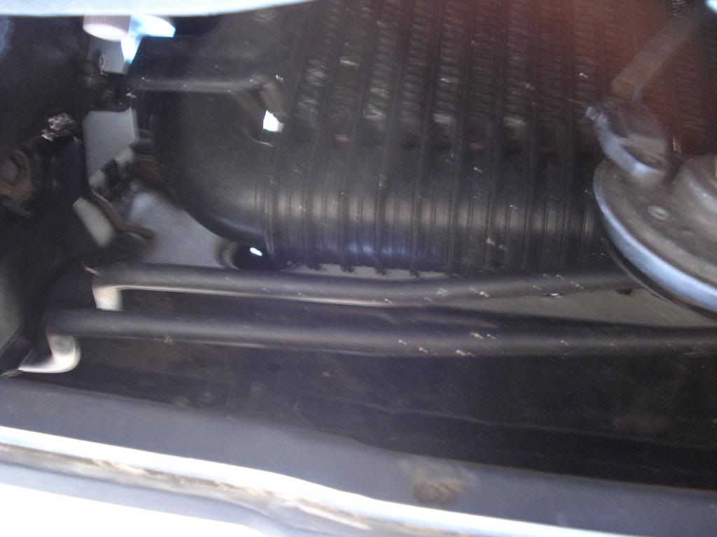

Check your accordian pipe! The insides might be falling apart and a piece may have damaged your turbo. I doubt it's the air box because it would need to make it through the AFM first.
toyotanos
What will we break today?
Nov 29, 2008
2,841
Coon Rapids, MN
Hey, we're dealing with the same problem! We even dealt with the same guy, Chris! I'm still waiting for my radiator to arrive, I hope it's better than the one I got. At least your upper supports were in the right spot! The lowers on mine didn't line up right, either. I would figure that augering out the lower rubber support would be much easier than doing anything else, though. Good luck!
A. Jay
Search.
Jun 3, 2009
671
34
Bay Area, CA
I didn't give it much thought because I already had the '90 supra when I found this, but it's true the pieces would have had to get through the air straightener I'll look into why the '91's turbo was damaged before I get rid of the car, which is soon.
More pics of what turned from a build into a maintenance thread (more about that later):
This is the head finally bolted to the block, after shaving down the back timing plate that stuck up .002" on the exhaust side and .012" on the intake side with a file (8/30/09):
Opening the box for the turbo ~a week after I get it (9/3/09):
I took a picture of the turbine, since I have pics of the cold side from when I got my last turbo back but I never took any from the hot side:
Getting close (9/7/09):
We forgot about the manifold's heatshields so my dad tried to squeeze it in:
He did get it in, but after unbolting the turbo from the manifold, the oil lines from the block, and a few other things.
Here's the elbow of the downpipe:
Here's how the HKS 3000 pipe looks:
I'm not gonna use it for now because my dad said that he wants the car out of the garage as soon as possible so I decided that when I retorque the head I'll put in the water ic intake that I wanted to put together. Btw the ID is 2.49 in., the trottle body's ID is 2.56 in., I don't know where "2.75in all the way through to match the trottle body" came from.

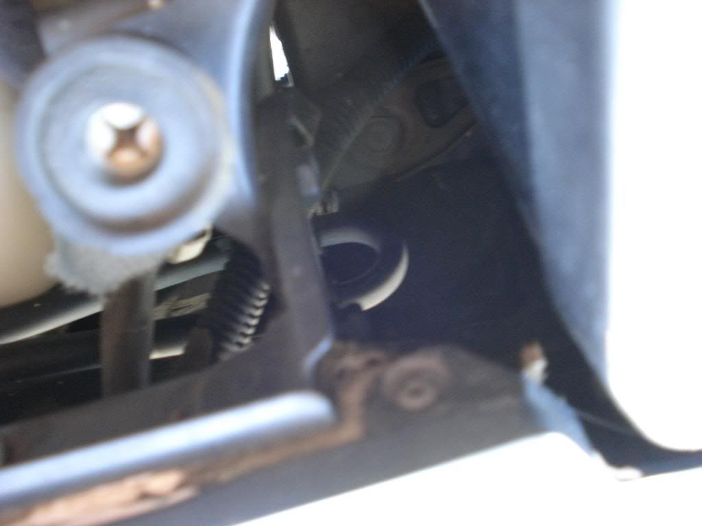

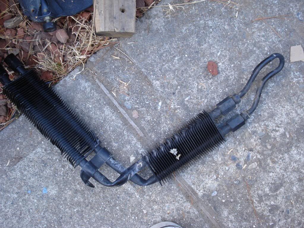

I found another difference between the '90 and the '91, here's the power steering hardline from the '90:
This was in the same place in the '91:
I also took pics of how we were working on the car, as in the confined space that we used (8/26/09, btw this is all mostly for me to look back on, that's why there are so many pointless pics):
Gonna take a break again.
