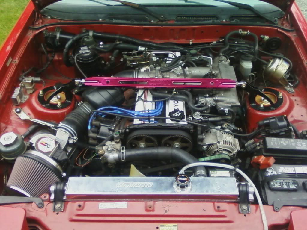

Bought this beast after my return from Iraq Dec 09. $900 running on smoking BHG with very bad interior.

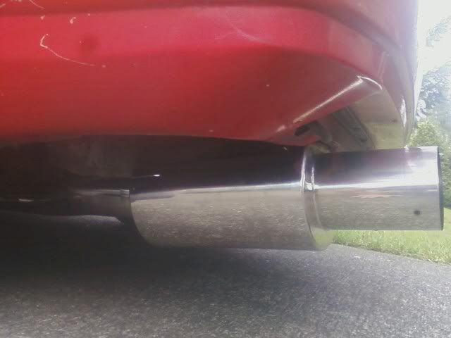

Now has a deep, clean muscle rumble from the 3" exhaust, 284 degree cams, K&N FIPK, and head port.
Sits low and sticks to the road but still running the sawblades i got it with (they were painted white?!)
Removed the rear wing and glassed in all the holes. Repainted the roof and rear quarters.
Then painted the trim white on a whim to match the wheels.
And still has a very bad interior.
Power:
HKS 1.0 mm Stopper MHG, Machined Head .010, Compression 10.64, Torqued to 72, Mishimoto Rad/Fan, K&N FIPK, 284 degree Cams, 208 cfm Head Port, Rebuilt block/head, ACL Race Bearings, NGK Plugs/Wires, 3" SS Exhaust, Samco Ancilliary Hoses, Flex-a-Lite Oil Cooler, Power Enterprise Hi-Flow Cat, Lightweight Aluminum Flywheel
