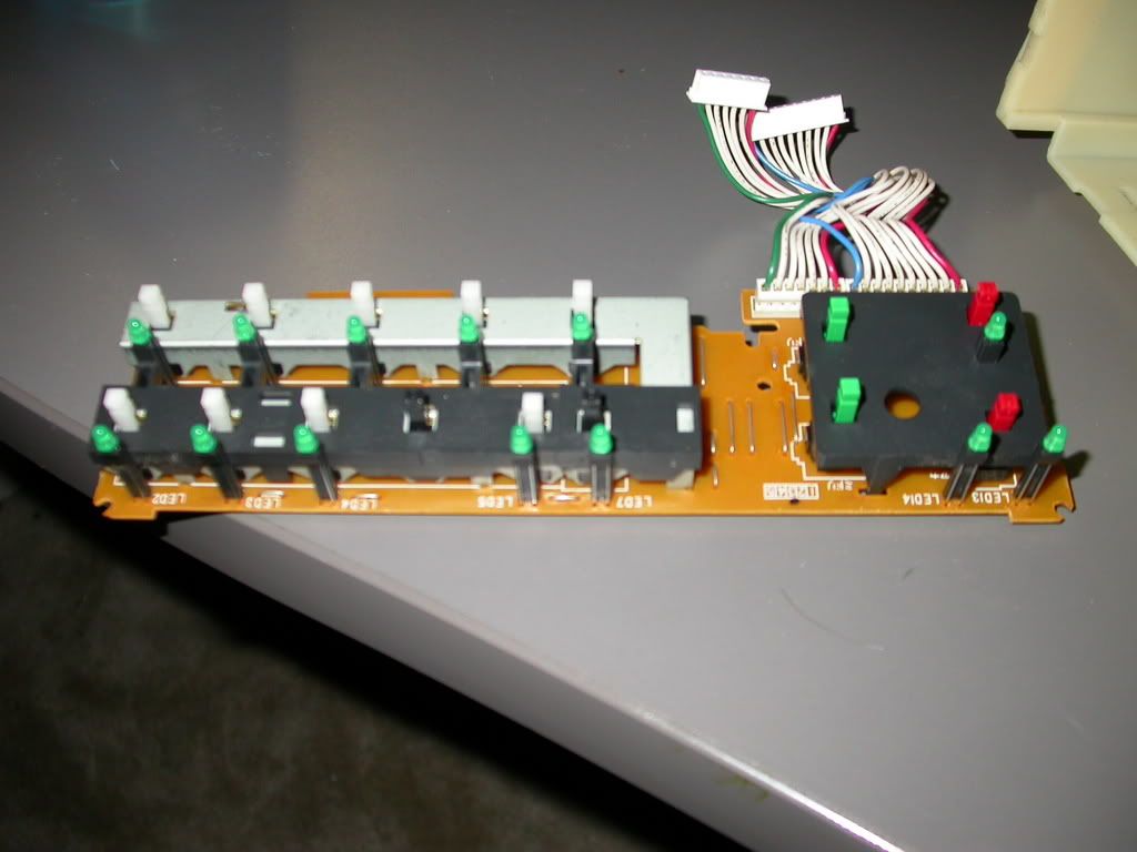

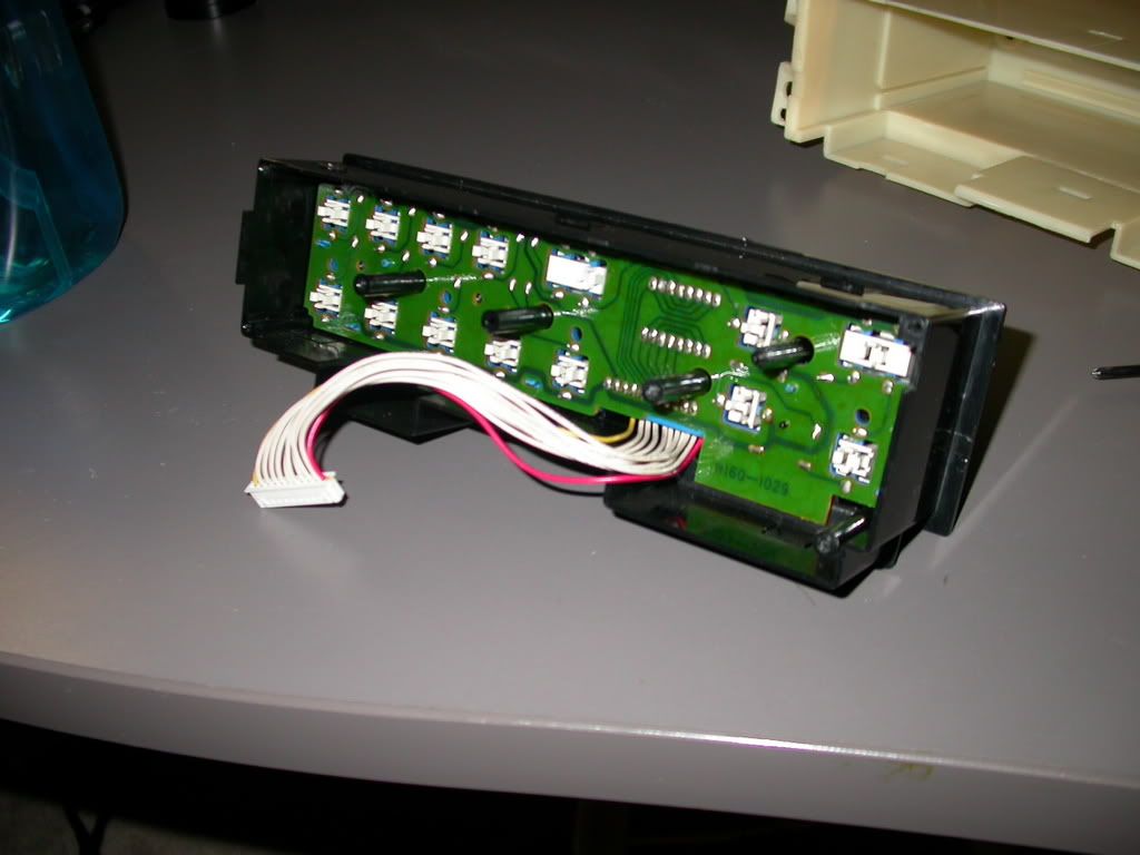

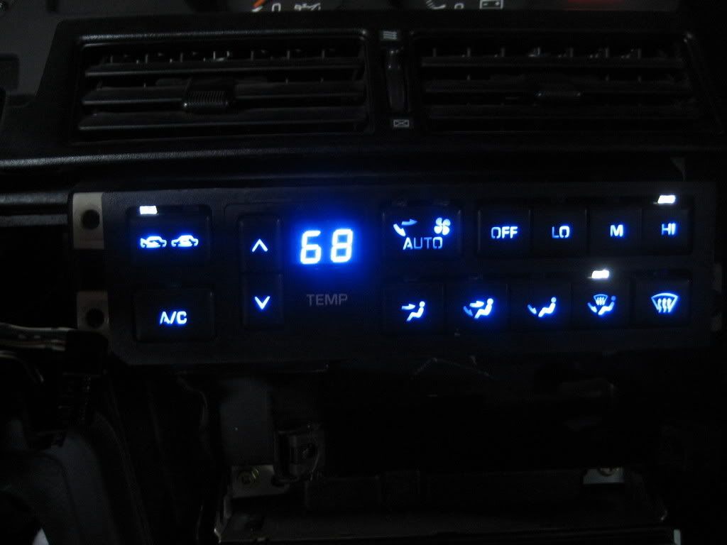

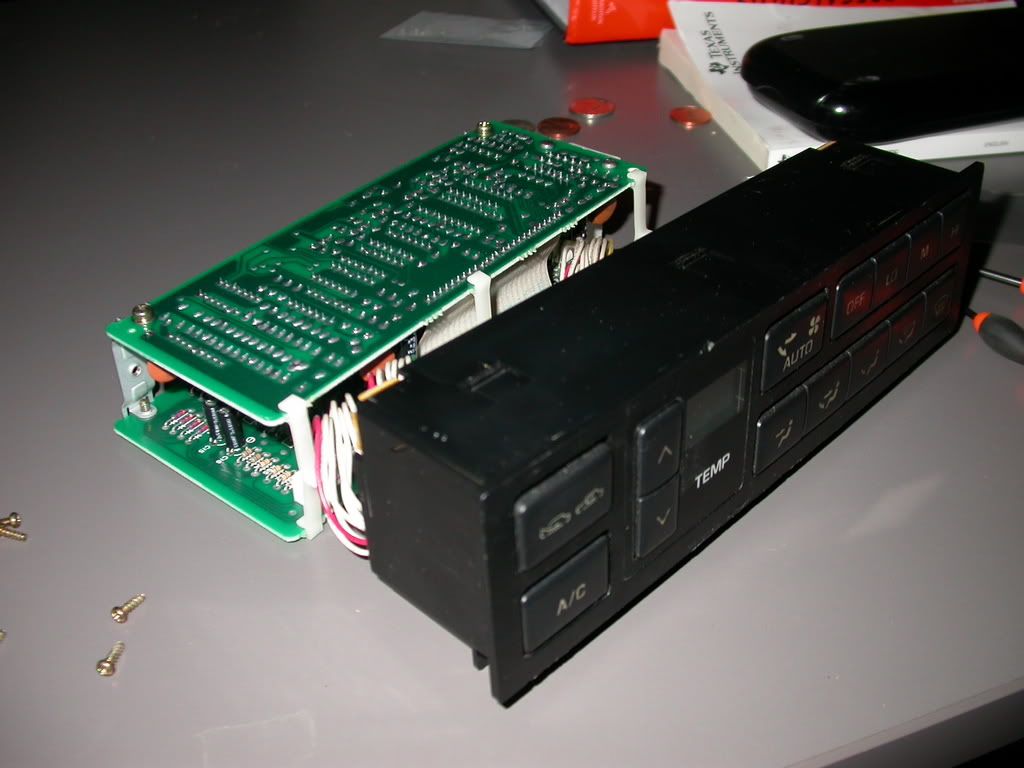

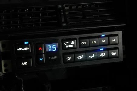

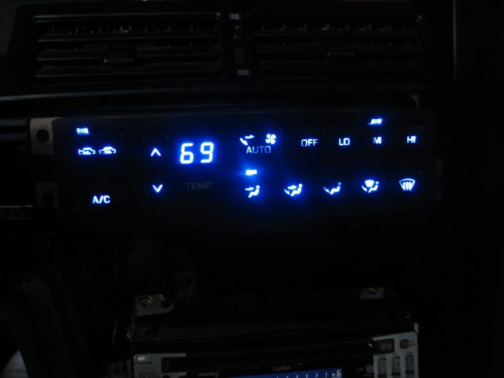

To do the LED replacement you have to carefully open up the unit. Carefully because the clips in side are about 20 years old and brittle. Then after it is open you have to replace all the LEDS. Here are a few that I made a few years ago.
This is my personal first one I made
A few others that were done for some members or friends.
Few pics I found to give you a feel of the task.
