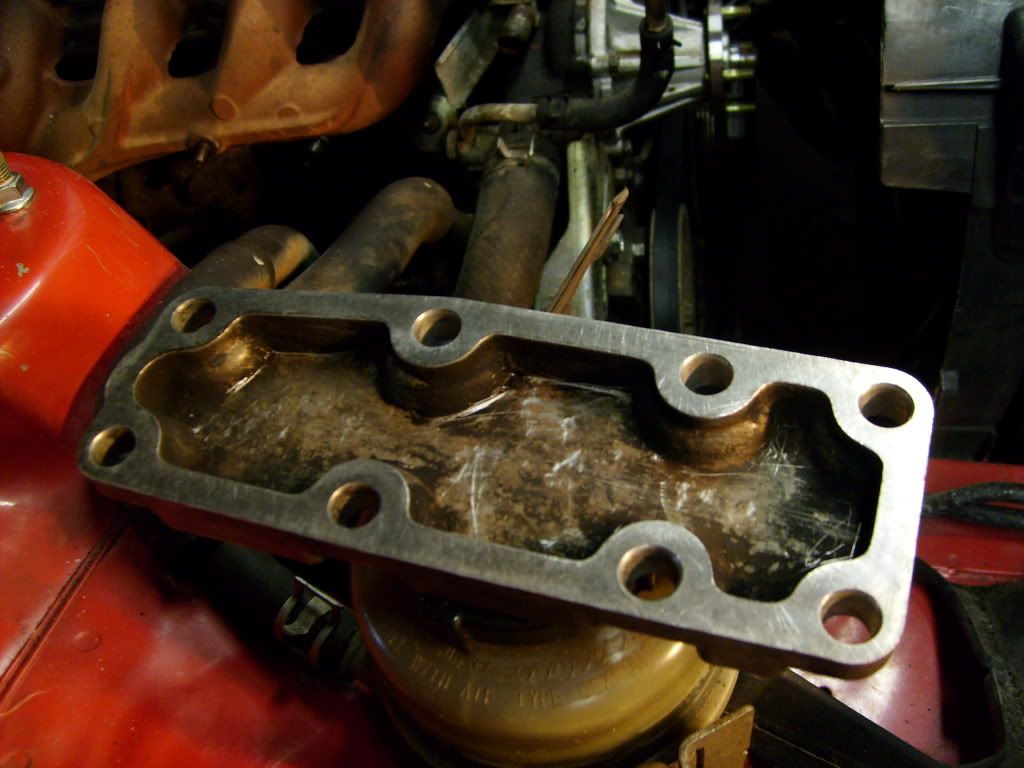

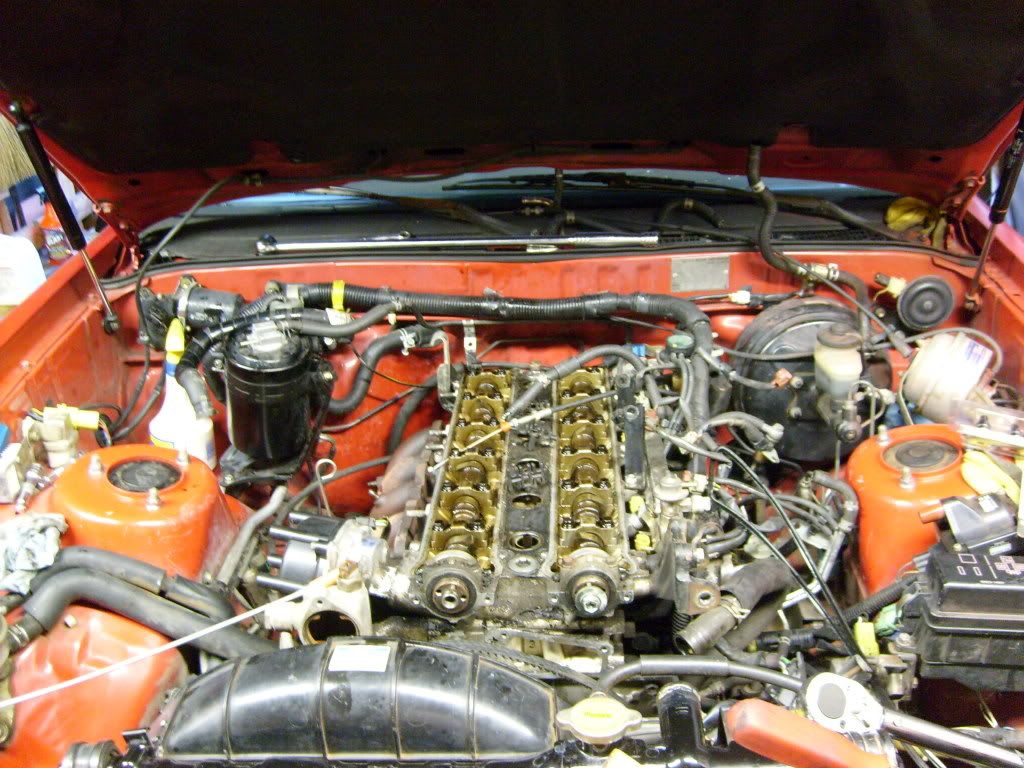

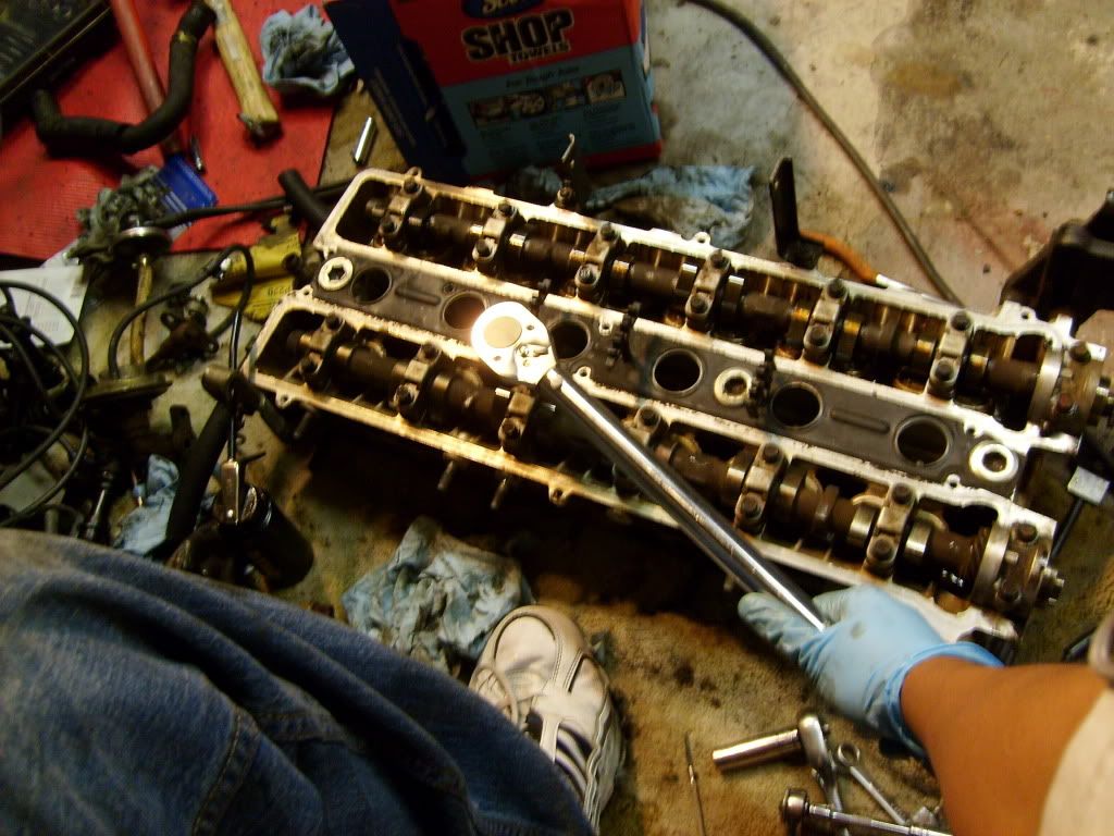

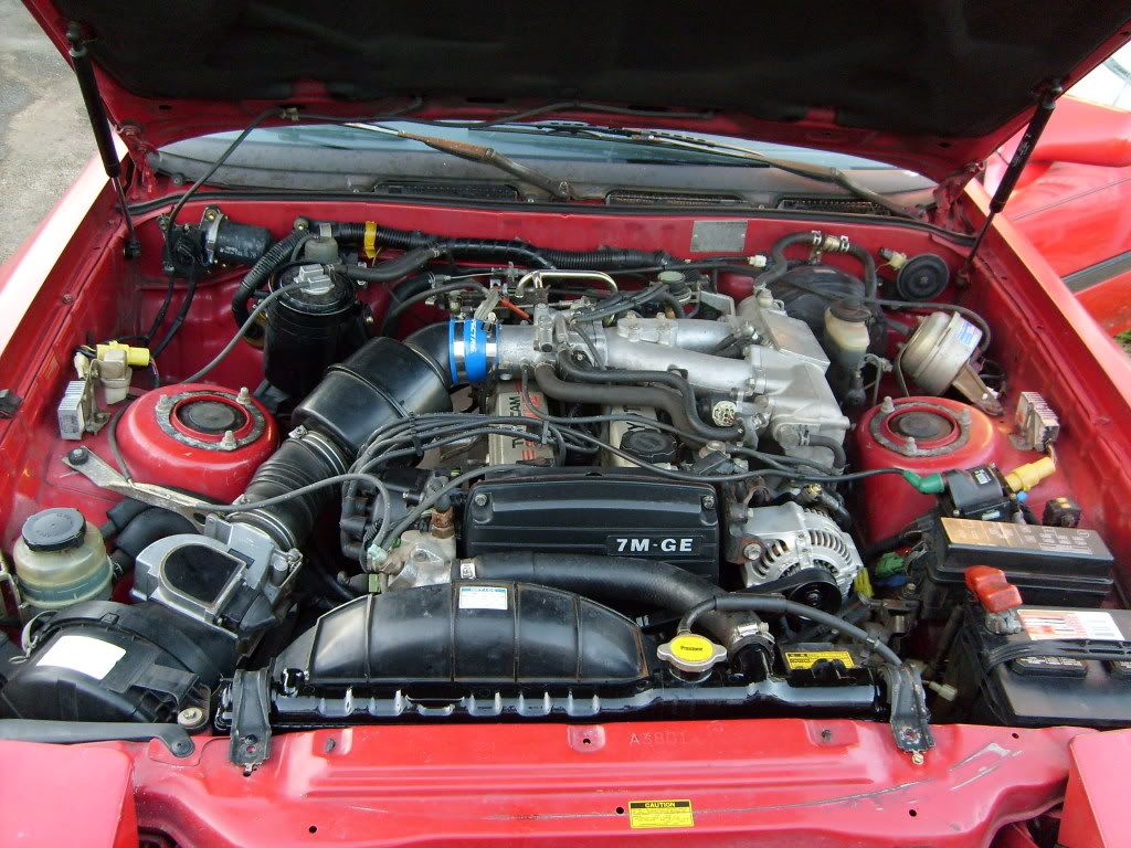

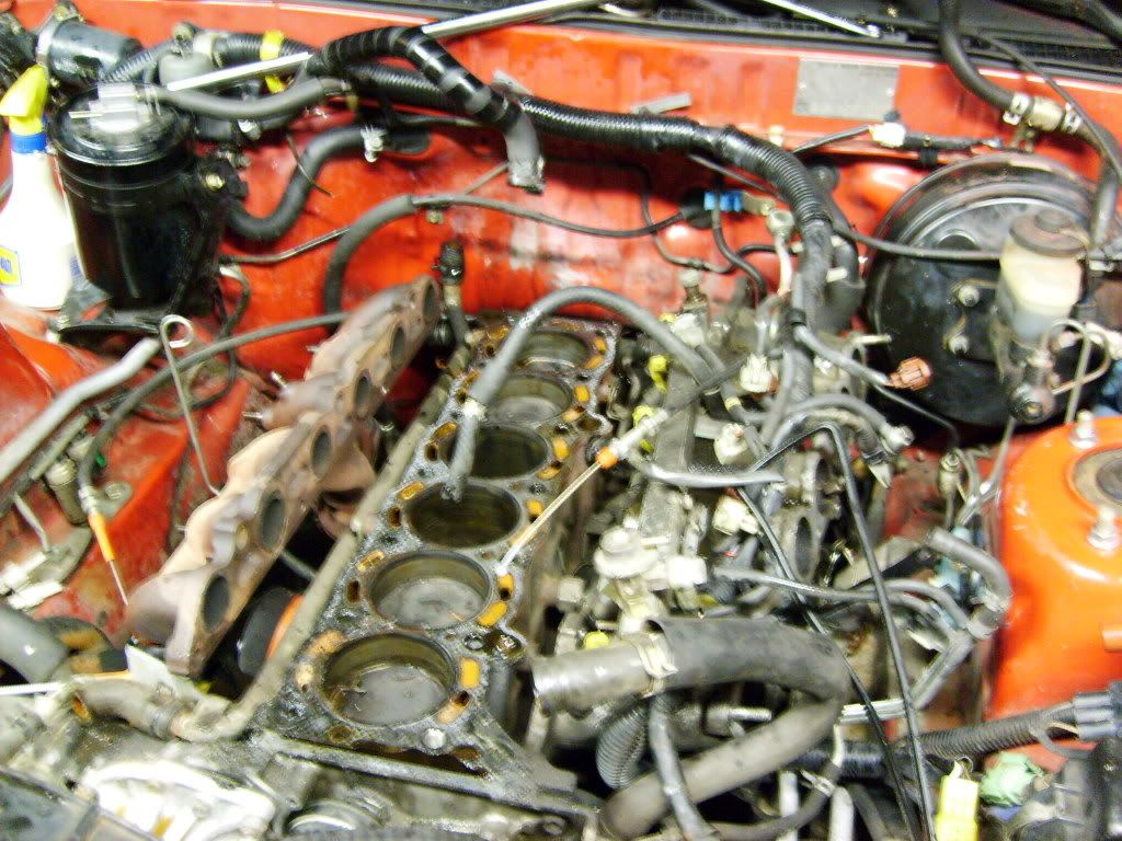

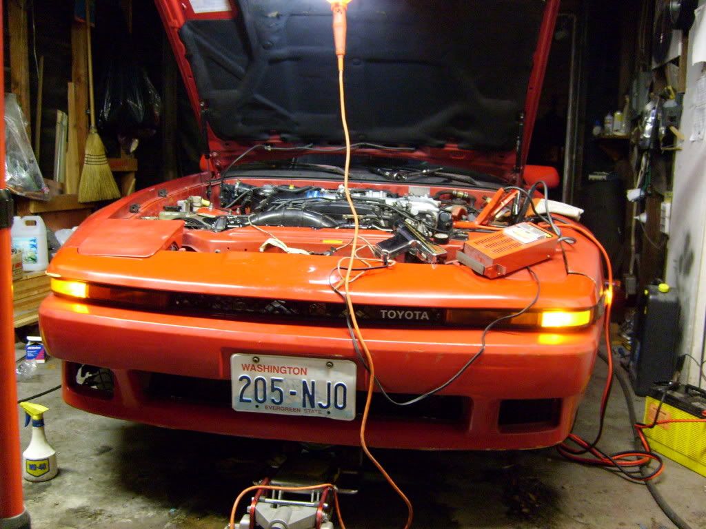

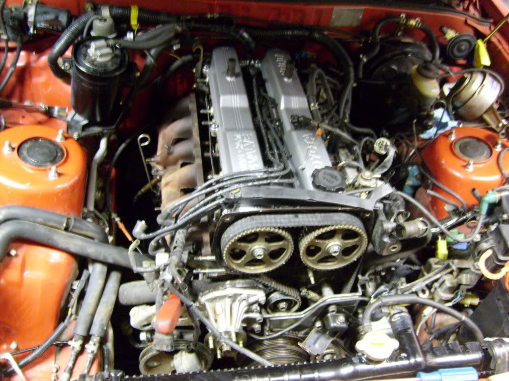

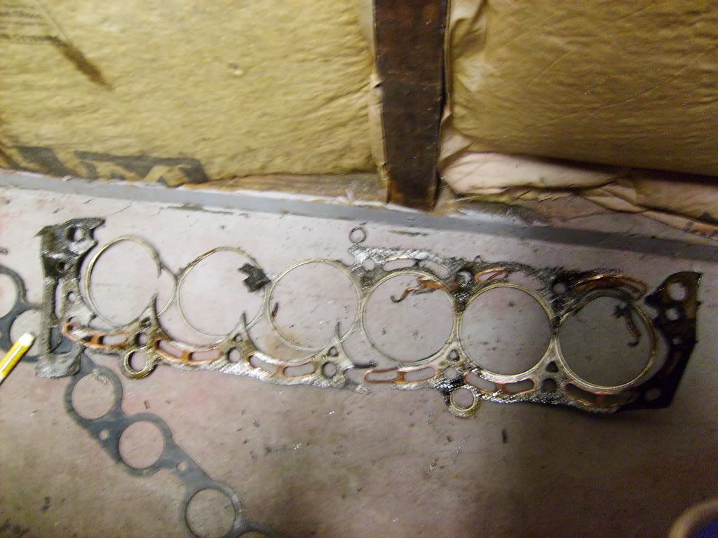

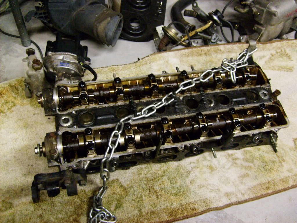

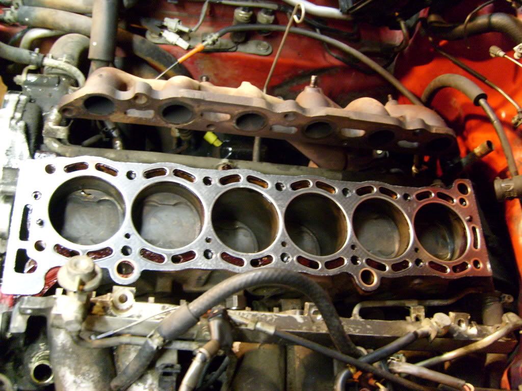

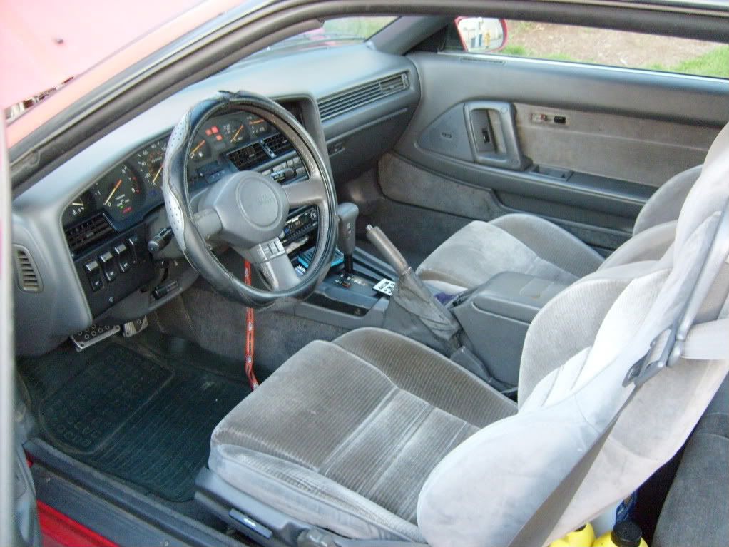

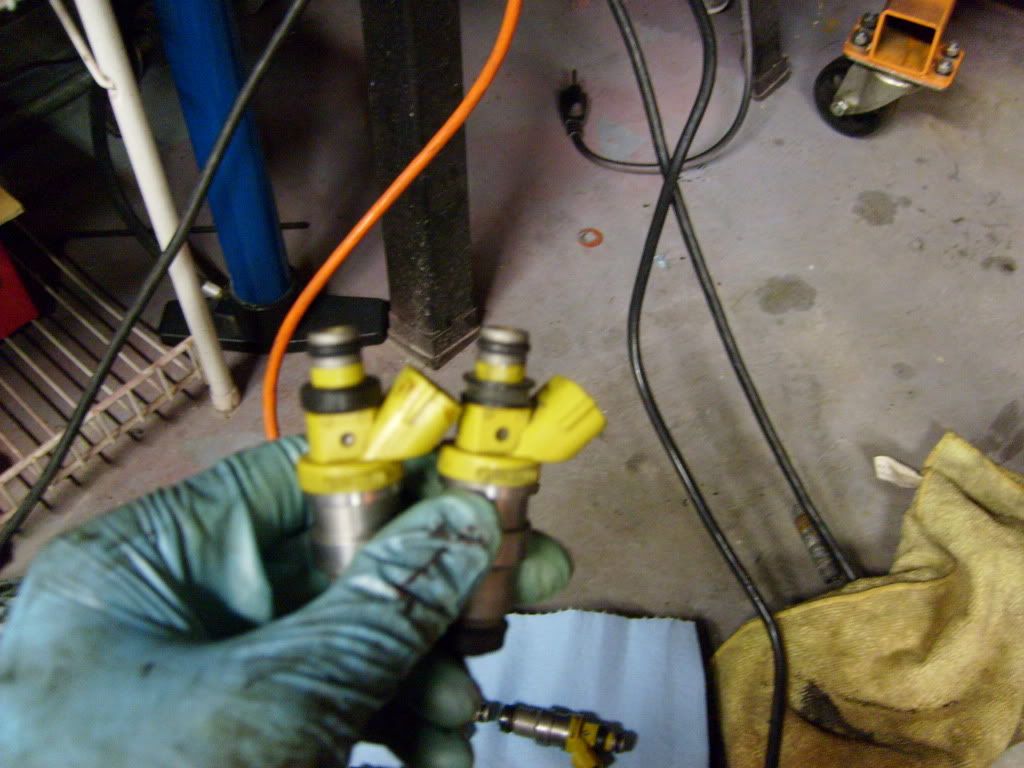

Hey guys, as most of you know i bought a running mk3 for $200 that HAD a BHG and still has a cracked windshield, but now im in the middle of the restore process, here are some pics that i have of it.....

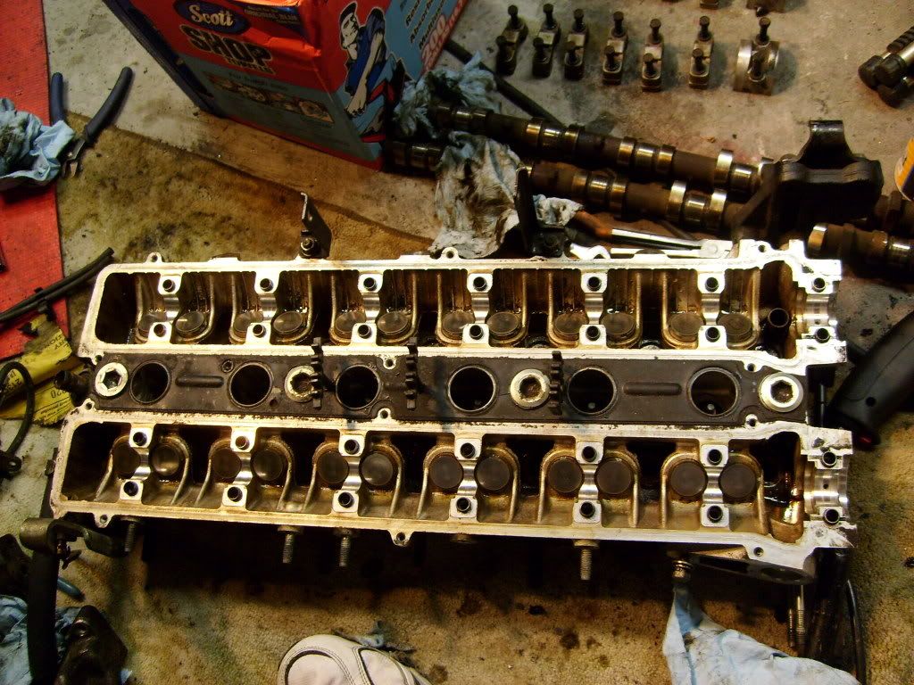

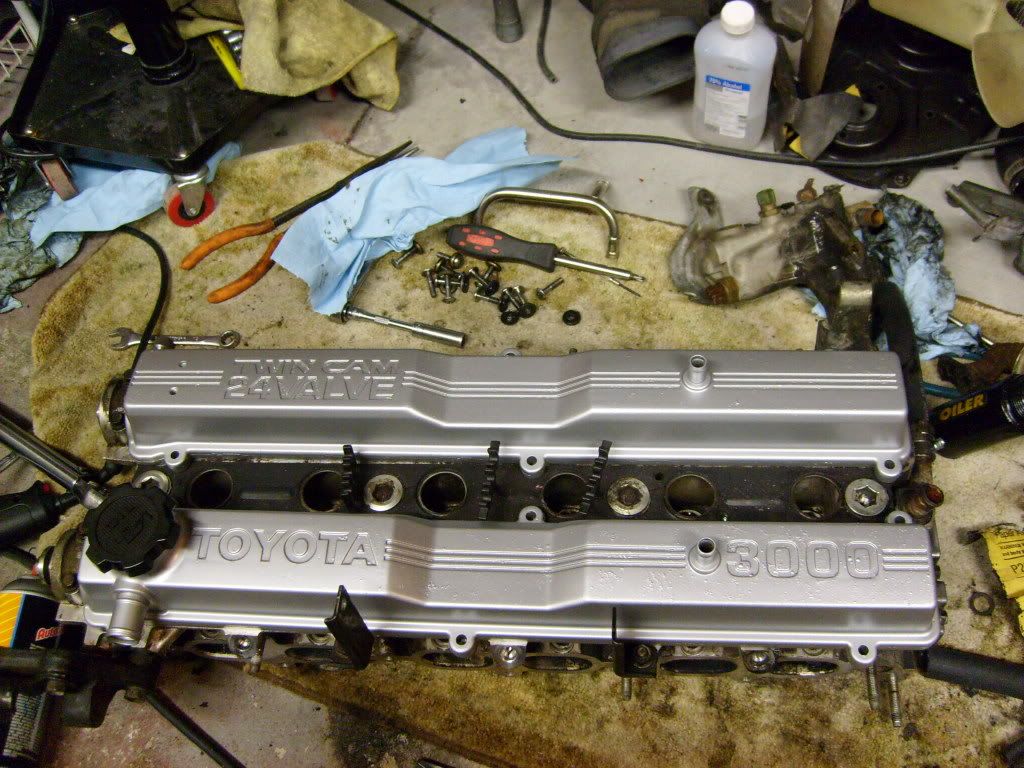

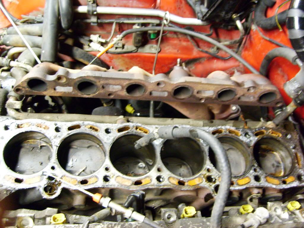

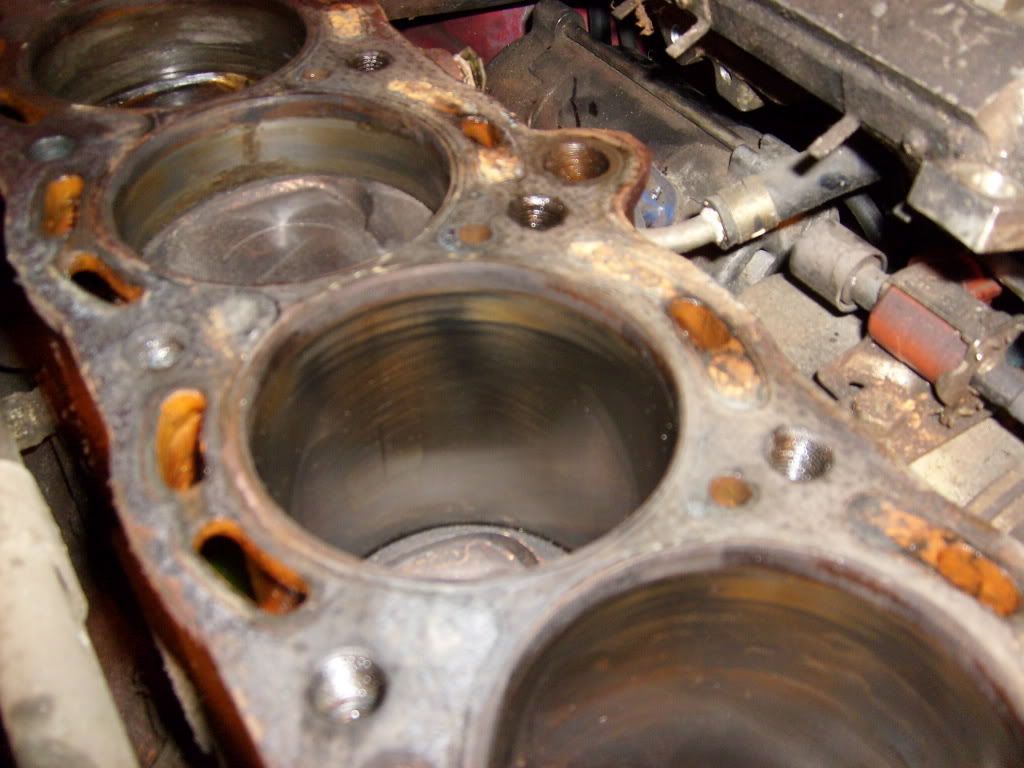

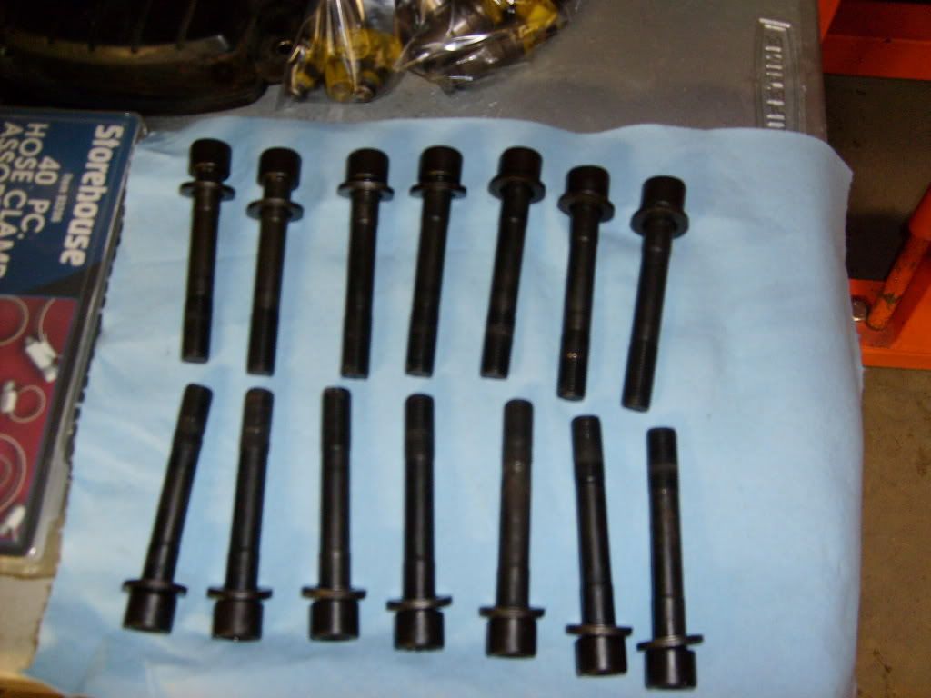

i just have a few questions..
did you get the head and deck checked for warpage?
did you actually use that evergreen headgasket?
what did you torque your headbolts to? (please dont say 55 ftlbs)
looks nice man..
modmonster2008
mod crazy yo!
Sep 9, 2008
1,051
Seattle, WA

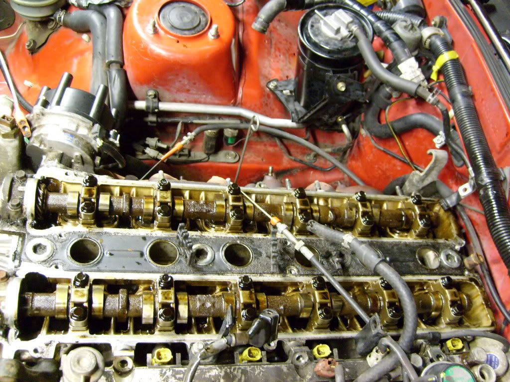

Answers to those questions:
1) Yes i got it checked by a nearby machine shop, they said it was fine they cleaned the surfaces from gasket material and stuff....
2) Yes i did use the evergreen gasket set :)
3) I torqued them to 70+ ft. lbs as most people on here say, the book says 55 ft. lbs but i decided to listen to the people here and it may actually save me from another bhg...

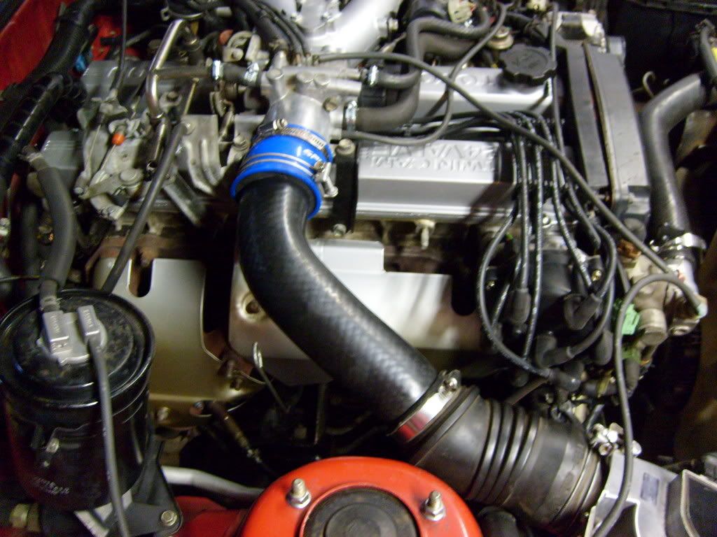

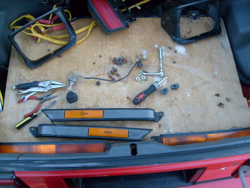

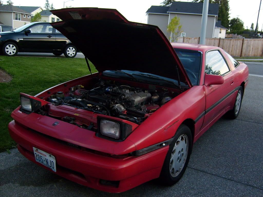

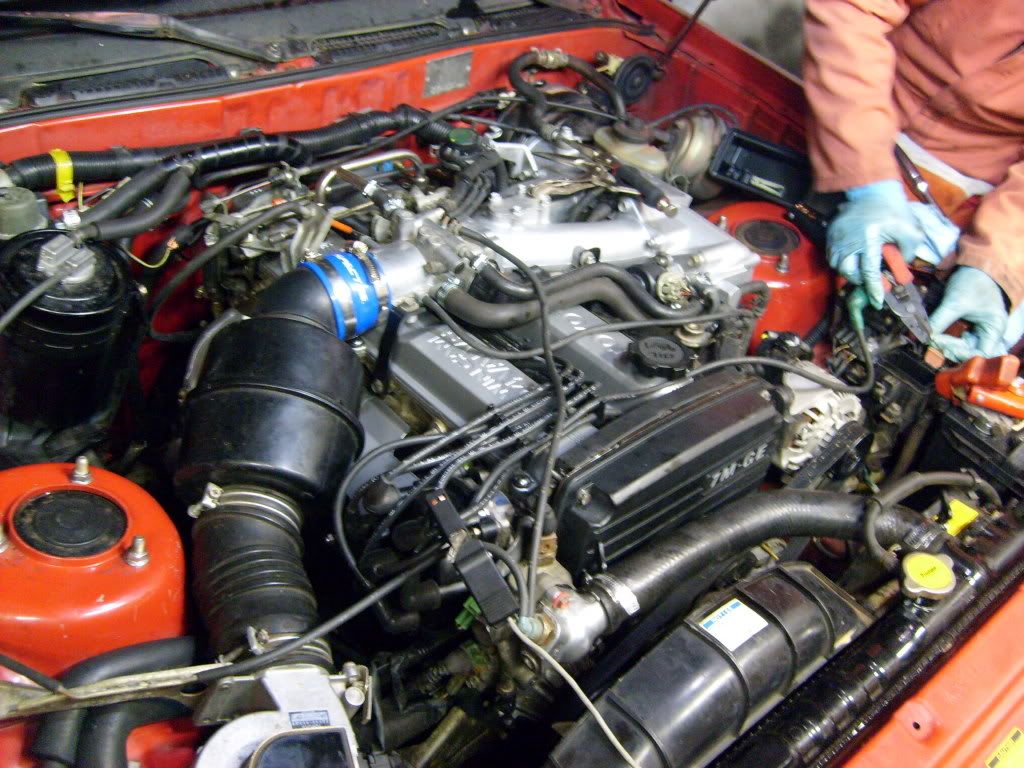

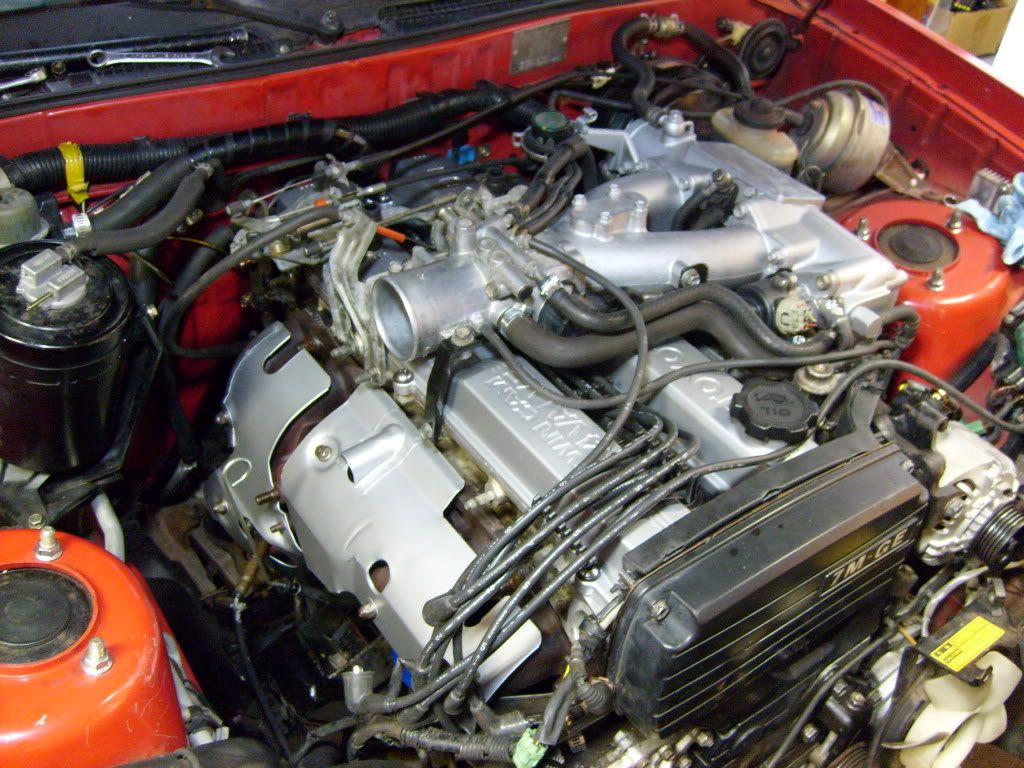

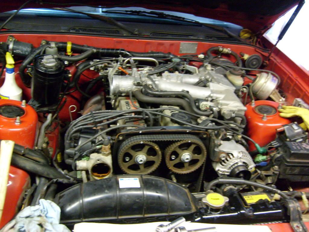

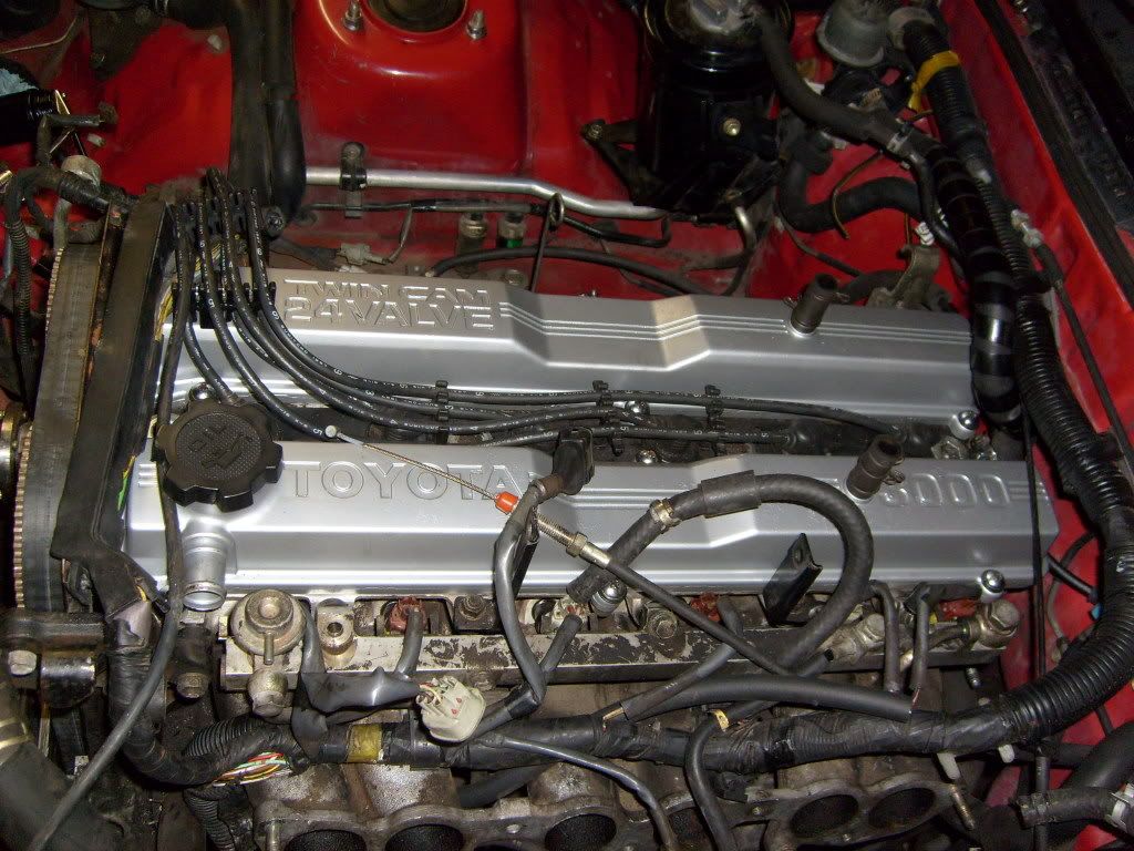

updates for today, aligned the front header panel in respect with the headlights and hood, still need a few more stuff to do to the frame since it was damaged before i got the car, and i removed the resonator from the intake and fitted in a gte tube on there :p

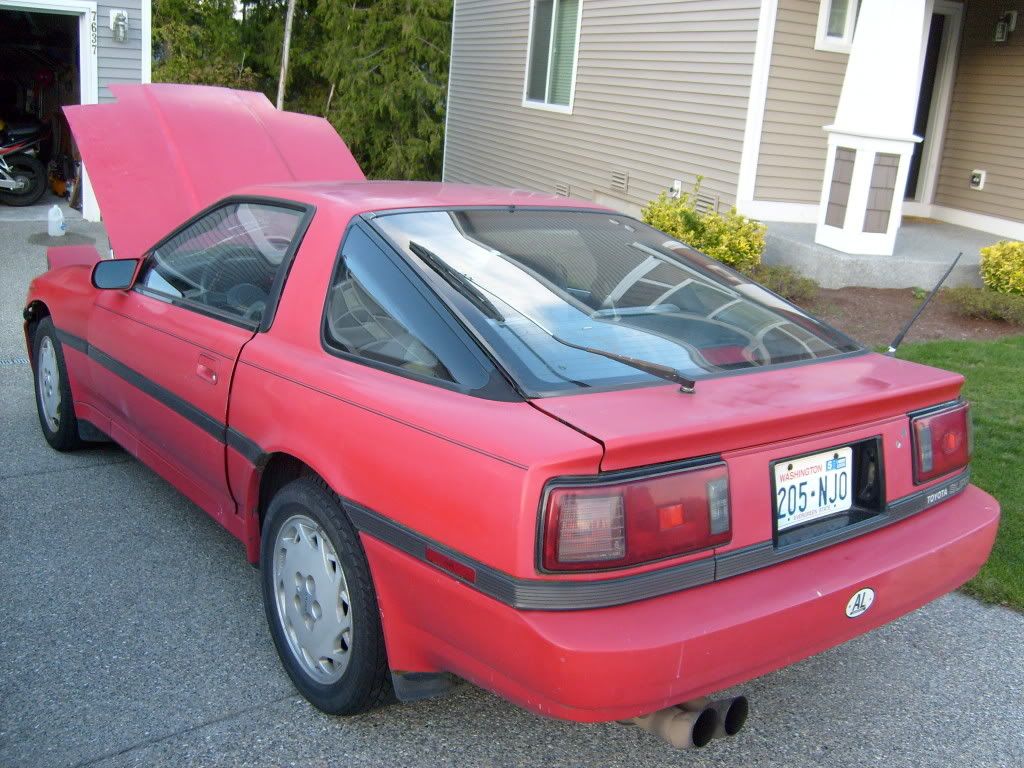

As for today I removed the first muffler and welded a straight pipe on it with a help of a friend and his welder, definately sounds better than before and somewhat feels stronger
video will be up later...
