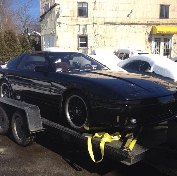

Well after I sold my white MK3 I've been searching around for another one! I had seen this car on Craigslist for a looooooong time! The price eventually dropped to what I was more then happy to pay! Originally I just wanted a shell for another 2jz build but when I went to look at this car I was basically in shock..the guy had NO IDEA what he had! He bought it done! The car stopped running and he couldn't figure out the problem so I bought it and ripped out the hacked alarm and BROOOM! Friggen score!
Here's a breakdown of what it has
"Fully built" 7mgte!
Yellow 680cc injectors that use stock clips(venoms?!)
Safc2
Greddy profec
Blitz turbo timer
Full NOS intercooler sprayer
BFMIC
BIG turbo! (Still have to figure out what it is and what brand!)
Waste gate(also unknown ATM)
That's basically how far I've gotten into it. I don't know what cams,pistons and rods are in it..but it is rocking a greddy timing belt!

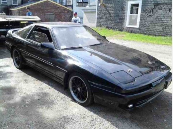

Here's a better picture of the car..this is on the way to the garage

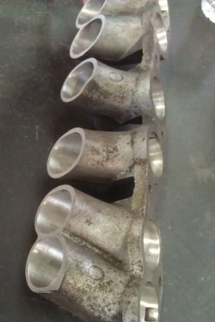

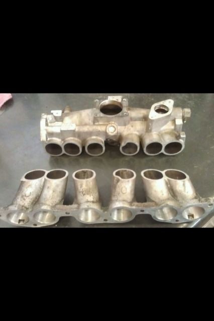

I also purchased some FFIM material :)

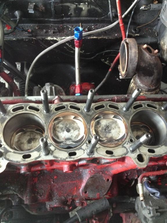

*UPDATE*
I found the reason for the way it ran!
Cylinder 3 piston is a little fucked up..another victim of the venom injectors! -____-
GOOD news is the cylinder is still fine so it should be good with a rebuild!

They have 680cc on the side of the injectors..and givin what happened to the piston in the one cylinder I'd have to say they are

Could anyone tell me if these are NPR pistons?
They definitely don't look to be high quality forged pistons..which would mean there's stock rods -___-
