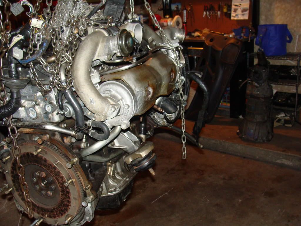

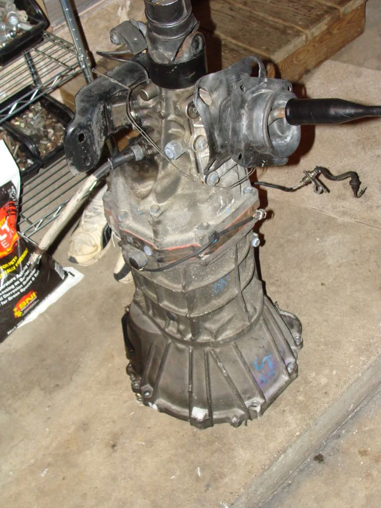

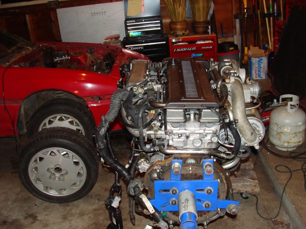

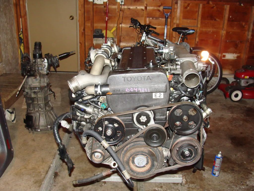

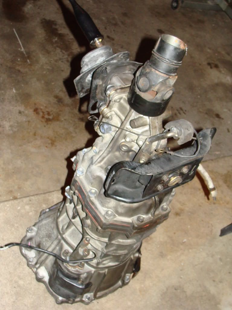

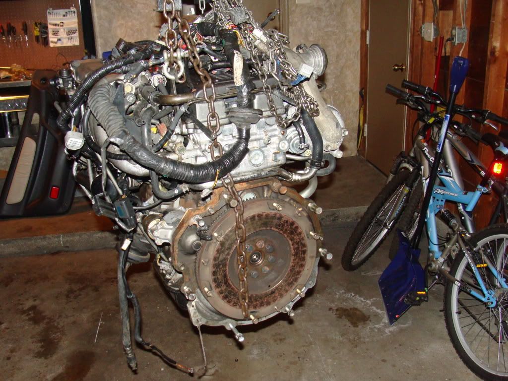

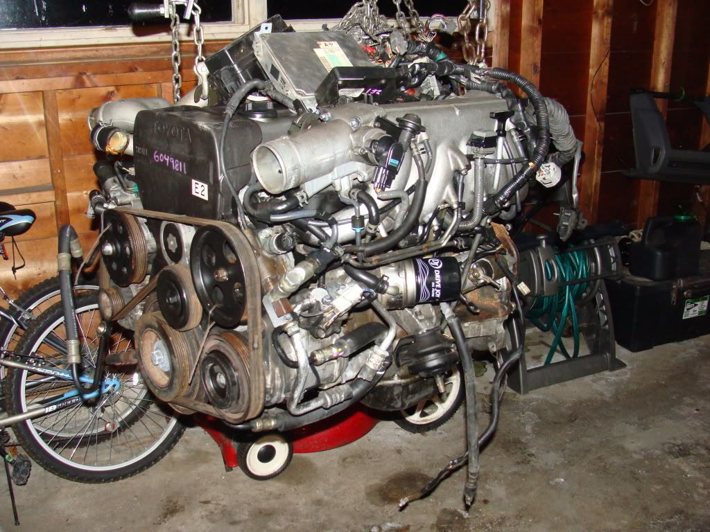

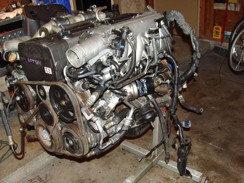

Good news! The motor I ordered is the actual motor I orderded! Seems strange I say that doesn't it? Well it shouldn't. The last 1JZ I ordered for myself was not even the correct setup. It was out of a Chaser; which has a totally different harness ecu and setup. The motor so far looks awesome! I got the motor on a stand now to check it over and go through some basics. I also want to start on the harness.
The cool thing is they gave me the fuse box with the harness as well, and also gave me a map sensor which i find very surprising because these are always attached to the car and they forget. That alone saved $100.00.
Here are the pictures of my getting it up in the air and ready for the engine stand. The motor is also a 2nd generation. This means that hopefully the twin turbos are not bad.
More to come, and I will update everyone on what is new. Clearly the car in the background is not the car it is going into.
