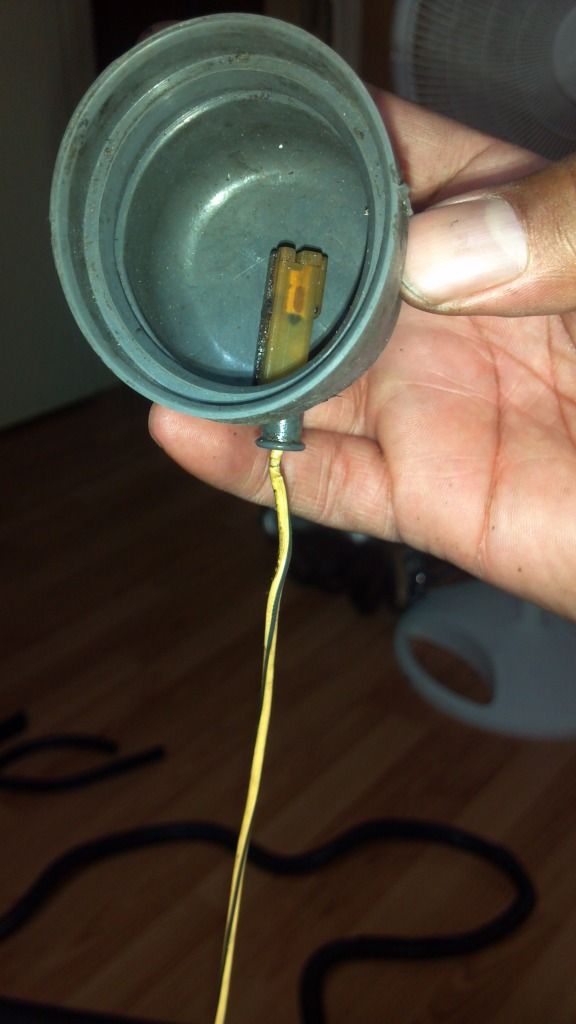

Also can anyone tell me what this wire is? It's yellow with a black tracer. It comes out of the end of the harness with the AFM connector, water temp sensor and oxygen sensor.
