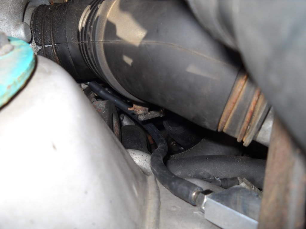

ummmm, what kind of MBC are you running. if its spring and bearing type they dont work backwards...lol. and i too have a crack in my AH, but no issues as seen in this pic

Hallman pro, thats exactly what my hose looks like. lol, it whistles. :D
