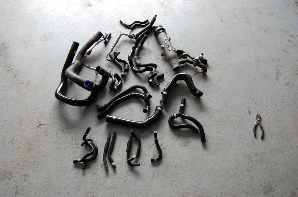

Thanks for the help. Any advice on hoses or just get an ebay silicon kit?

I would recommend OEM Toyota gaskets and valve stems seals. I would also use only Toyota hoses. Yes they cost lots of money however they fit correctly and last a long time. I bet a lot of stuff on your car are OEM at 20 plus years old. A lot of people say I am "stupid" because there Fleay bay stuff works just fine. I ask how many miles have you put on them> usually it is still a garage queen., not a road king. On a budget I would go the gates hose set that Driftmotion sells. All IMO.
It makes no since to spend a lot of time and money to cheap out on important stuff. These items are budget busters that most people don't include.
A month or so ago someone lost a turbo on a new rebuild due to accordion hose came apart and destroyed new turbo. Look at how much money he "saved" by not replacing a hard brittle hose.
Yes you should change out all the fuel injector seals and "O" rings that come in the overhaul set. And put in new "crush" gaskets when you have a fuel item removed. And again all of these comes in the gasket set.

Thanks super. Decided I'll call DM and make sure their gasket set has everything I need. I'm not sure how you can afford paying thousand dollars or so just for coolant gaskets and turbo gaskets and hoses. We asked toyota for just several gaskets on the water hard lines and turbo and some coolant hoses, they wanted almost 400.
Silicon hoses don't age like the OEM ones, but obviously don't work well with gas or oil. I'm going to see what hoses I can keep using but I might just end up getting an ebay silicon hose kit (I know someone of it probably won't fit perfect) and then some extra hose for vacuum lines. Or maybe just reuse what I can and buy the main radiator horses that are most costly and are basically a rock now. Wouldn't mind the cool dressup of blue hoses but if it doesn't even fit what's the point...

These were the hoses... http://www.ebay.com/itm/Silicone-Ra...7MGE-7MGTE-7M-GT-86-87-88-89-92-/281154807077

I bought the Ebay silicone hose set a couple years ago and they've been working fine for the last 12k+ miles. There were a couple random fit issues with some of the small hoses, but I was able to get everything to work.

Just a word about vacuum hoses... make sure if you go silicon, they don't collapse when heated. Silcon tends to be a bit more flexible and I was noticing a couple of mine shrinking under vacuum. Not really desirable .
