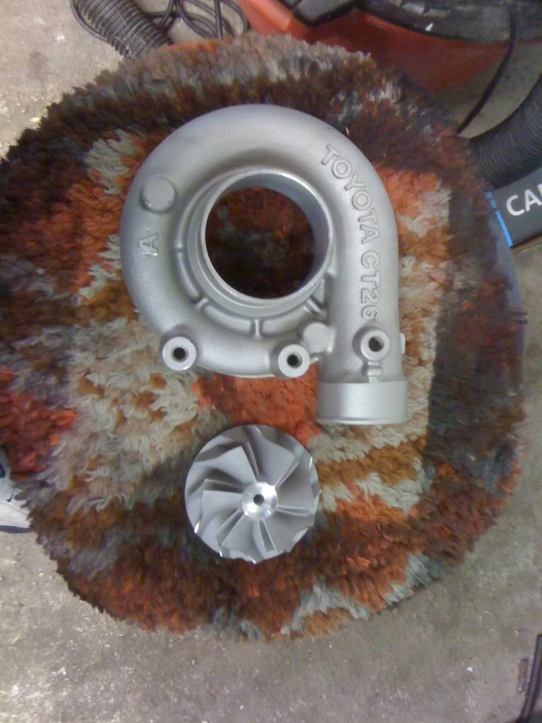

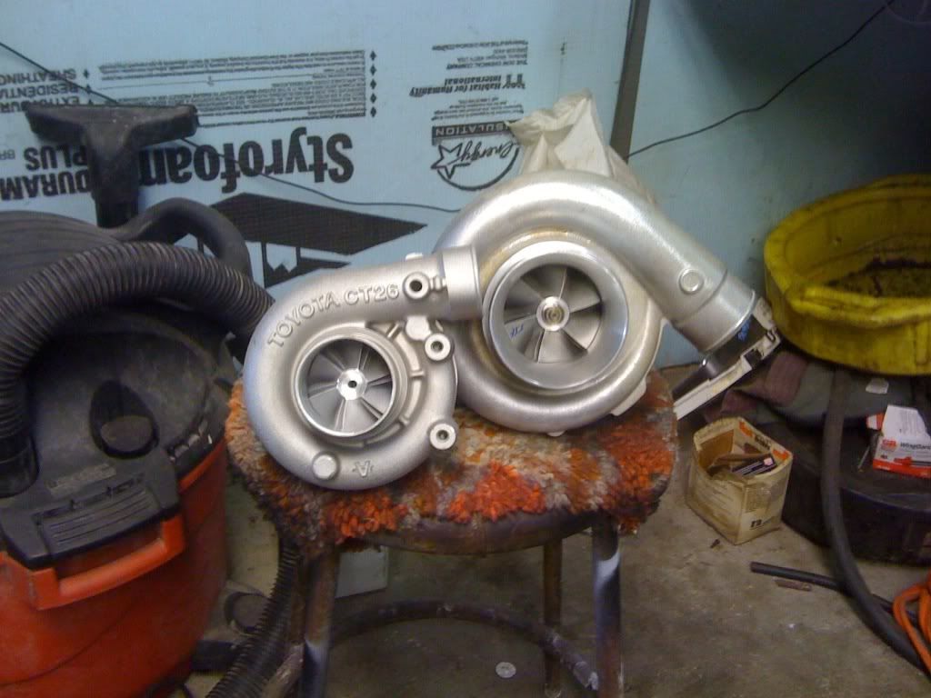

Sawbladz;1440268 said:
Sweet Jesus! That is a MASSIVE compressor wheel for that CT26 turbine housing. I wonder how well it would deal with surge.
Probably like any other huge wheel in a tiny housing, it won't.
