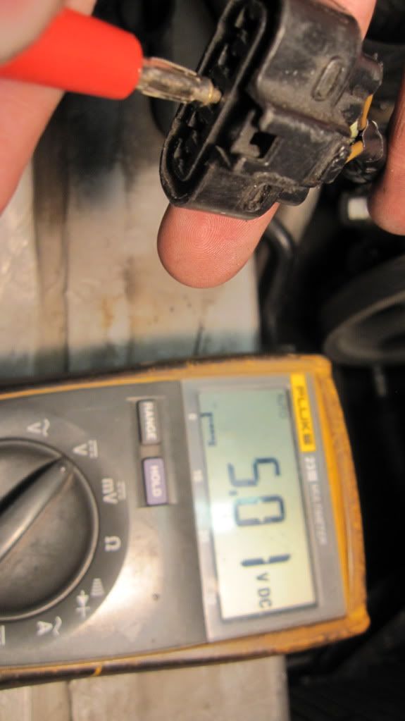

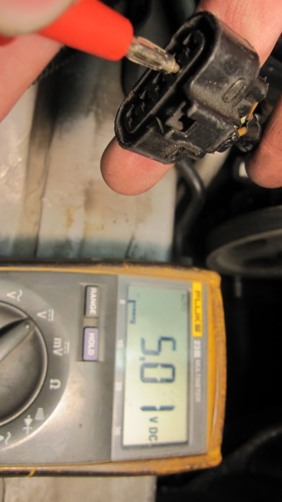

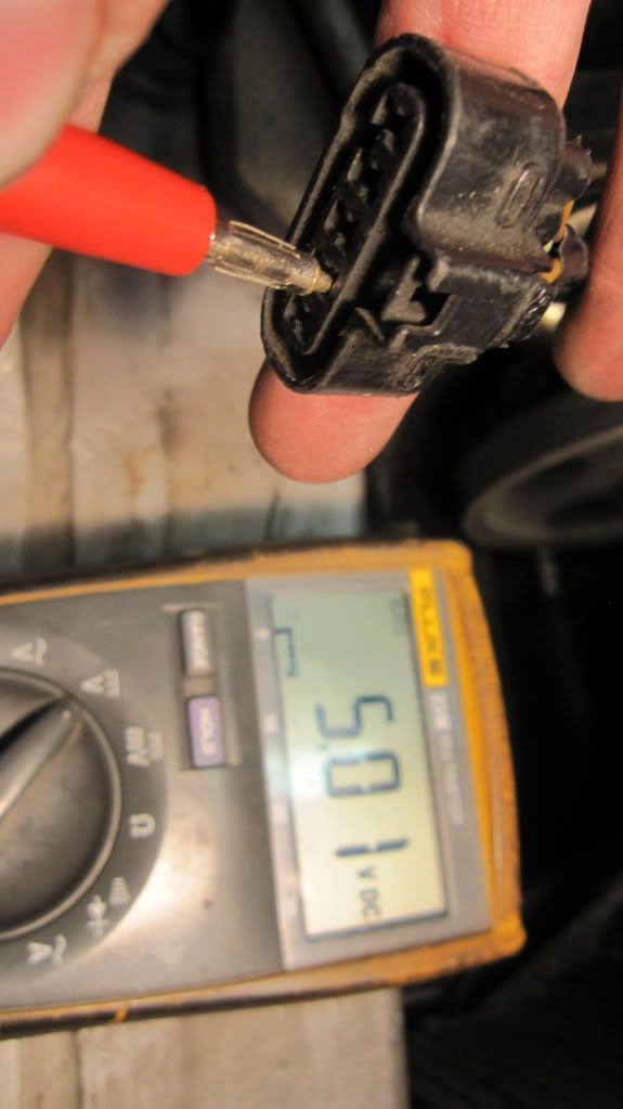

Here are pictures of checking the 5 pins on the AFM plug with a DVOM
E1 (continuity to ground)
VC (5.01V)
KS (5.01V)
THA (5.01V)
E2 (continuity to ground)
Does this sound right?

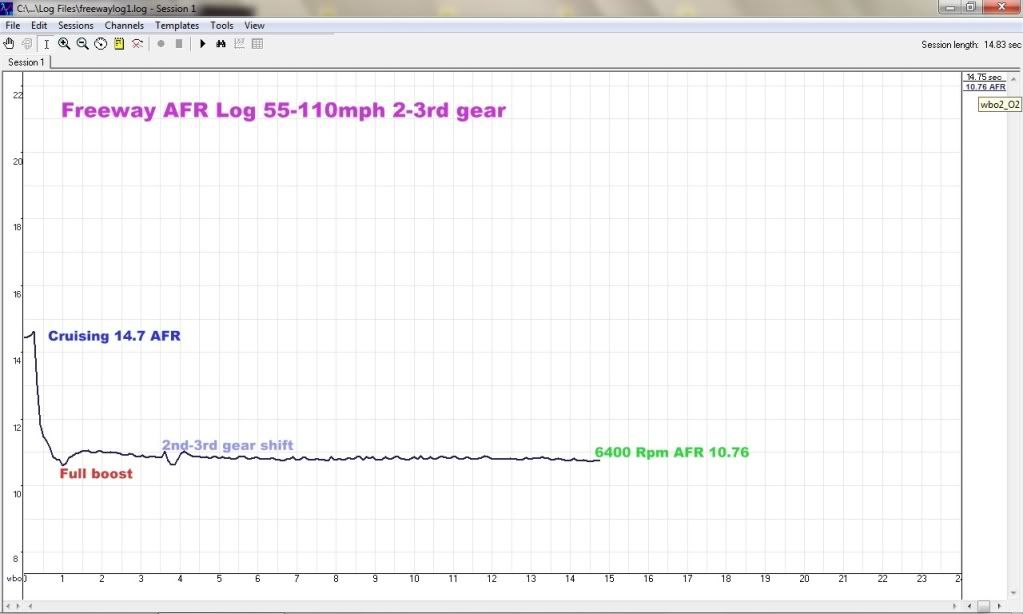

Got it figured out today! It ended up being the SAFC.. I unhooked the wire that taps into the AFM wire and bingo perfect AFR's all the way to redline! I couldn't believe it and after all the diagnosing, well at least it paid off and narrowed it down to that one last thing! Here is the AFR log
Highest AFR ever went under full boost was 11.05 that was when it shifted from 2nd-3rd gear
WOOHOO!

That's a curiously flat trace, last time I saw something like that on my car it wasn't properly regulating fuel pressure.
