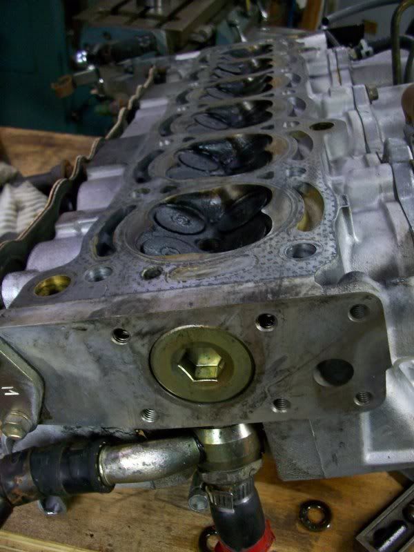

i bought a JDM 7mge engine last week and did a compression test. the pressure is between 226 and 236psi. this is a long block with no belts on it and only a auto trans flex plate. is the lack of draw from the accessories why its reading so high?
i have the head off now and dont see alot of carbon build up or any thing major. the engine is preaty clean on the inside and outside.

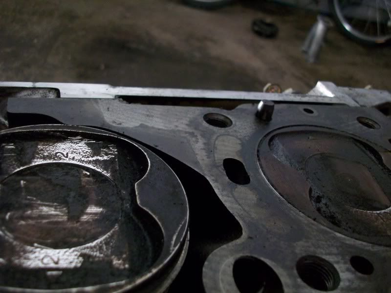

sorry for post in the wrong section. i have another blown 7M and that piston looks a little more concave. is there a high and a low compression 7mge?
the pistons look factory as well as it having a toyota timing belt.

i read more on the service manual and they are #2 pistons. by the look of the other piston the JDM piston would raise compression.
not sure on the head dome size.
head dome size is .630 on the JDM head in the flat spot in cyl #6 and .637 in the US head. the difference could be from carbon though.

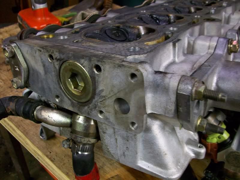

looking closer at this head the EGR is removed and cooling block on the back of the head is not there and looks like it hasnt ever been there, that could be just a jap spec thing i guess.

i can see a difference between the US piston and JDM piston tops. they both have two #2s on them the JDM one having larger numbers.
would a aftermarket piston usualy have different markings on the top of it?

JDM piston is around .082 dome and US is .113 dome.
just measured both blocks and there within .0010 of each other. i guess i will be pulling the oil pan tomorrow and taking a look around inside.
