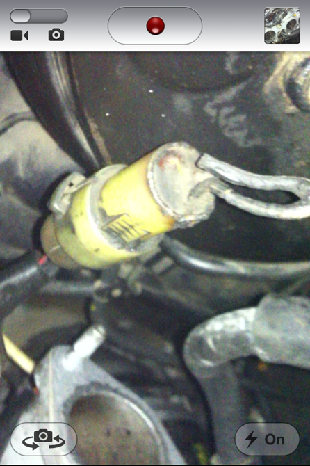

Not sure I really understand these responses. Yes going to keep the w58. We have a better ACT stage 3 clutch for it to hold the extra power. Going to upload a pic now of the computer's area. There was a few things unplugged so I don't know how toyota did it. If they had the auto and manual plugins on the same harness and different ones plug into diifferent computers?
So you guys are saying this ECU will be fine everything will be plug and play? Only with the idle jumping a little when I push in clutch? What do you mean bypassing NSW I've got really no idea when it comes to wiring. THe only thing I"m conerned with is backup lights if those will still work correctly.
