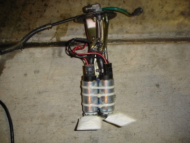

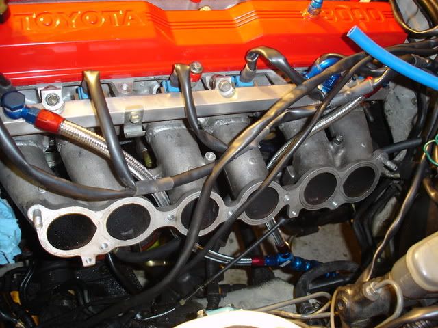

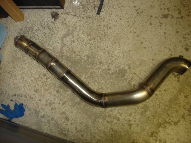

Here is the pics of the 7M Ive been working on lately. It belongs to Nate (80ssuprapower) on the forums. We worked all weekend finishing it and finally it runs. Hopefully well get the ignition buds worked out with the haletech soon and post some #s

3.5" 316SS downpipe (stock catback )

Hybrid 7m/2jz intake manifold
70mm Ford throttle body

Dual Walbro GS341
-8AN from the tank to dual -6AN feed
780cc PTE Injectors
