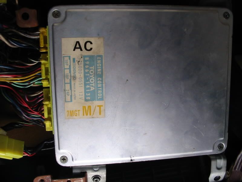

MA70witBoost just post a pic of your ecu then we will know for sure if it can or not cus I also doubt its possible but hell if the guy only has a na one and it was running then it may be possible lol

i'm willing to bet it's just confusion. the GTE ECU says 7MGT on it, which could be easily confused with 7MGE ;)

Post the part number and/or pictures, and I can confirm what it is.
A 7M-GE ECU can't control the 7M-GTE's ignitor for DLI, has a different tach signal, different CPS, different air flow meter (that one is HUGE difference).
The N/A AFM literally outputs the 200% opposite of what the Turbo AFM does. There's a different number of wires, different wires do different things, etc.
The 7M-GTE has an extra knock sensor, and a 3-wire O2 sensor instead of a 1-wire O2 sensor.
The injectors are a different size and impedence (impedence for 89+ only).
Finally, after all that, the connectors are different, they have a different number of pins, etc, and they are not shaped the same, the Turbo harness won't plug into an N/A ECU. Turbo connectors have 26, 16, and 22 pins on the 3 connectors, N/A connectors have 10, 18, and 24 pins on the 3 connectors.

maybe his car is an na-->T and he's still on a distributor + N/A electronics...

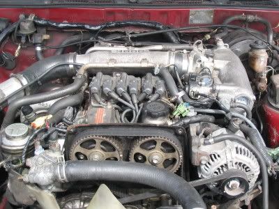

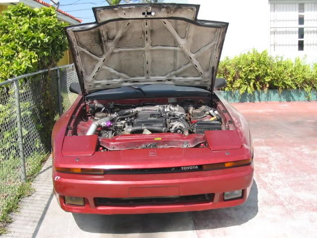

post pics of your engine bay, too!

i dont believe it until i see proof... i'm not questioning anyones credibility, but read jeff's post...

The ecu cover is removable, it got switched. As stated before, the car would not run with a 7mge ecu. And it does not run now so something is obviously wrong!

I've stayed out of this because the answer should be obvious to anyone even remotely familar with the EFI system on either engine. For the record there is no way a N/A ECU will run a 7MGTE. Jeff's post is only the beginning but the DIS and AFM issues alone make it impossible. No doubt there is a logical explanation but it isn't a N/A ECU running a GTE.

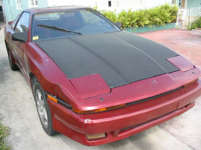

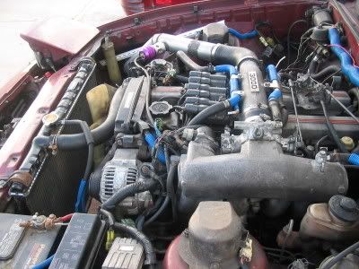

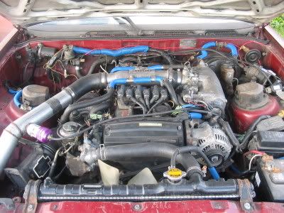

Ok... My mistake... Shaeff, your right man. I dissassembled the glove box to take the picture for you guys and it says GT as opposed to GE. My mistake, Sorry guys. :nono: I promised pictures of the ECU so here they are... Im also throwing in some engine bay shots and a whole bunch of pictures of the car. Some might be big but not all... My sister keeps resetting the digital camera to 1024 by 768 pixles :icon_mad: . Some are shot in 640 by 400 so it shouldn't be too bad.

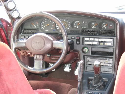

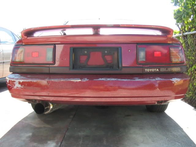

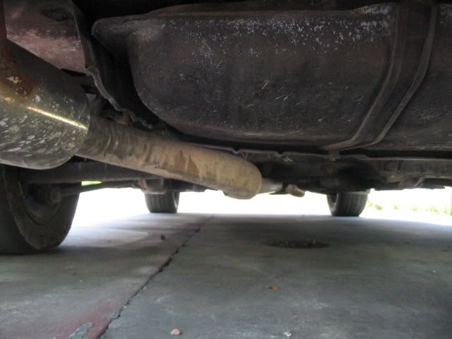

These are pictures of how the engine bay was when I first bought the Supra back:
This is The Supra: :biggrinki
The long awaited GTE ECU (my mistake!) :kaboom:
Oh, This is the engine bay now in its current state:
Opinions on the Supra are welcome. Right now its just sitting in my driveway. Its waiting for its new parts. Motor's electrical was a mess befor, I know. My boy put $7000 into the motor to get it running good (ie. MHG, Upgraded CT-26, BOV, Upper Intercooler Hard Pipe, etc.) But neglected the rest of the car. Its my duty now to finish it off. Oh well.

Stuff happens. Jeff's post is valid other than the O2 sensor isn't a showstopper and the high impedance injectors would only require removal of the resistor pack but there are many other issues that'd prevent it. One might argue the engine could possibly run in limp mode with a "bad" AFM but, as noted, the GTE's DIS can't possibly be run off a N/A ecu. The signals don't exist for it. Not to mention the firmware is completely different.
