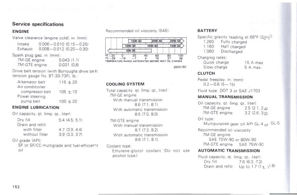

This is what Toyota recommends:
Some of the 50 weights are in there. However 5w-50 isn't It might be a little on the thin side. Probably not a big deal ggeiss240sx, but at the next oil change pick a different oil. I'm running Mobil 1 extended performance 15w-50. works pretty good for me. But you may want to take malloynx's advice and run something a little less thick in the top end, at least during winter.
