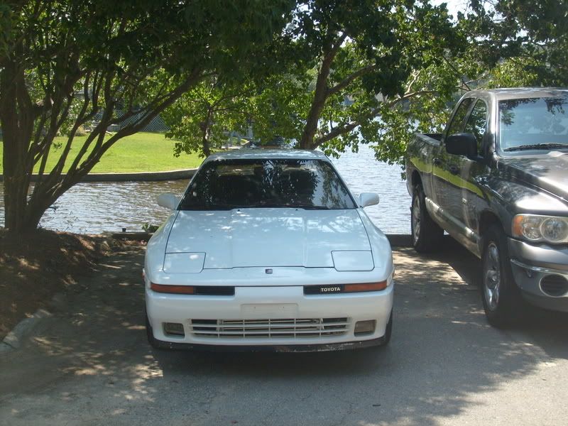

*has anyone ever bought leather seat covers from leatherseats.com ? i'd like to completely redo the interior. i need to replace the cracked dash and some other pieces. i'd like to have a gray interior with black leather seats and black carpet. oh yeah, where was that place that made new carpet for the MK3? one more thing, how can i get ahold of the aluminum piece that fills in the hole over the intercooler hood latch area? i'll try to find some pics of it. i also need to find some high quality coolant line caps. the ones at the auto stores are crap and can't handle the extreme conditions, thus resulting in a huge coolant leak leaving me stranded.
http://www.youtube.com/watch?v=_k32ZiMtI1k
where can i get the piece that covers this area in the white circle?
*using my old 87 i sold, as an example... i miss her :(*

good to see you're keeping the supra and fixing everything. we'll have to get together soon once my supra is up and running, which should be soon. you can get those intercooler/radiator block off plates at 935motorsports or suprasport.
