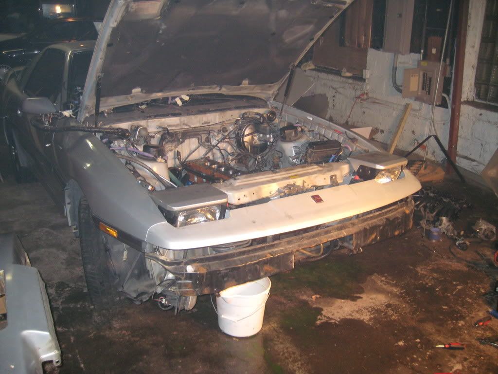

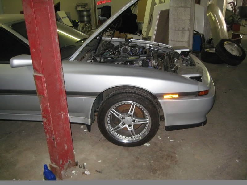

Started to gut the old performance parts out as they are listed in my for sale thread. Took out all the IC piping and started cleaning up the engine bay a little bit. The bay will be really condensed and wires tucked when the other motor comes out.

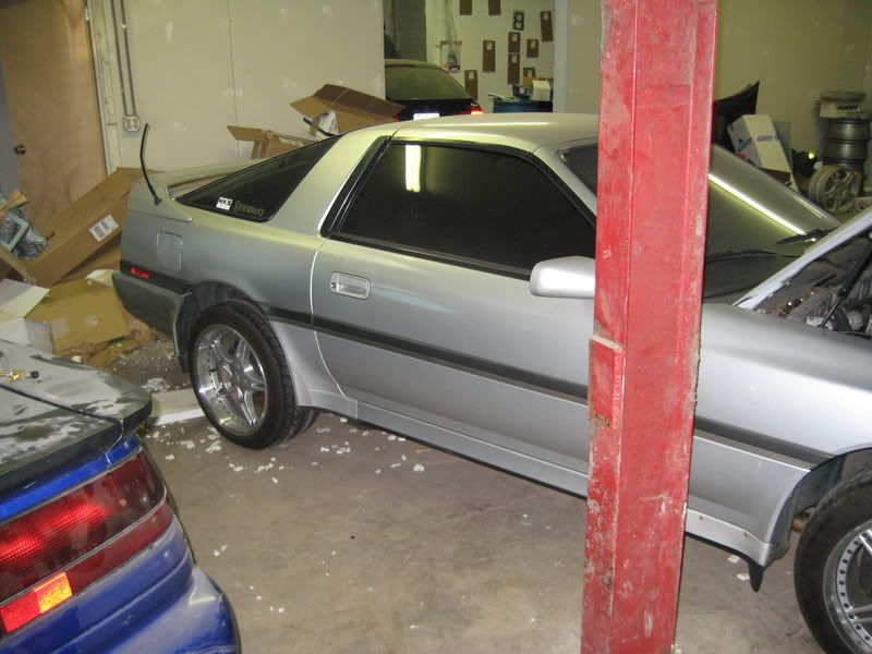

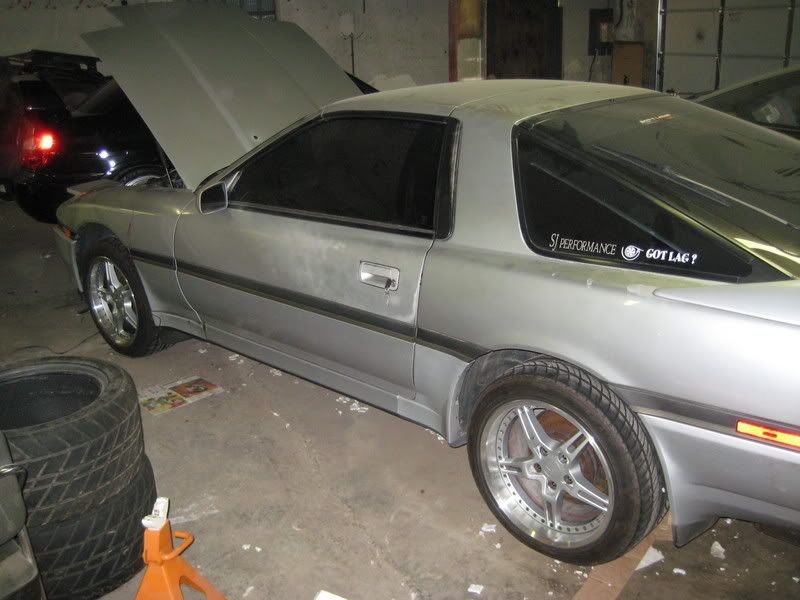

Update:

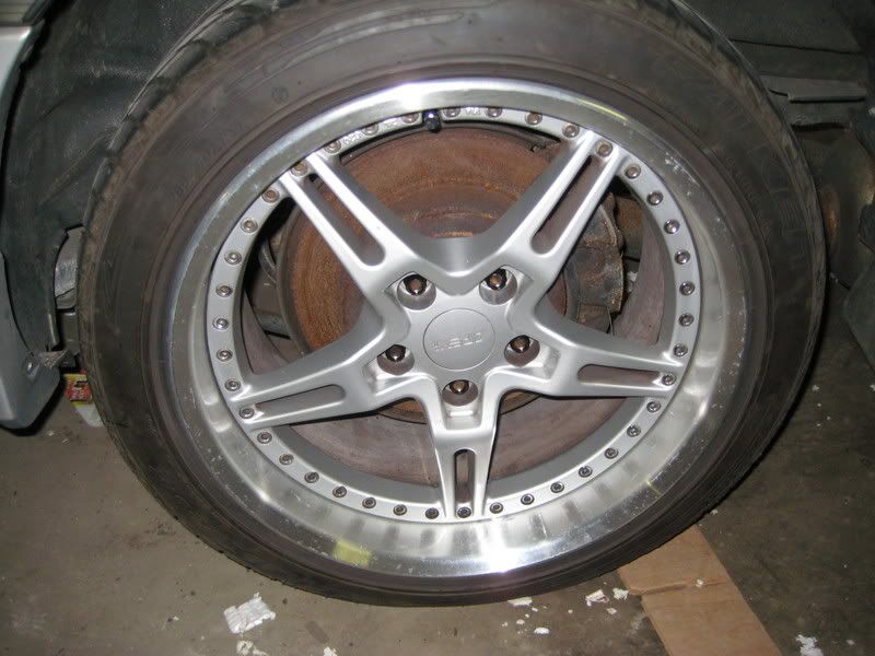

Got my new rims put on today and the car definetly needs a drop.
Took my exhaust manifold and wastegate off for inspection and paid the balance on my new motor.
Pics
againstdawall06
Dec 8, 2005
298
mo
How big are those wheels? And ya, it def. needs a drop. Im riding on eibach/kybs so hopefully my wheels will look good with it.

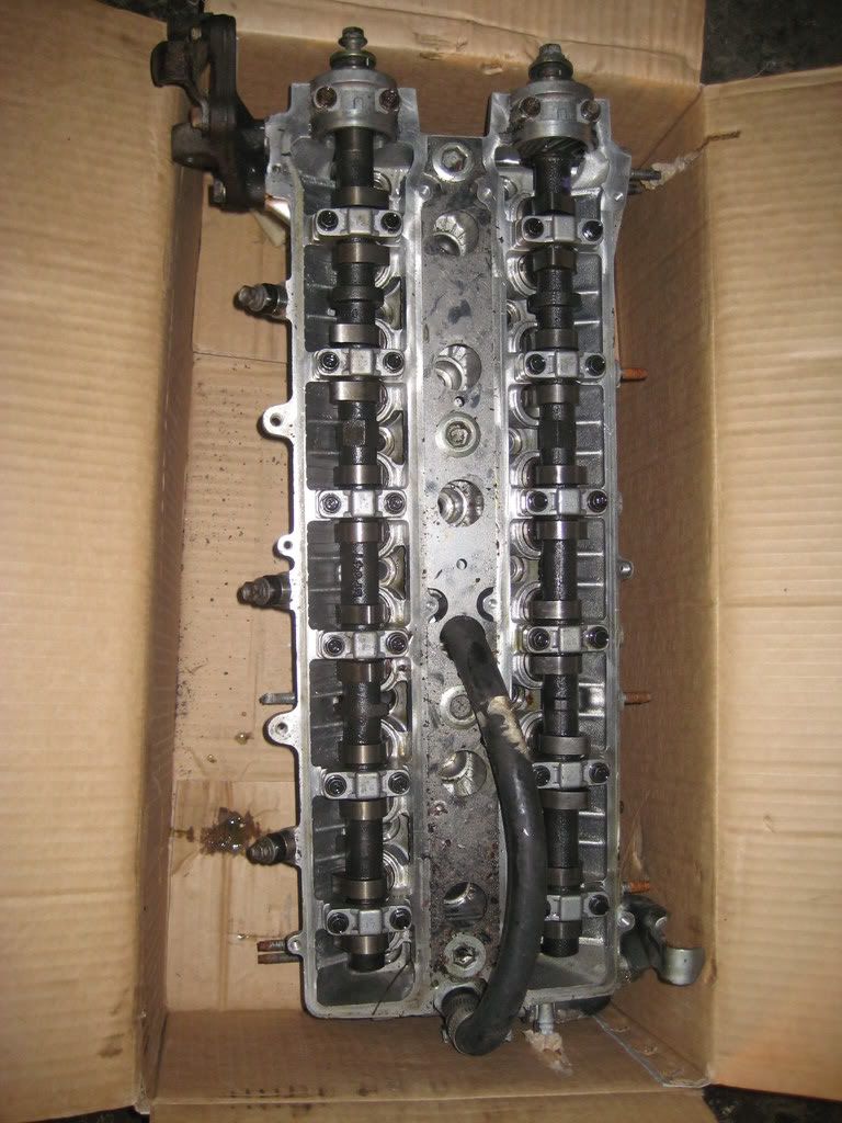

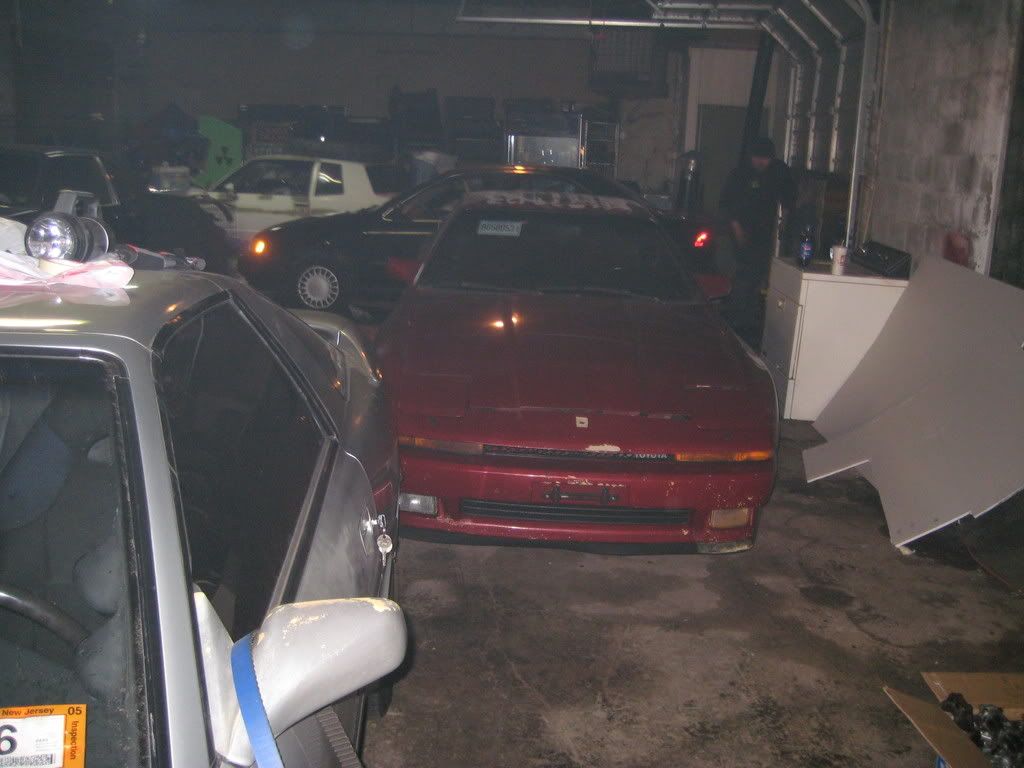

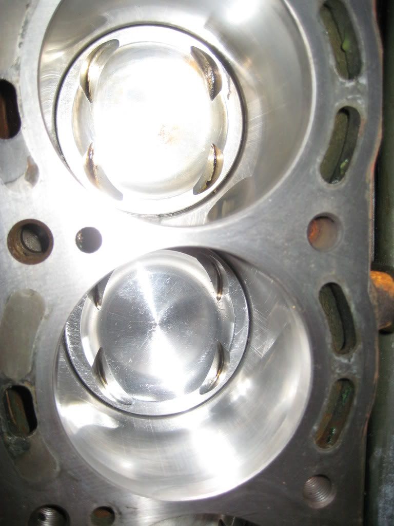

Update:

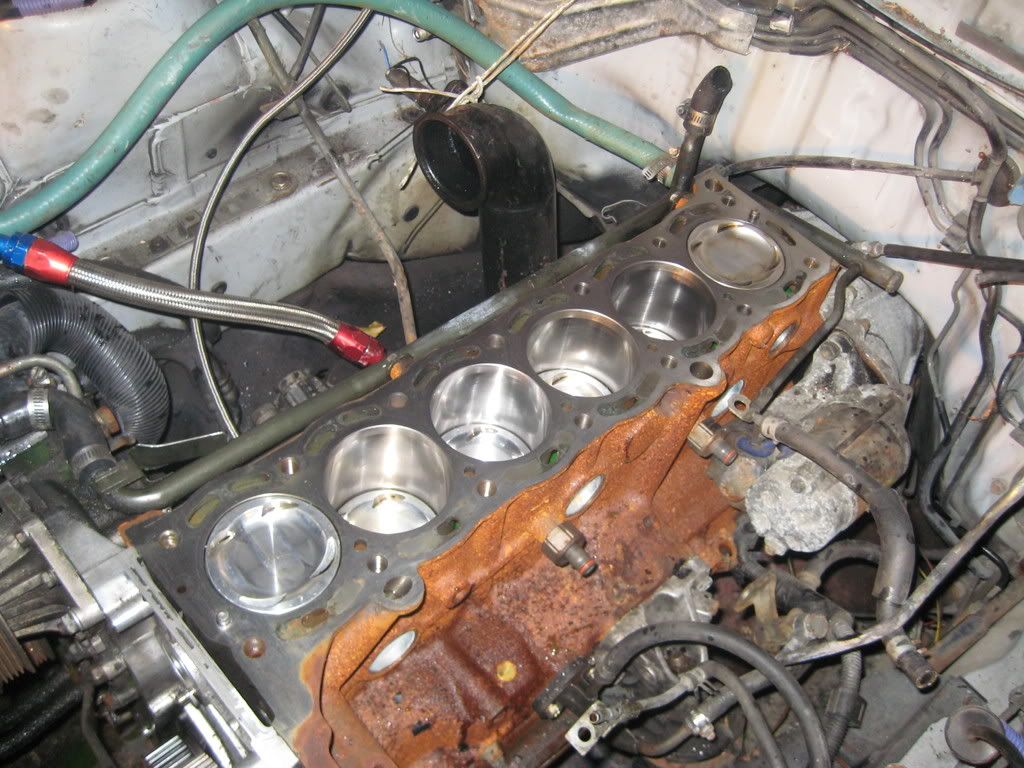

Finally got off my ass and did something with the Silver car....the fate of the red one is still unknown. For those that wont read the entire thread, the car came with a mildly built motor and upon further review has poor compression in 1 cylinder. 8 mos after the test was conducted, I finally got the head off to see what the problem could be.
The head is going in to get checked out but I have another one ready to go on if this one is bad. It also appeared like the metal hg might have given way on the cylinder in question. So progress has been made.
Then we had a meal with some fine gents.

suprastanger507mgte
2x88+2x89+1x91+2x92=ME
3,148
Hayward , Ca
looks like that engine was built as you mentioned. Hopefully its something minor. How about the rings??
I take it that you will be taking the time to paint the block? That rust is ugly.
2turboZ
May 4, 2007
73
Buffalo NY
yeah the rust is ugly....but its also boat anchor sleeper lol. I was looking at painting it....i will have to see how easy it cleans up with a wire brush and wheel.
The oddest part is that there is a small amt. of play in the pistons when they are at the top of the cylinder. However only 1 cylinder was low on compression and they all seem to be about equal in that regard. So I dont know. Hopefully something comes back with the head. The HG had some minor blow out on it but I dont know about 80 pts low blow out.
I am honestly nervous about the whole thing. Just really hoping the cylinder head shop says something in that cylinder was bad because the 3rd is visibly different on the intake/exhaust sides of the head (oil, carbon deposit)
