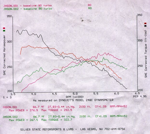

You can see clearly where timing is being pulled due to detonation on my old Mk3 dyno years ago at SILV '00 here --->LINK One run was at 12psi, second run at 15psi saw considerable detonation (back when I didn't know what that sound was) and timing retard.
Too bad that old chart doesn't have A/F's, would be nice to go back and piece together what was happening more clearly.
