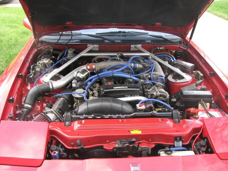

Hi everyone,
I'm in the process of trying to acquire Craig’s 2zj swap '89 supra.
http://www.supramania.com/forums/showthread.php?t=69381
As it looks now I'm going to have to find a way to ship it to me, or find someone with a trailer and trailer it back to Dallas.
As some of you may have know, Craig did this swap and then took a job in Dubai. He isn't able to do anymore work on the car, and as far as I know from talking with him the swap is pretty much done, and the car is running pretty good. It just needs a tune (maf T pro). There is one problem we have run into though.
Basically, the car slowly overheats at highway speed/cruising. I was told that tooling around under 45-50mph, everything seems to run normal, however once you hit the freeway and stay at a sustained speed the needle slowly climbs. So driving back from Houston isn't an option.
Currently it is running the stock radiator (7M), and Craig believes all it needs is an aftermarket radiator to keep the temps normalized. Unfortunately he has left for Dubai now, so I'm stuck trying to figure out what to do.
Does anyone have experience with this swap, and does a simple radiator seem like the easy fix. It looks like a great deal, and this will be my first MKIII, so I'm very excited about the work already done. :) But also am a little nervous trucking the car back here not knowing exactly what I'm getting into. lol. :1zhelp:
Any advice or ideas are welcomed please.
Thanks in advance!
Billy

From the looks of it, it does not have a fan shroud. Id probably try to address that situation first as a fan shroud is needed for the cooling system to work properly. Or you could try your luck with some e-fans.
