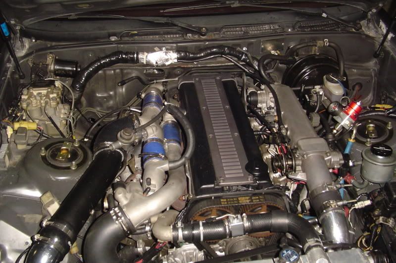

I had 2JZ twins on my 1J prior to the single setup and it is a totally custom setup. I was using two front USDM turbos with the rear one having the WG arm cut and re-welded. To make them fit on the 1JZ manifolds is easy, just have to drill a hole in the turbo flange for one of the studs on the 1J mani. But a custom Y-pipe and D/P depending on how you make your Y-pipe will be required. You also need all of the piping for the 2JZ twins.
That's all I can remember right now, it was a cool setup and would like to do it again on another car sometime. Really throws people off when you open the hood...
Some pics...
1JZ twins...
2JZ twins...
