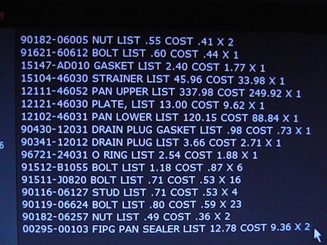

crazysupra2JZ
Nov 16, 2006
740
Georgia
everything you need to convert the oil pan
