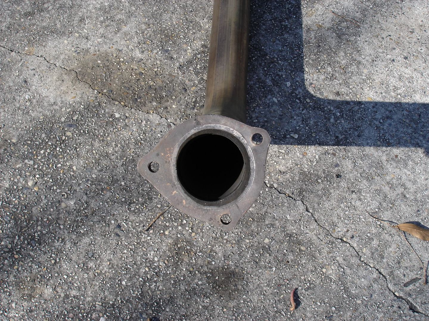

so thats what the flange looks like that bolts up to my aristo twins???

That is the downpipe, the y pipe is between the turbos.
The flanges are close, but still far enough off to piss you off. It would be best to go custom.
NO.
