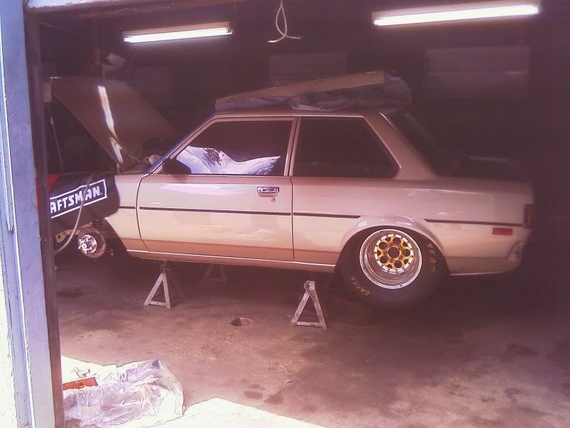

Well its not a supra but i think a few of you guys and gals might like it. My friend and I have a small part-time performance shop and this is the shop car. The owner is my friends dad. Its a win win situation he buys the parts we build the car and we all have fun. Last year with a similar set up the cars best was a 8.9? @163mph. So we decided to go a little faster. So pop decided to go all out and this time I will document it for you guy to enjoy.
well first thing first. This is the car we call it ''El Viejo'' that spanish for the old one.

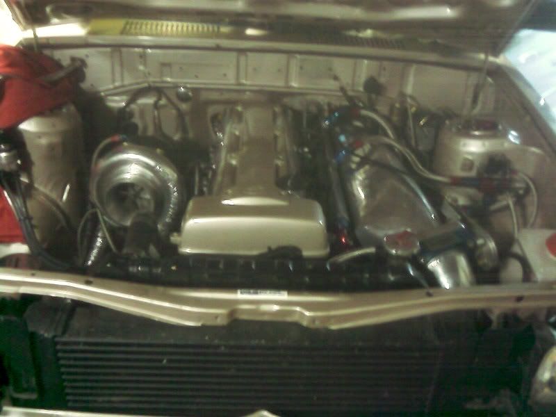

The short block is an SP 3.2L
sitting in engine bay
fuel pumps
intake manifold.
turbo manifold.
Almost thier
New Turbo BB.

perfect man. That engine sits there like it belonged from the start lol. How much fab work was needed to get the engine to sit in there? More shots inside the engine bay would be great.

thanks alot. I will have more pic up soon and some nubers by next week
suprastanger507mgte;1090619 said:
perfect man. How much fab work was needed to get the engine to sit in there?
Moe
The fire wall was modify to fit the GM trans.

minor transmission tunnel mods lol :) What about motor mounts? I remember seeing someone on toyota3tc.com saying a 1jz came close to bolting up to the stock engine mount tabs on the subframe.

yes it does.But since this is an all drag car we use custom solid motor mounts. I will try to get some pic of it tomorrow.
plus is nice to get to the trans without a firewall in the way.

Where in mass are you located, that looks like one hell of a drag car and I would love to see it closer up and help if you need anything.

L O L
Modified firewall and tunnel... more like NOTHING LEFT :rofl:
As long as you have traction, that's going to be one hell of a ride...
