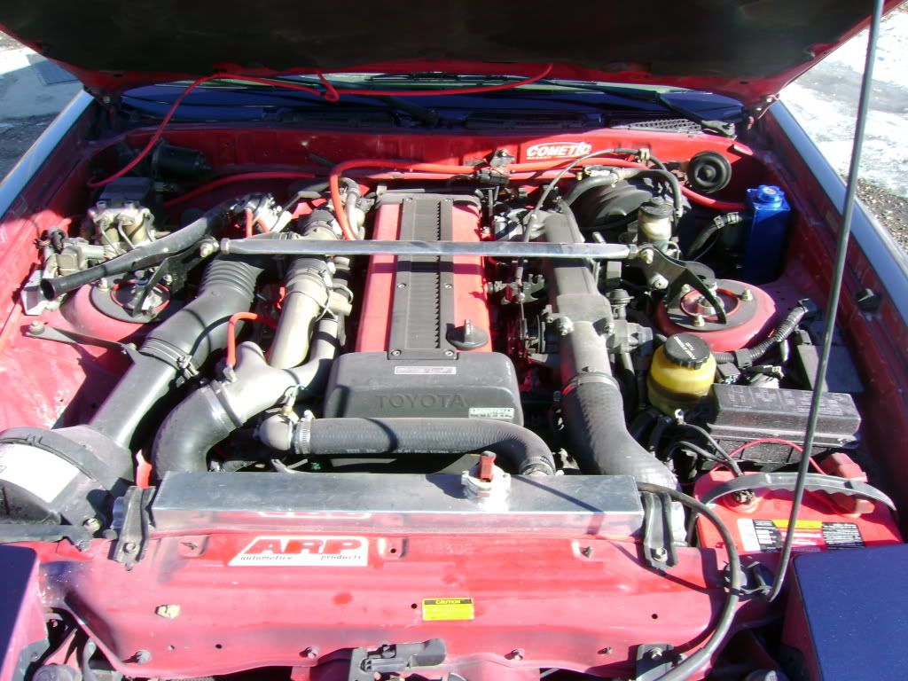

6,618
This is about the only picture I have showing my setup... It's not terribly far from the 7m design.
