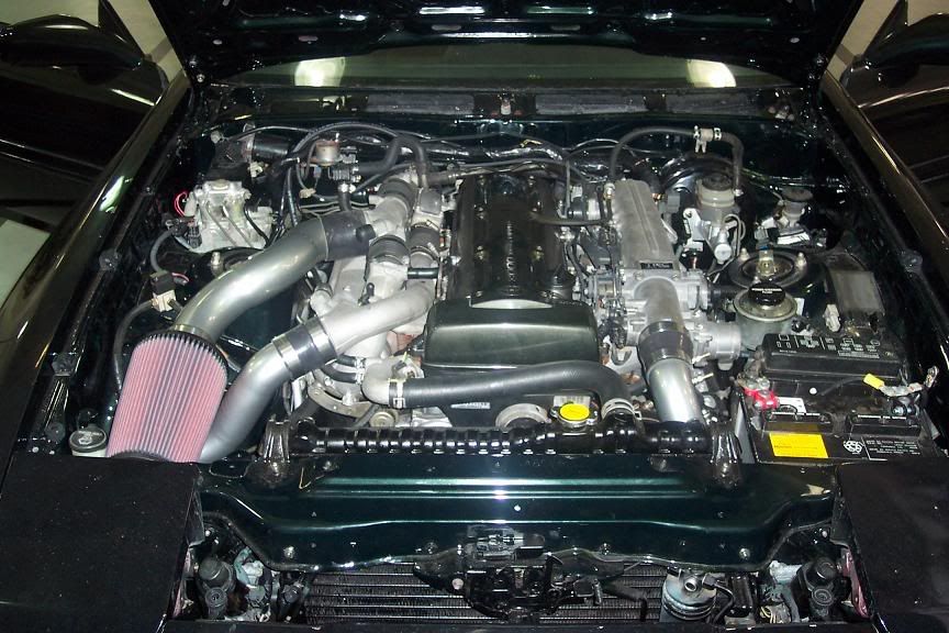

you have to tap in the firewall a little bit.. its not that big of a deal.. I just bent up the abs lines
heres what I did.. and I did it after the paint.. only a minor crack in it ::doh::
fit fine

I've sold the car, so cant get any more pics.. but I just bent them up like 3-4 inches and removed the bolt holding them (threaded hole you see in the pic)
