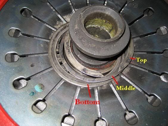

My understanding is to fasten these rings around this circular thingy that makes it a "pull type" clutch. I think I put all three of these rings overlapping on the side of the pressure plate shown in the picture. Or do I put 1 of the 3 rings on the other side of the pressure plate? Do I have this snap ring order correct?

getting the assembly right is CRITICAL, as if you don't it will spin the snap ring, machining the lip off the hub and then you have nothing pulling on the PP...
inspect the hub for wear (post pics, I can tell you easily), and I would recomend buying a new throwout bearing, and all the washers, shims, and snap rings brand new from toyota. The assembly is VERY tight when assembled right, and makes installing the PP on the flywheel a piece of cake.

Thanks poodles. So far, the following are new (not pictured):
pilot bearing
throw out bushing
Southbend 6 puck sprung clutch disc stage 5+
Southbend 2500lb pressure plate
If these rings you refer to as "washers & shims" are cheap, I will try my local dealership for them. cheers.

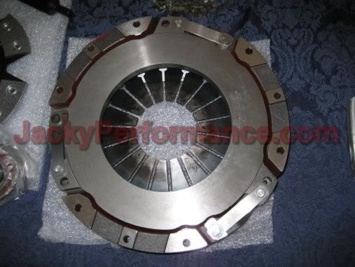

That was one thing I made Southbend confirm over the phone and email; i.e. their pressure plate springs are upgraded to handle 2500lb of force...apparently the stock pressure plate is at 1,800lb rating. So, it's a toyota oem (aisin) pressure plate with upgraded spring diaphragm as far as I understand it.

Make sure you use all new Toyota Snap rings on your clutch. Sometimes they will fall off and you will have to pull your clutch again.

Aaron, so is Southbend simply "heat treating" the Toyota OEM diaphragm spring to enable it to hold 700 extra pounds of clamping force? Or is it a completely new diaphragm spring for the pressure plate?

It's the stock diaphragm that has been hardened by heat treating it, which increases the clamping force. Nothing wrong with that, the stock pressure plate itself is a good strong design.

snap ring pliers didn't help me since they're the kind that require the snap rings to have small holes in the end so the pliers catch inside. I'm having a hell of a time getting the snap ring on the throw out bushing. I'm afraid to hammer it on there since i don't want to damage the snap ring. What are some proven methods that work for you guys?

Two flat head screwdrivers can get it done. What I have used before was a ring separator, like they make for piston rings. But you still need the press down to snap that ring into the groove once you get it over the edge of the throw out bearing.

use the screwdrivers as the TSRM says!
it's not that hard, it just seems it, keep fighting with it till it's done right (the snapring pliers you need can be found at Sears, but it's recommended NOT to use them as you're opening up the snap ring father than needed (you kind of rotate it around to get it on)
