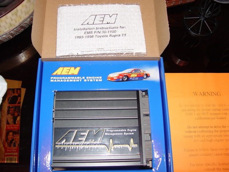

Eh.... AEM is great. Easy to hook up and easy to work with. Don't buy the hype, it's not as hard as you think.
Although, having THIS really helps:
Plug N' Play harness into the Supra. You only have to run 6 individual wires for the injectors to convert it to sequential fire. That's a no-brainer.
- Chris

Chris, Does Richard sell those off the shelf like that now? Last I talked to him, there was more work to be done to convert over to AEM.
AEM IMO is alot harded to tune with then the other systems out there. I played with the interface and its just alot to take in for a newer tuner. There is alot of screens to get lost in and a lengthy config process before you get started.
But it deff has its perks once you get used to it.

30-1100. Supra Turbo box.
Richard sort of makes the harness, but he isn't advertising it. The harness is plug and play now for the exception of the injectors. You have to wire up a resistor pack like you were doing MKIV injectors, and you have to run the 6 injector wires over to the injectors. This is because the AEM runs sequential fire and our engines are configured for batch fire. Beyond the 6 wires, it's a plug and play deal.
As far as tuning, the AEM looks like it is very complex, but honestly they have improved it greatly over the past 4 years. I would recommend it over any other standalone at this point.
- Chris
