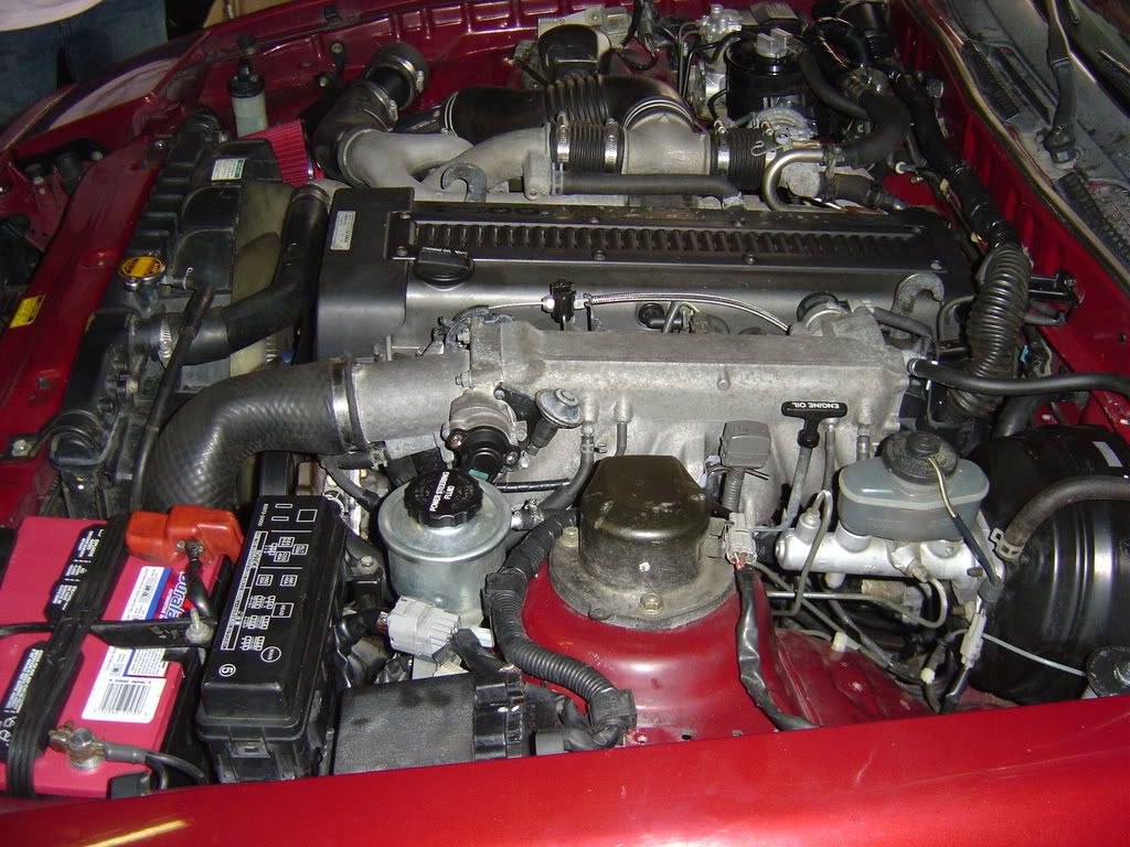

OneJArpus
Jul 1, 2005
2,798
correct me if i'm wrong.
big pics.
VER1
Ver2
there are no real differences i think, just a better design. replace the PCV valve for Ver 1 and be ok.
