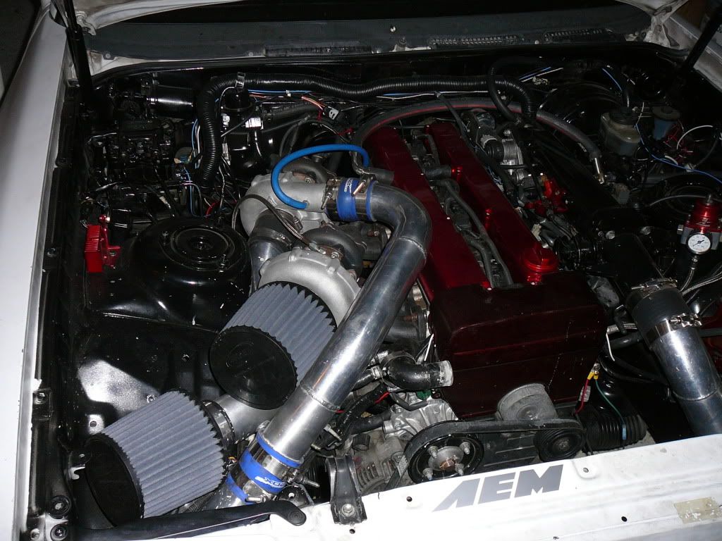

I can give you both sides of what you're asking. I had a custom twin GT28R setup on my car and spent loads of money only to sell it and go single. LOTS of custom parts, lots of rigging to make it all fit together, and lots of pain in the ass. It was fun, EVERYONE was like, "HOLY SHIT" when I popped my hood, but in the end, I didn't build it for bling/wow factor, I built it for a fun street car.
After I sold that I went with a 67 and have been slowly adding to it since then. I haven't even reached anywhere near the potential of the 67 yet (real life and job shit are priorities) but I like it exponentially better than the twins. With that being said, thats just my .02 from what I've DONE (not read online) so take it for what its worth. Feel free to PM if you want anything super specific or need pics, but for the money, I'd just go single.
Bling
Looks stock but waaay faster
What I shoulda done from the get go
