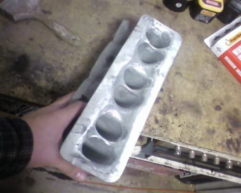

What is your fabrication skill??
can you weld aluminum?
Since I dont have a 7m or 1jz I cant really say for sure.
But if you can weld aluminum I would say to cut the runners off of your 7m and weld a plate onto it so it looks something like this
then you could cut the 1j intake manifold along the bottom in a way that would let you weld it to the above piece.
OR if you can weld aluminum you could just make your own custom one like
I am currently making that FFIM for my 5mgte which NO ONE makes an intake manifold for.
I am much further along than that picture tho.
