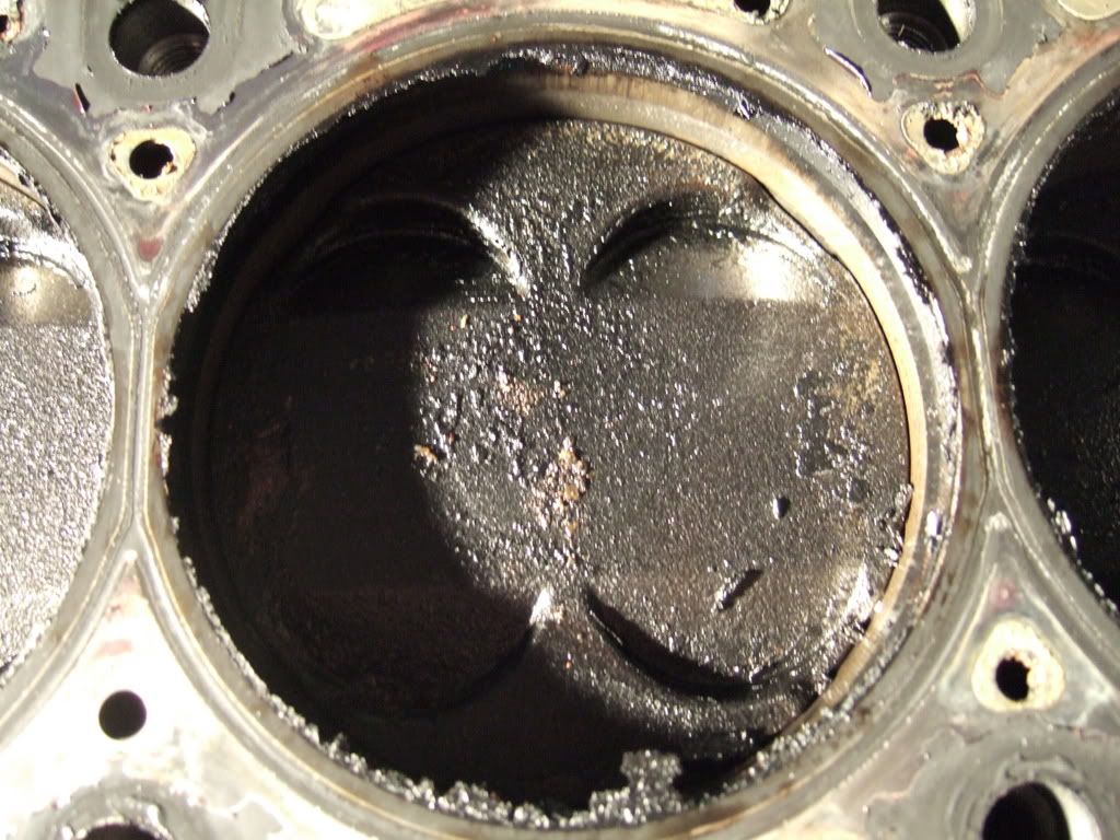

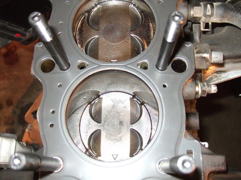

OMG, the crap I found in my cylinders after pulling the head today!!! SO much carbon, I should post pics, but dayum, it's fugly in there! Clean now though....

Nah, couldn't be as bad as mine. My carbon was growing towards the center of the piston, lol.
cleans up nice though.
