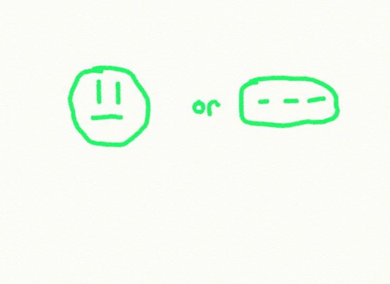

Hey guys,
I got the SC300 alternator and I don't think it's the right one for the Aristo.
Can someone just verify for me which style connector it is for the Aristo 2J . . . may be walk out to the car and check.
Excuse the kindergarten drawing, my digi cam is MIA. On the LEFT is the round style connector from the SC300 alternator. On the right is what I believe is my Aristo harness has .. . I had to dig up/figure out what is was out of my 50 lbs of Aristo harnesses :D I remember have this harness on the motor at some point. I think it wraps around the back of the motor from the fuse box to the alternator.

My aristo harness has the left like my 1j harness.. mine was an ealier aristo, maybe the later years they changed it I guess.. is the right the mkiv?

It seems like hit or miss for sure. I am almost certain that mine is the one on the right. I wish I hadn't given them my stinkin core before I got the new one.
I really hate to go back for a third time. One good thing about autozone is that they have pics of the alternators so this time I will be sure.

I have a 1jz installed into an mx83 cressida and have been having alternator problems. I just checked the plug on my alternator and it appears to be the one drawn on the right; three pins, all flat.
From what i understand, the sc300 uses the one on the left. does this mean the sc300 alternator is not a plug and play unit for me?
