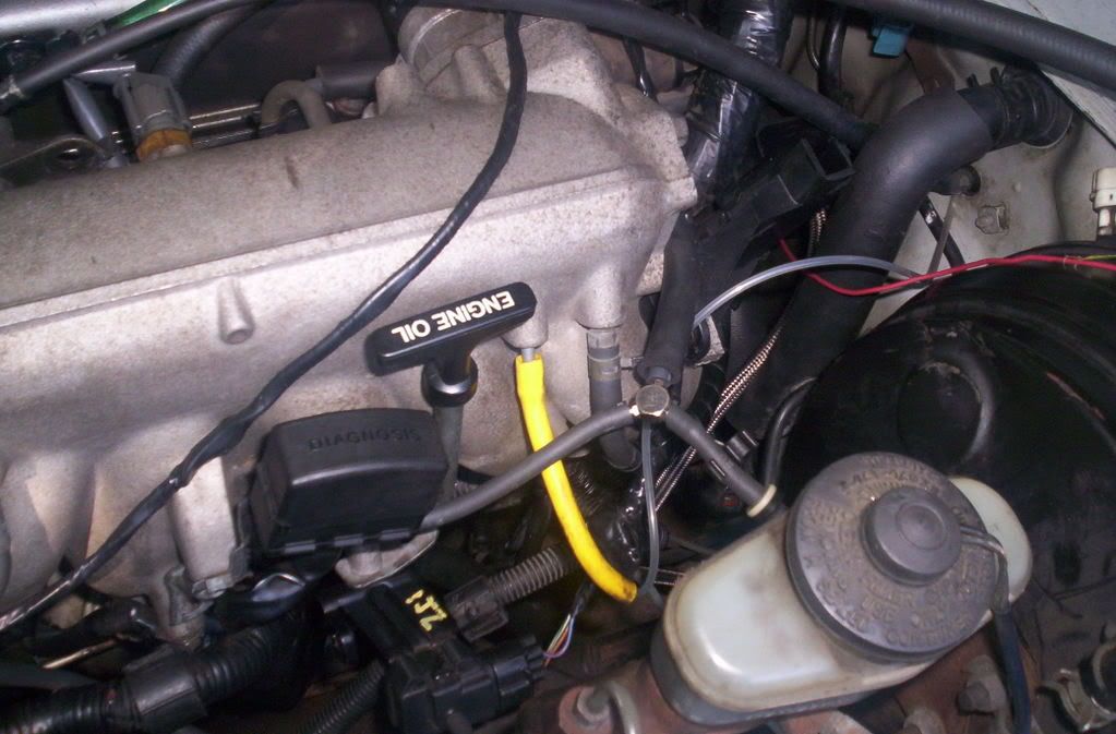

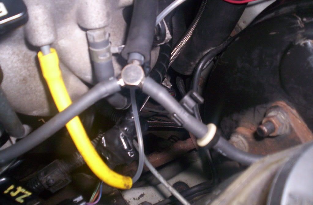

Ok, here's what I got so far. I found two vaccume line off the intake manifold one that goes from between the valve covers and the intake manifold towards the firewall where it T's into this other vaccume line that is from the hard line on the back of the intake manifold. These to lines come together and go straight to this check valve and then to atmosphere. I know that's alot of imagination to put together but I'll throw up a picture shortly. Thanks for your help guys!

Here's the photo's I snapped.

make sure your P/S vsv is hooked up, if you dont have one the vac line from before the TB should be capped off not connected to the rest of the system because it will allow extra air in and cause a higher than normal idle. ive seen it a few times where people just bypass it and connect the vac line from before the TB for the p/s to the one after but its like having a hole in your throttle plate

Very good point! I remember that plastic tip to the p/s line before the throttle body being broke off and unconnected. Will fix that issue. Do the pictures I have posted look correct as to how they are connected?
