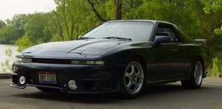

big idealist said:
how much are bilstein struts? i was thinkin bout tokico blues... they are relativly cheap... :D
heres a pic so you can see how they sit:
they are a little bit more than the blues, i believe the bilsteins are around 110 to 120 a piece last time I checked
EDIT: oh, and I have rode H&Rs with the blues before, not too bad of a ride but I still like the bilstiens better
that sux you guys from ohio gotta have a plate in the front....
