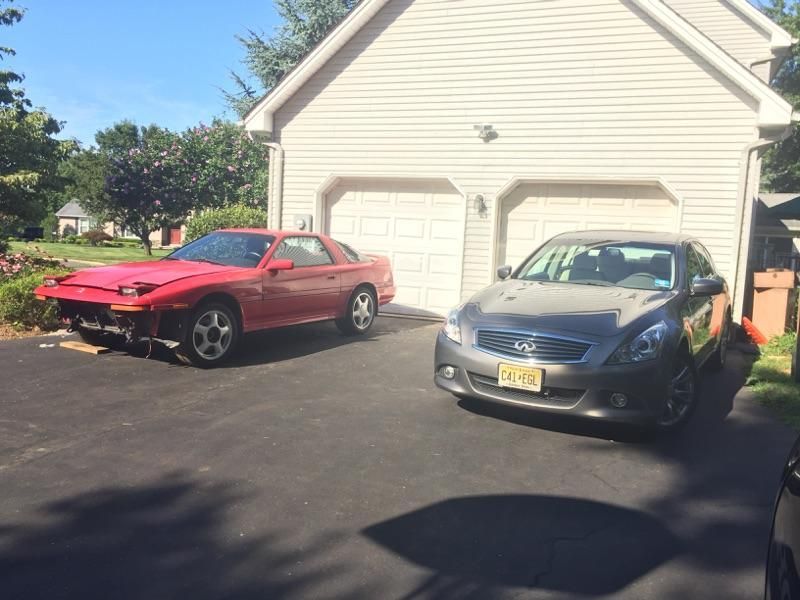

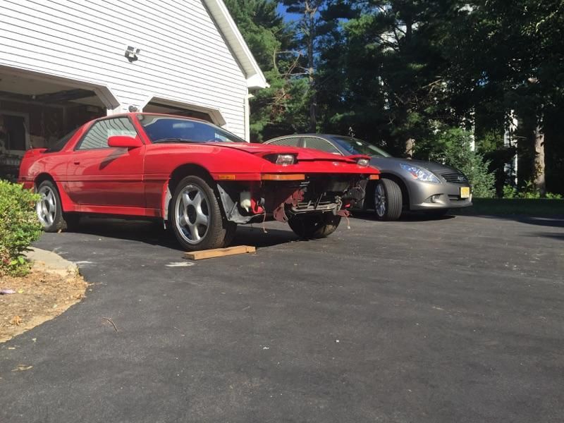

Some more stuff sorted out

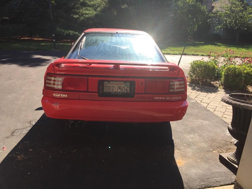

First go the car on all 4's and washed it for the first time in 4 years!

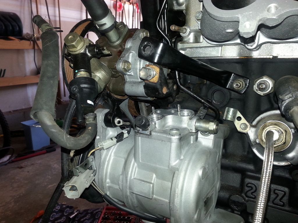

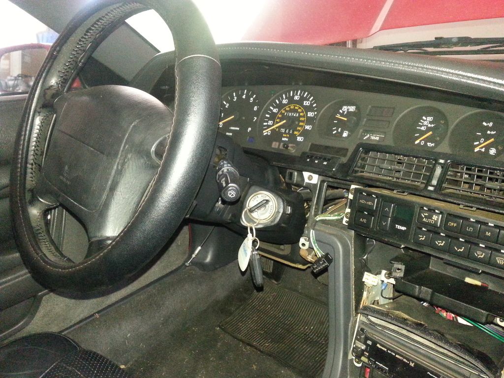

The got A/C sorted out
First the VVTI compressor will not accept the top piece from the from the 7m compressor. So I purchased a USDM 2jzgte A/C compressor from DM.
Next is to mount the compressor.
If you swap the stud from the top position with the bolt from the bottom, you can maintain all the original mouning.
You bolt up the AC Compressor without the top piece on, and just need to clearance a small piece on the top hat to make it fit
The P/S pup bracket will need to be clearanced once the engine is mounted and the A/C lines are bolted up.

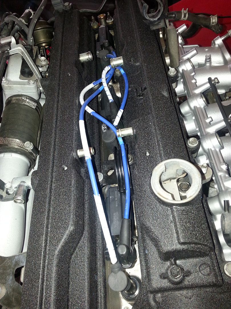

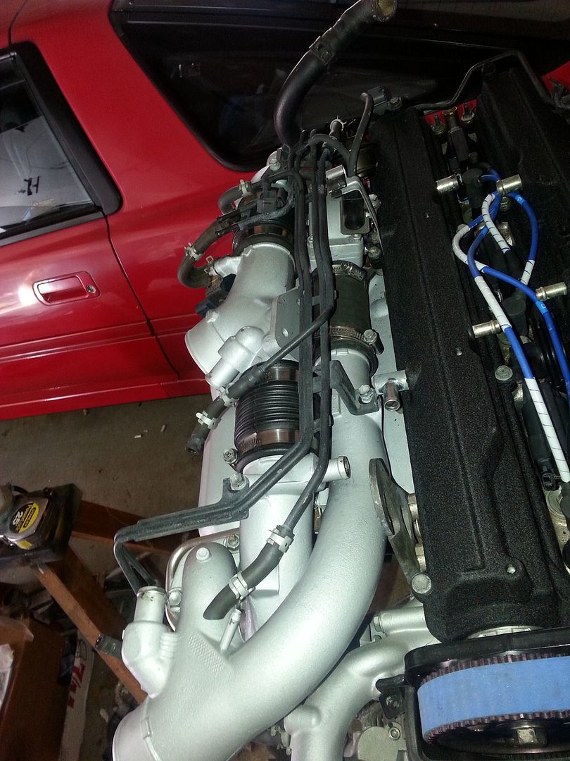

Cleaned the coils, installed plugs coils and wires. Not sure whick plug the coils go on, as there is conflicting information. Currently coils on #2,#4,#6 with leads to 2->5, 4->3,6->1
installed the hard vacume pipes, waiting on the new hoses
