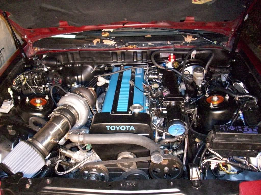

Guys, I used a 2jzge block and drilled all the internal bores out to OEM to use the OEM oil feed locations. Did not drill the squirters out due to not looking for big power.
This is not hard as all the casting marks are on the block and if you have a good machine shop it should no problem. I have 2000 miles on my swap with no issues.
I did not want to cross a line over from the other side of the engine, wanted the stock look.
If you are in Cali, Indio Motor and Machine is familiar with this and I have used them on many builds for 8 years, not just JZ. They charged me about $1100 total, included 0.5mm over bore, balance and blueprinting the crank, bearings, full head job (port and polish done by us), decking block and head, and internal porting. I assembled the motor myself.
Here is my build thread:
http://www.supramania.com/forums/showthread.php?t=106780
Indio Motor and Machine: 760-347-5493

thanks for your input! i did run across your thread while searching for info on this! nice to know it has been done before.. too bad i ain't in cali :( but i suppose any competent machine shop will have the ability to do this. the reason i wanna do this is same as yours and since i will be running 2 turbos that means 2 oil lines running across the engine :( so we will see! again thanks for the input!
